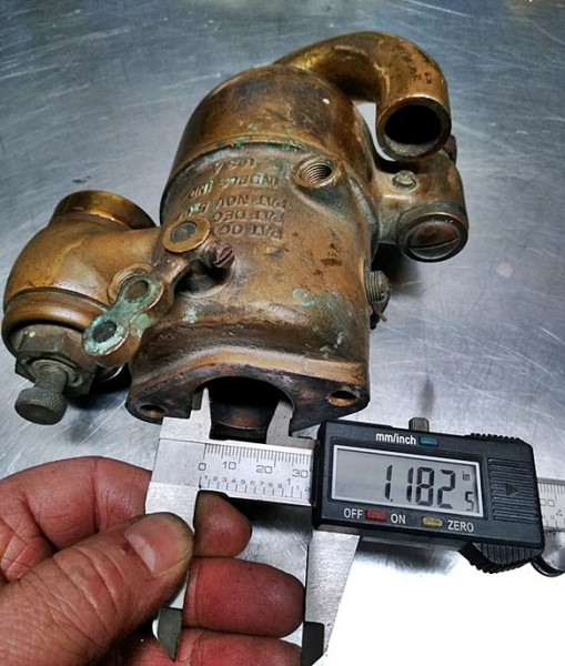

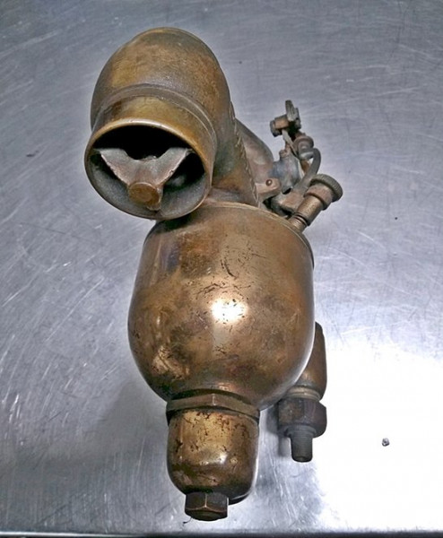

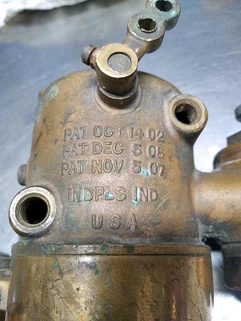

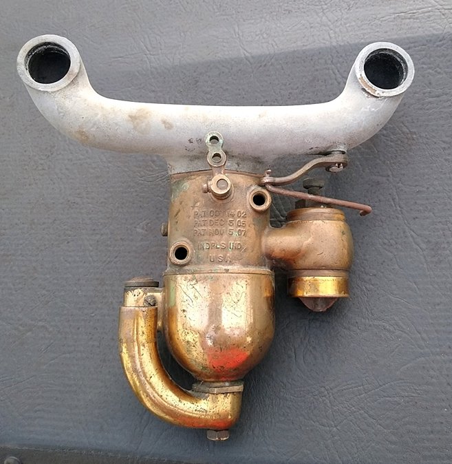

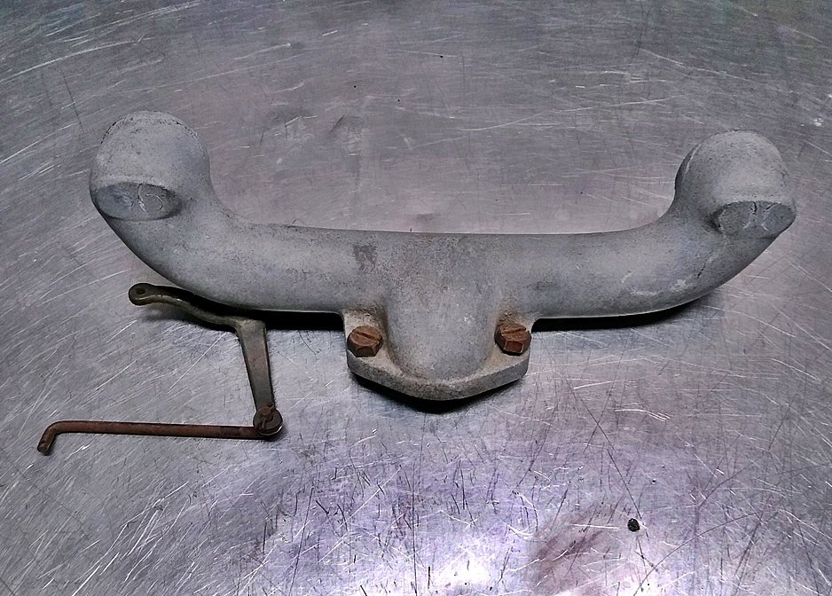

Hoping you knowledgeable folk can help me on a recent purchase. I bought the intake and carb assembly from a fellow recently. I think this is a Model L Schebler carb, with a 1-3/16" bore. I don't know much abought it. Seems like these went on many cars including early Buicks. The intake almost looks specific to the carb, but not sure on that either, there are no markings on it.
What you can you tell me about all of this, and while I am not looking to sell it, can you at least give some approx values?

The intake looks like the one they use for the UJ carb?

I would say that carb is pre T?

I would say you are right about it being a Schebler Model L.
https://i.ebayimg.com/images/g/QCsAAOSw ... -l1600.jpg
This one on ebay looks very much like it to me. It has a $125 starting bid and $165 buy it now price. You can check others on the web for asking prices if you haven't already.

Chad, a quick scan looks like Buick and some others used a Schebler L carburetor around 1913. The air valve carbs can be fussy to get right. A friend has a Schebler S Duplex on his 1929 Kissel, and the carburetor went through four restoration shops before one of them finally realized that the air valve spring was fatigued. Replacing a 25c spring suddenly made an unruly carb behave. For anything specialized like that, I look at ebay sold auctions to get an idea of current market prices. Good luck!

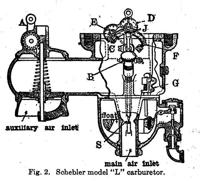

Very interesting mechanism with the way the main jet varies with the opening of the butterfly, never saw it before. I can see how that may be a 'sensitive' thing to adjust properly
