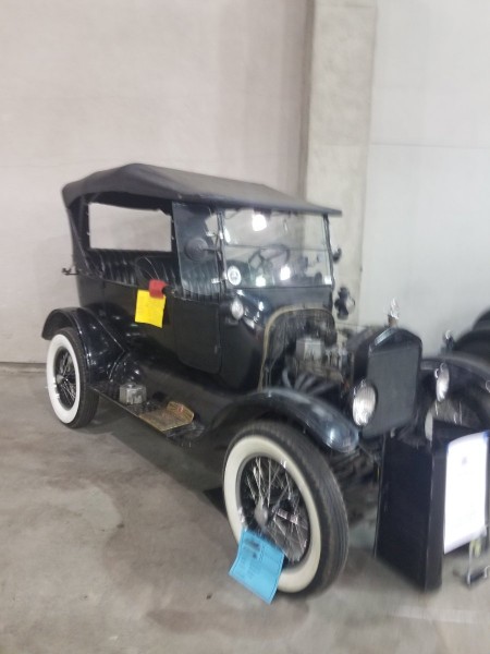

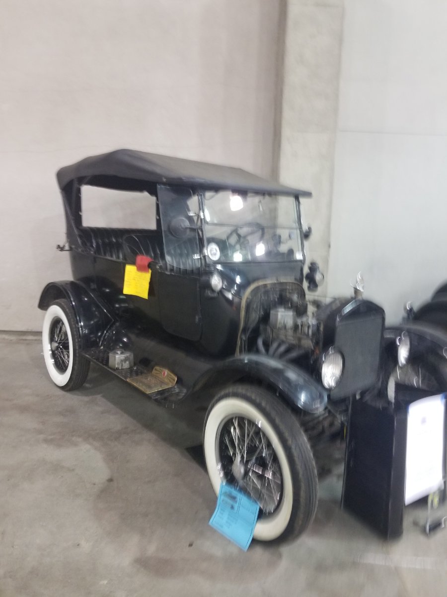

My wheels were powder coated when I got my 26 Roadster 5 years ago. I’ve had no problems and love how easy they are to maintain.

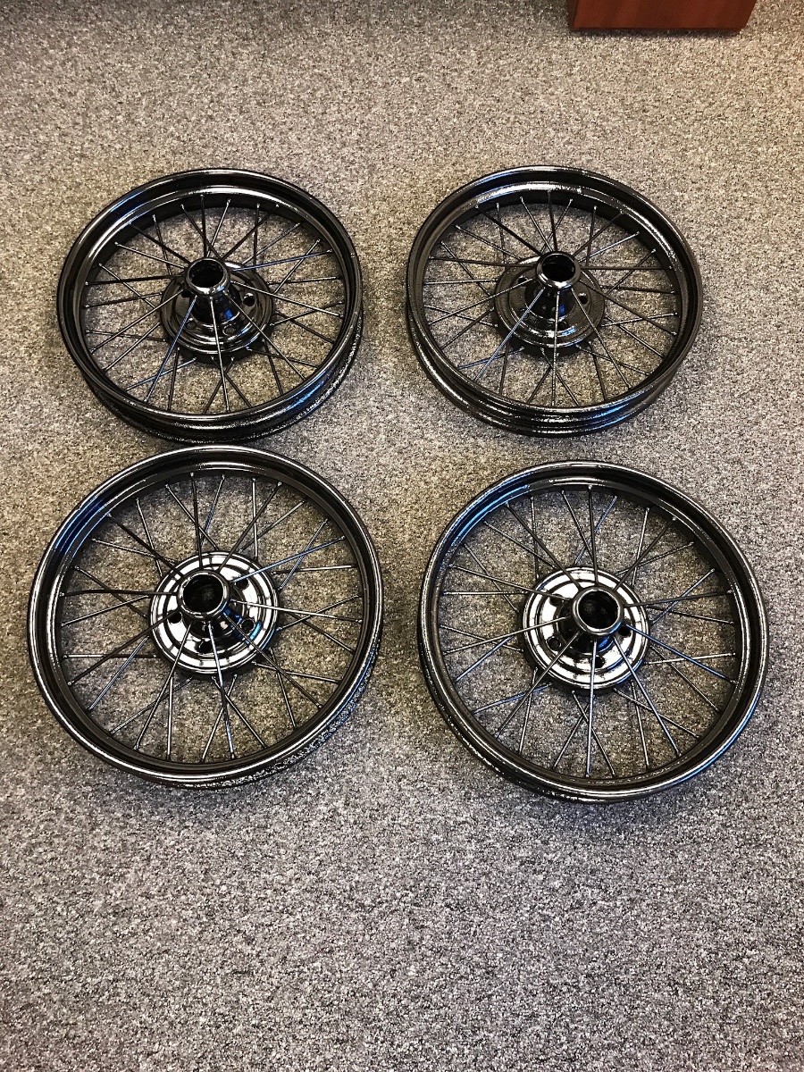

I just had these wheels powder coated. I am very pleased at how they turned out.
It would be difficult to sandblast, prep, and paint the wheels for the price I paid to have them done.
