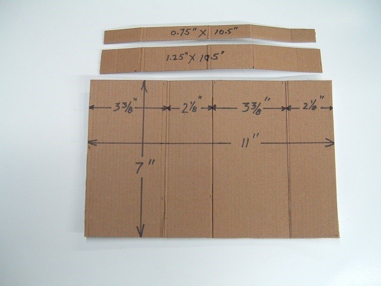

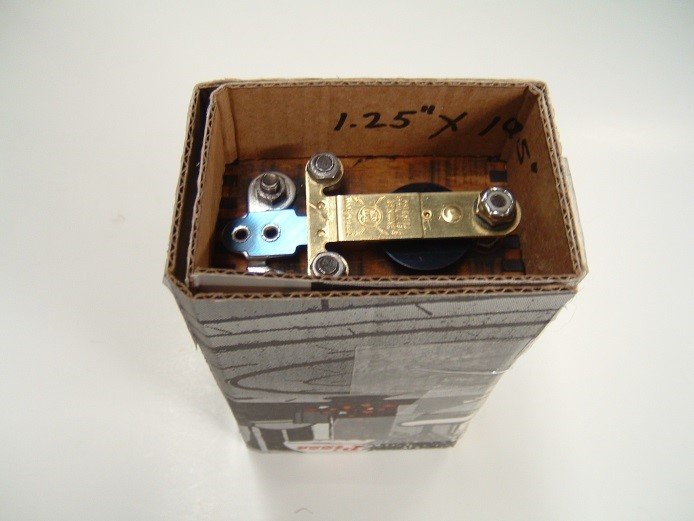

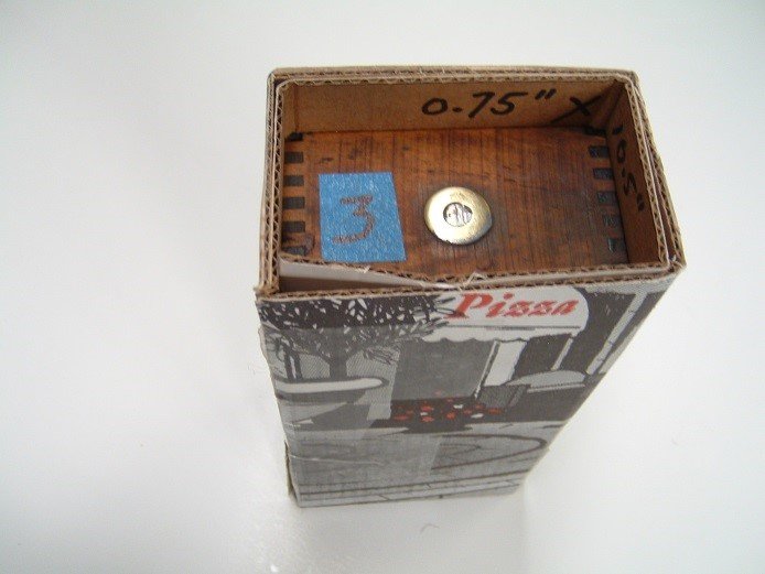

One thing to consider if coil adjusting at Chickasha is successful; be prepared to tightly wrap each coil in a sleeve of cardboard that extends above the coil points to protect them from getting bumped in transit home and observe care during coil box installation or all the effort is for naught.
Coil points are much more vulnerable to misalignment than most folks are aware. Properly adjusted coils must be handled and installed carefully following adjustment.
Here are the dimensions for making the protective cardboard sleeves:
Secure with packing tap on Side, Top and Bottom. Will ensure save for shipping or transport without risk of detuning.
