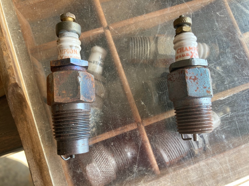

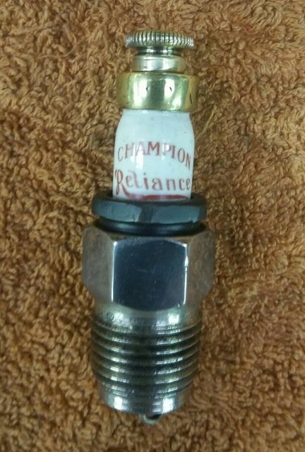

Why do some X plugs have a longer thread reach ?
Are the shorter ones for a low head or does it make a difference ?

Steve Jelf knows more, but something tells me the one on the right may be an original, the left one is
probably a repop that they often refer to as the "brass hat" style. Best guess I can give.

The one on the right is earlier - just after the smooth side X - notice it still has the small threaded shank.

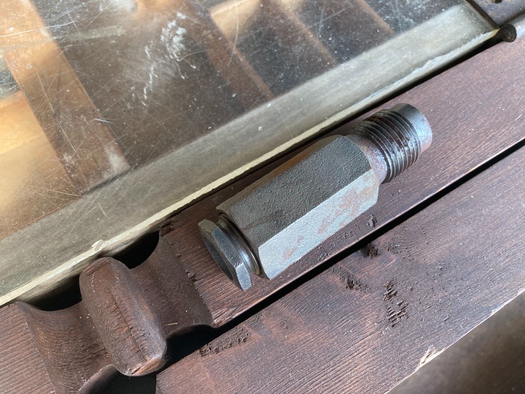

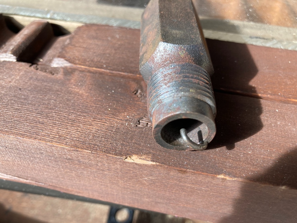

Wayne I will check, seems like I saw a longer reach plug in my stash.
Ruxstel24
Topic author - Posts: 2428
- Last Name: Hanlon
- Location: NE Ohio
Re: Champion X plug differences
Wayne....
I found this, and I have another place to look.
I think I have something similar that’s complete.

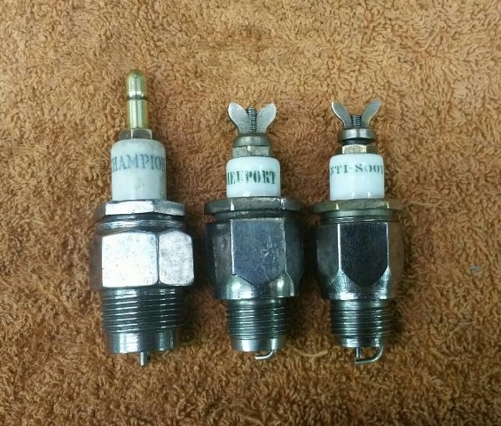

In the photos, which for some reason appear in the opposite order I added them -
Bottom photo - you'll first find an example of three plugs - an early pre-Model T plug with the Champion name on it, a Neiuport spark plug produced by Albert Champion prior to his using the Champion, and another similar plug called an "anti-soot" that I included as an example of how similar plugs with different names existed in the early 1900s.

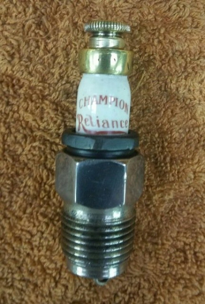

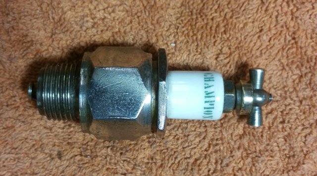

The next photo up shows an example of the earliest style of Champion spark plugs. This is the oldest Champion plug in my collection, and one of the earliest known to exist among collectors.
The next photo up shows a 1916 Champion plug produced briefly following the acquisition of the Jeffrey Dewitt company. It's unknown how long this type of plug remained in production, but it is one of the earliest Champion spark plugs to use the "brass hat" style.

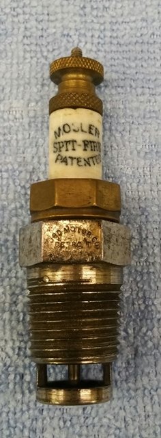

The top photo is an early Mosler spark plug as supplied to the Ford Motor Company prior to the use of the Champion X plugs. Note it is marked "Ford Motor Company" stamped in the body of the plug itself. I do not know exactly when this plug was used but it may have been prior to the Model T.

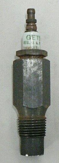

Oops forgot to address Ruxstel24's post about his long-bodied spark plug. I'm 99.9% sure its a plug called "Gets."
Terry
