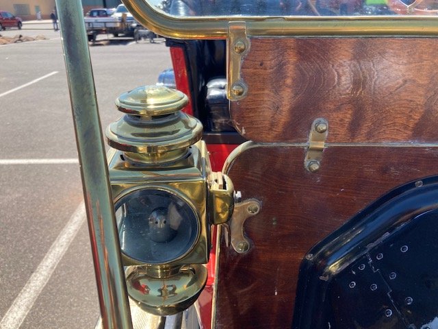

All That Brass!
Post by ivaldes1 » Mon Mar 22, 2021 5:37 pm
At Chickasha I made several brass acquisitions for Hay Wagon to speedster project. These are pictures of the very brass T at Chickasha. That is a lot of brass. So how does one keep all that brass shiny? Does it tarnish? How do you get into the tight spaces to keep it shining? How often does re-polishing have to be done?

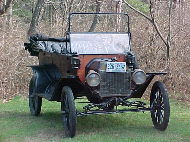

Post by BHarper » Mon Apr 26, 2021 1:27 am
I applaud all of you who invest hours of effort polishing all of that brass, producing sore muscles, cramped hands, and brilliant, glittering, spellbinding radiators, lamps, and all.
I just don't have the time.
As found.
After washing off the dust and pigeon poop.
