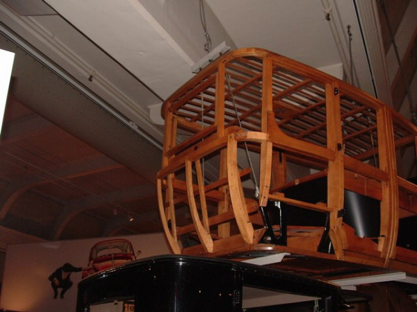

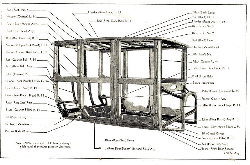

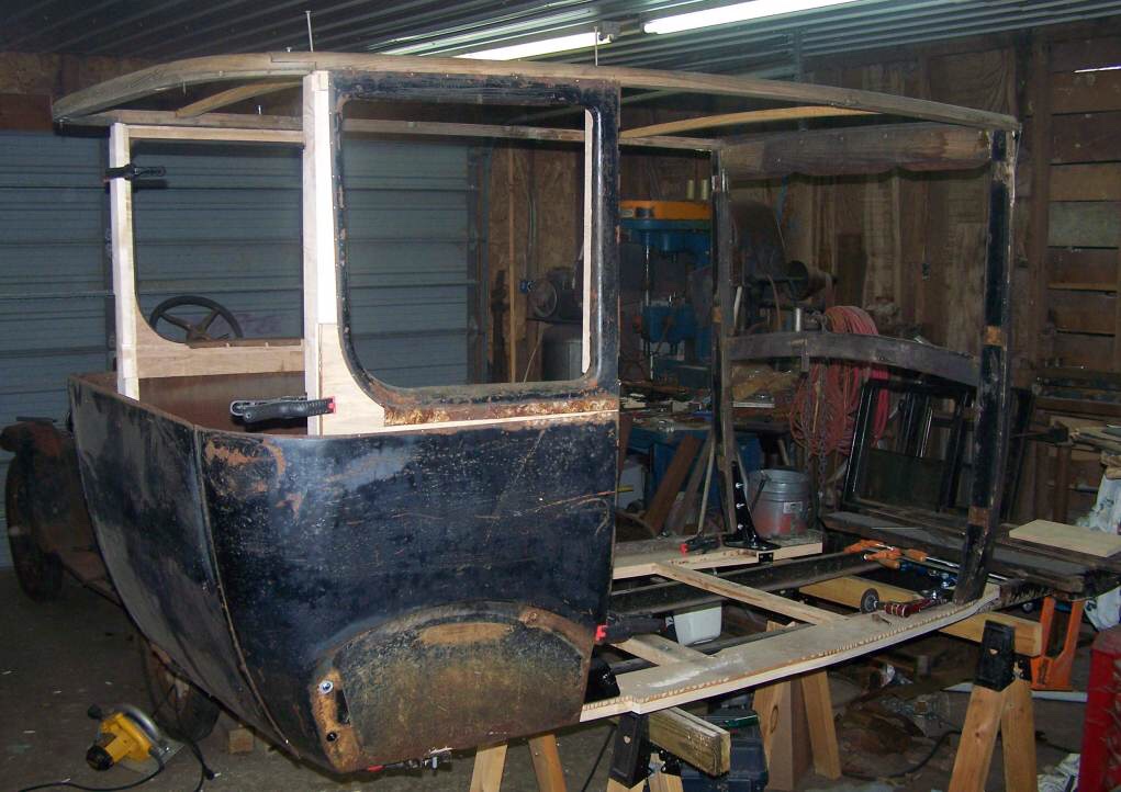

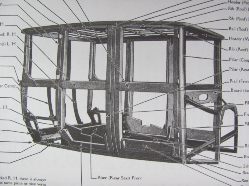

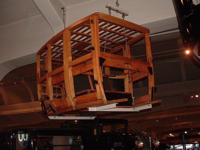

In answer to your question, the following photos and diagram might help...Jim Patrick

The pictures that Jim posted are the same ones I have so I'm no help there.
