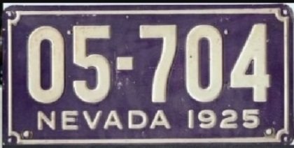

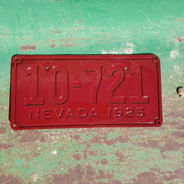

I have the background paint on my plate. What is the best way to paint depressed letters? They will be white.

I know the photo is a tricky one but the letters and numbers are depressed.

I would spray paint the whole thing white, then apply red to the flat part with a foam roller. The red should be thick enough to stay in place and not run.

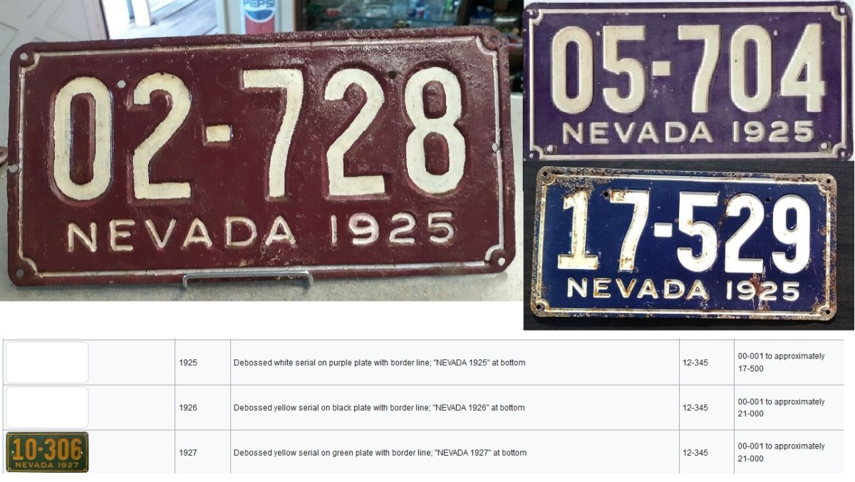

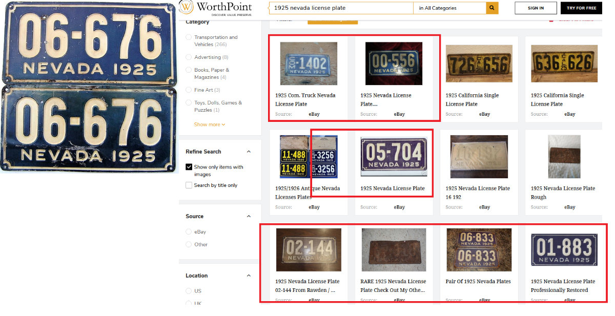

I wondered what the depressed lettering was (referred to as debossed) so I did some google searching. The first plate was redish brown, obviously a restoration attempt, was similar to several other "restorations". The purple/blue plates were from auction sites. The color was also confirmed from https://en.wikipedia.org/wiki/Vehicle_r ... _of_Nevada.
You best decide the color of your plate.
The pictures of the purple plates show the the edges/sides of the debossed lettering was painted up to the flat. You could paint the hole thing white and the fill in the debossed letters and border with clay and then role the final color
The following purple color is what I would use as Gospel to be authentic
https://www.worthpoint.com/inventory/se ... ategories=

So embossed and debossed ! Also looks like I need to adjust the color. Doing the white first and then rolling on the color or filling in with clay sounds doable. Thanks.

Wrong color
Dark purple with off white letters
State archives might be able locate who and what car this plate was on
