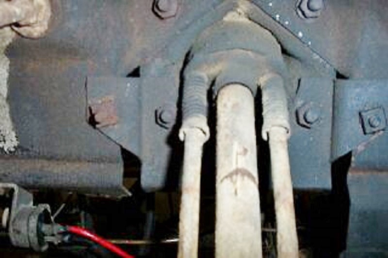

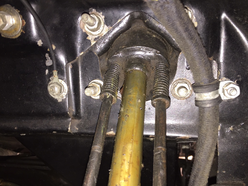

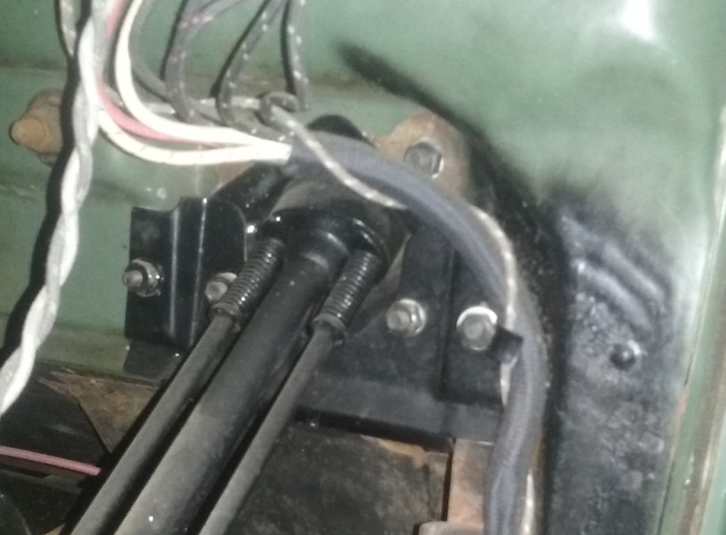

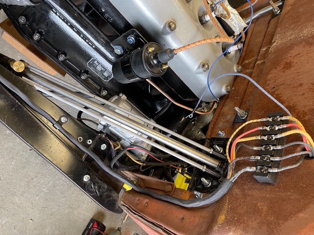

On the 26/27 coupe, roadster, touring, and tudor, which side of the firewall should the steering column flange mount ? I've looked over quite a few pics on the net and it seems both ways are quite common. I believe on the pre 26 models they all mounted to the inside (passenger side) of the firewall.

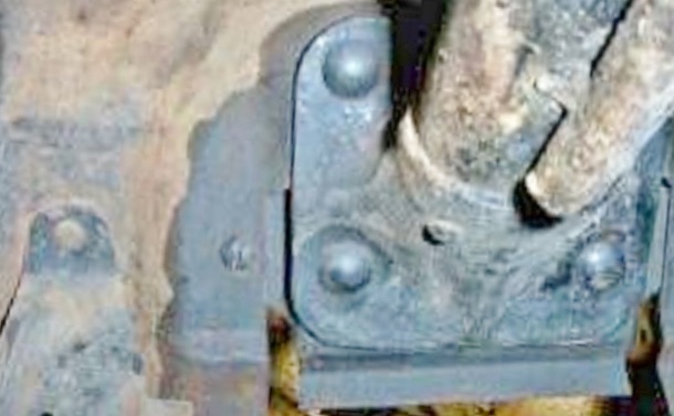

I'm thinking the 26/27 also mounts on the inside. As a side note, I've found earlier threads showing two styles of the bottom bracket. They are mounted on the outside (engine side) of the firewall.
Thanks, Bill

RE; I'm thinking the 26/27 also mounts on the inside. As a side note, I've found earlier threads showing two styles of the bottom bracket. They are mounted on the outside (engine side) of the firewall.
Correct, column on the inside bracket on the outside.

Looking closely at the photos it looks lik there is a bracket on both sides of the firewall.

Bill, 26-27 steering column flange is square, mounts to the inside of the firewall. The spacer bracket mounts on the outside of the firewall. There is also a picture in the Ford Service Manual Fig 563, not very clear in the new reprint manuals but does show up clearly in the original hard cover manual.

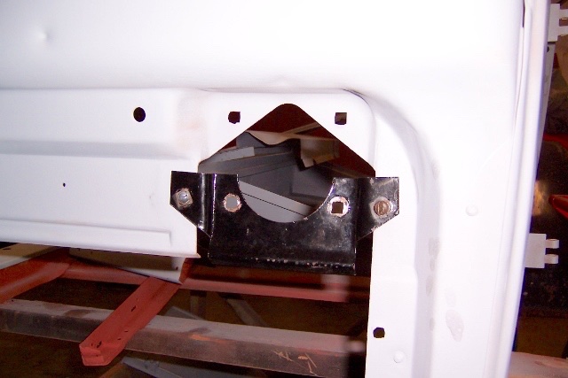

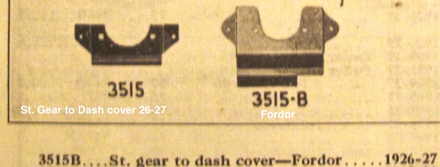

- Posts: 4109
Re: 26 Roadster Steering column
And...two styles of the steering gear to dash covers for '26-'27, the Fordor is unique.
The steering column mounts inside. The dash cover mounts outside the dash/firewall, that way the 2 upper holes in the steering column square flange line-up to the dash cover, that provides the lower 2 holes for the steering column square flange. And the dash cover lower edge holds the floorboard.

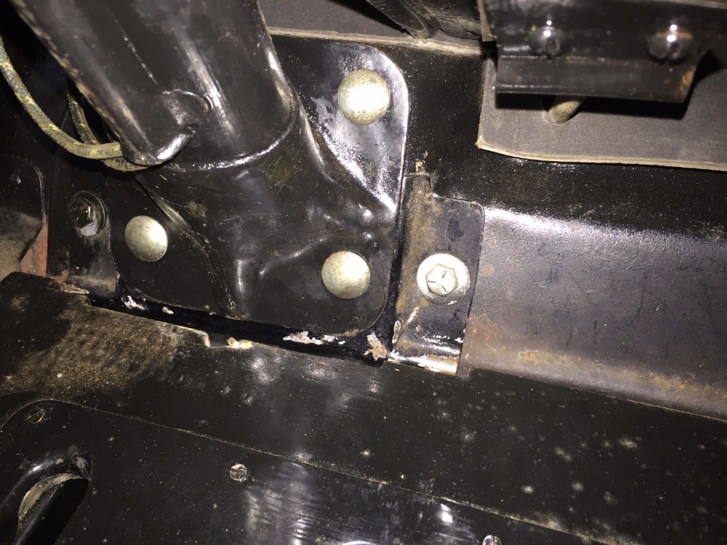

Mine is square and I just finished installing it for the third time
I had mine on the outside and things didn’t go right with the bracket on the lower two holes. So I pull it out and get it all in there nice and pretty like. I was proud of myself until I tried to bolt the dash in place. What was in my way but the steering column. I am good at it now if you need a hand.
