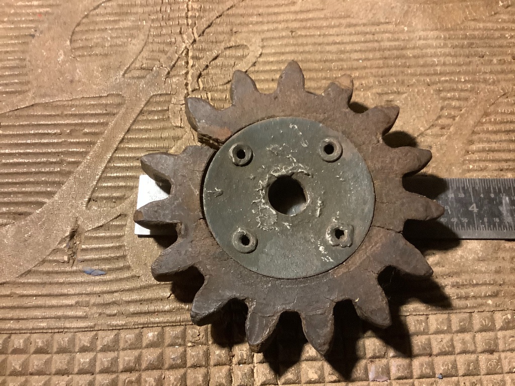

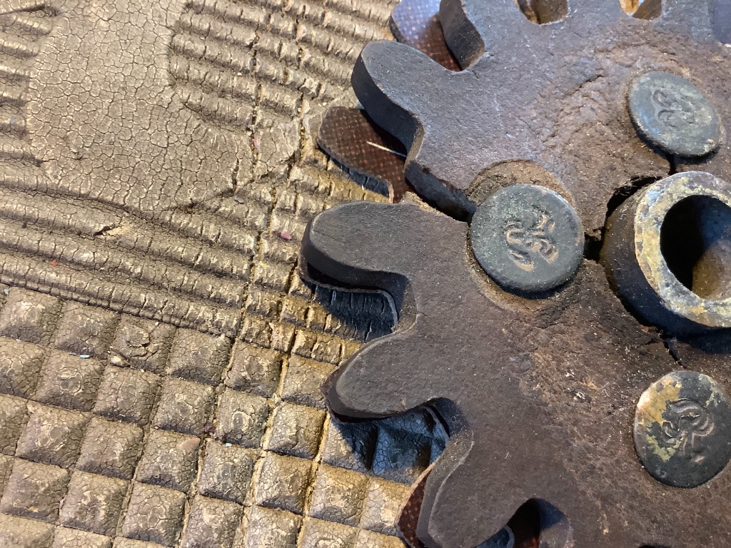

This is the type of gear that can easily be made with a bandsaw and a good file. Here is an original. I may have enough red fiber if you want to do it yourself, otherwise Glen may have them on the shelf.

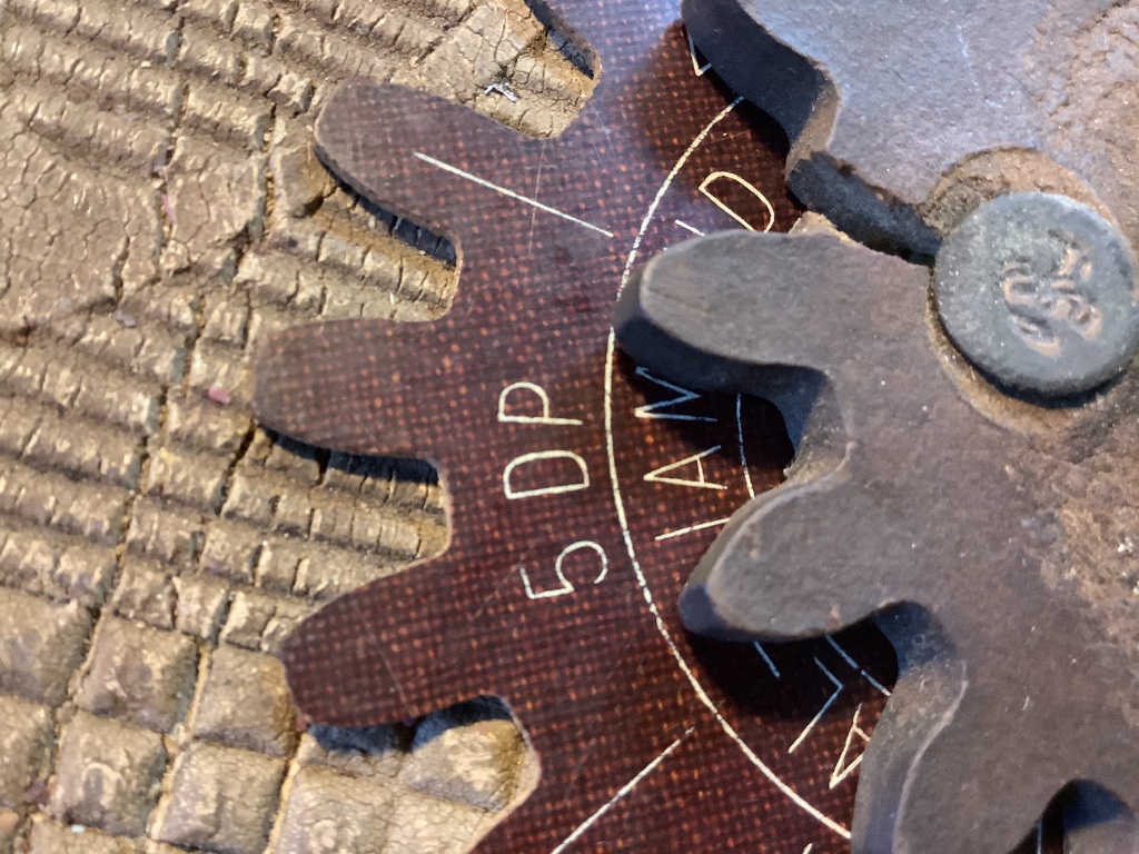

And, the vital stats are 15 tooth, 5 D.P., 14 1/2degree pressure angle

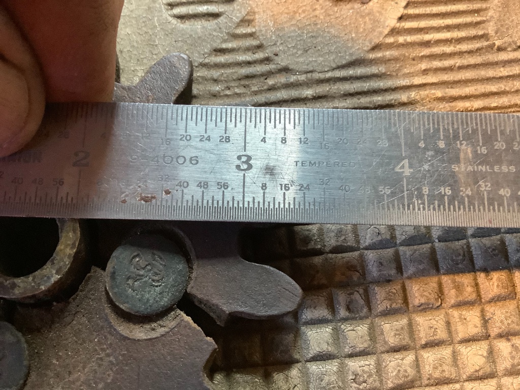

Tim- the OD looks large- most likely a long addendum gear as there is no undercut. Can you confirm OD?

Dan, a close guess to overall outside diameter would be 3 3/8”. The split would give me a bit of pause, but it’s measured across the good part of the gear. Other than the tip wear, the profile shows 5DP. Be glad to hear your thoughts. Jonah, It’s easy to overthink some of this. It was pretty crude originally and worked well, sometimes for well over 100 years.

Tim- thanks for the measurement- appears to be just a vanilla 15 tooth 5 DP gear.
