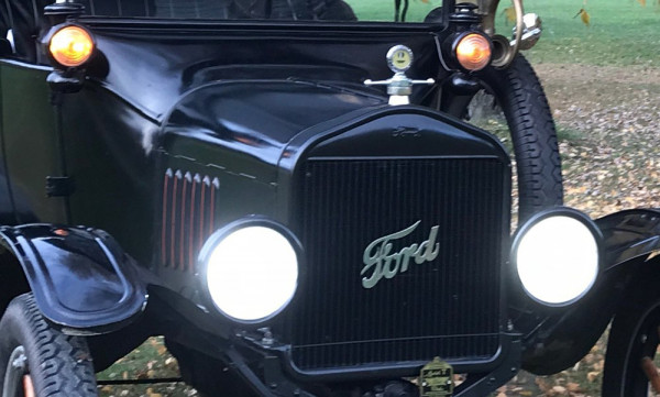

I modified the oil lamps on my 1917 with LED bulbs, headlights too. I have a brake switch that came with my disc brakes and the single rear LED serves as a service and brake light as well as illuminates the license plate. The Tail light is 1157-R19W6 (two brightness red & white side-Dual Function 25 LED.) Sidelights are 67-A15 (amber) while the headlight LEDs were given me by a friend and there is no number on them that I can share with you. My friend soldered brass washers around the single terminal on the bulbs so they would contact both terminals on the bulb socket.
