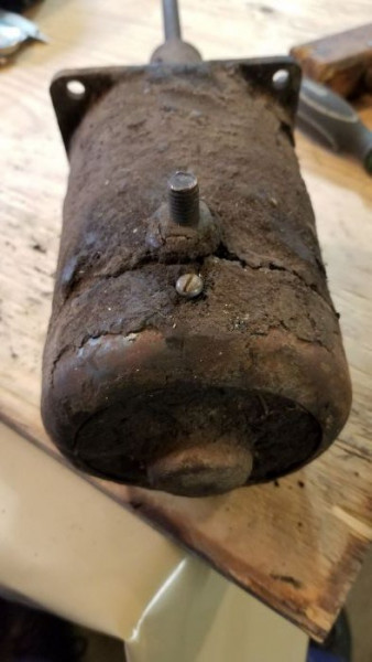

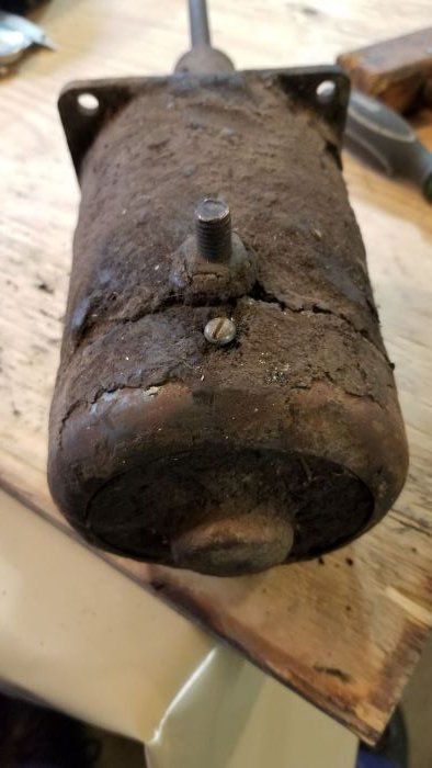

This is the starter. it has a one screw cover.

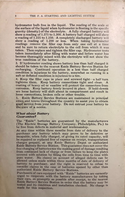

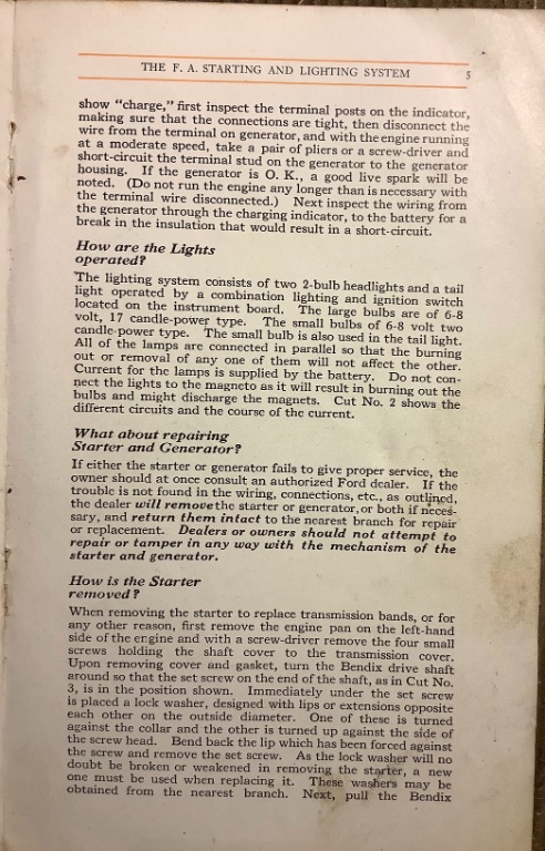

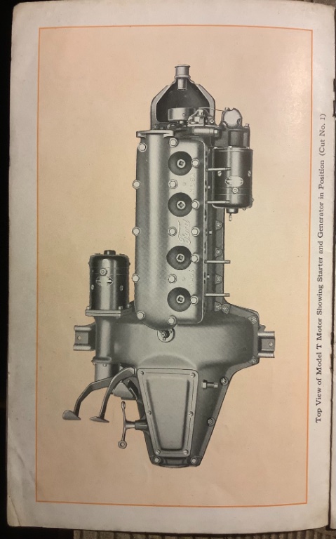

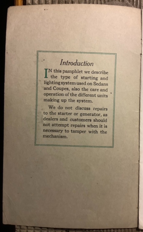

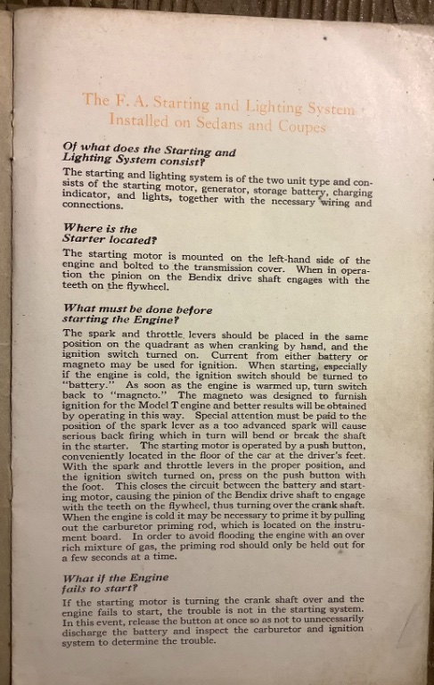

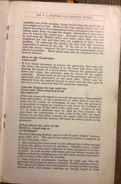

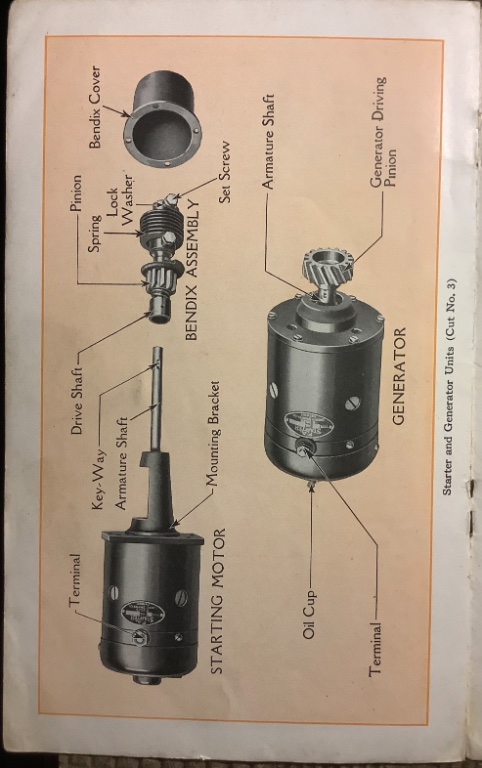

That publication about the FA Starting and Lighting System has photos of the Liberty Electric manufactured Model T Ford generator and starter showing the early features discussed.
My copy was donated to the Bruce McCalley Memorial Library and Research Center. Perhaps you can get Tim Morsher to scan a copy and post it here?
Ron Patterson

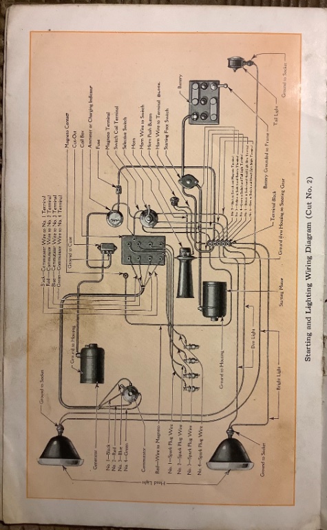

The FA System pamphlet depicts several interesting things.
Both the starter and generator have Liberty Electric data plates.
The cutout shown in the wiring diagram would have been mounted on the firewall with a ground wire.
The generator does not as yet have a oil slinger.
The charge indicator in the wiring diagram is shown as an ammeter OR indicator.
There is another non Ford book at the McCalley Library showing the other unique Liberty Electric internal manufacturing features.
Ron Patterson
