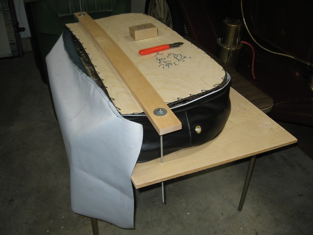

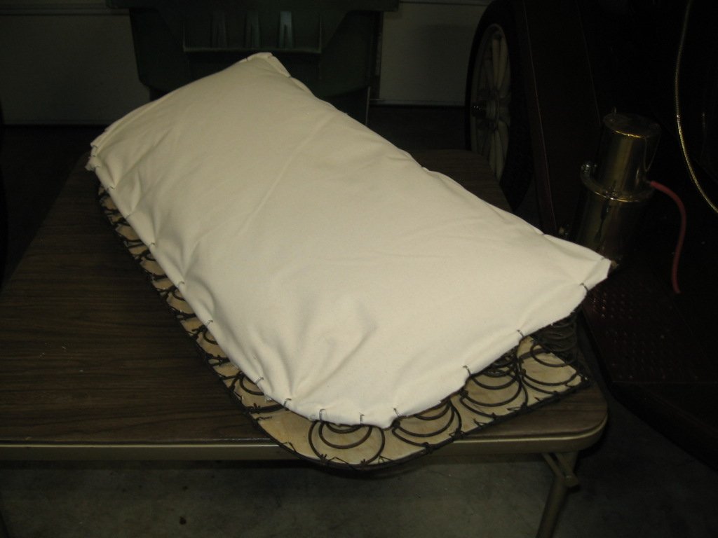

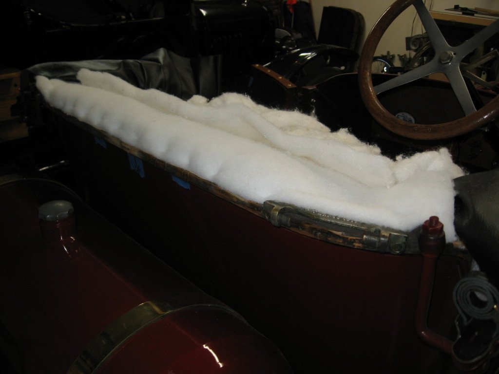

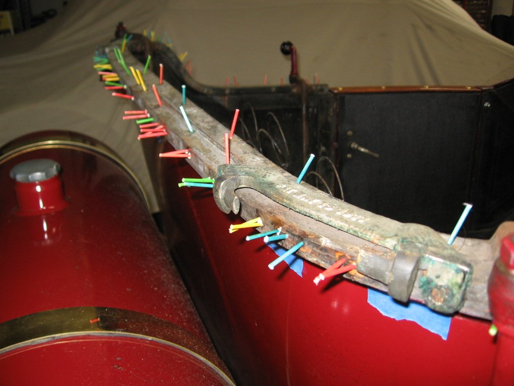

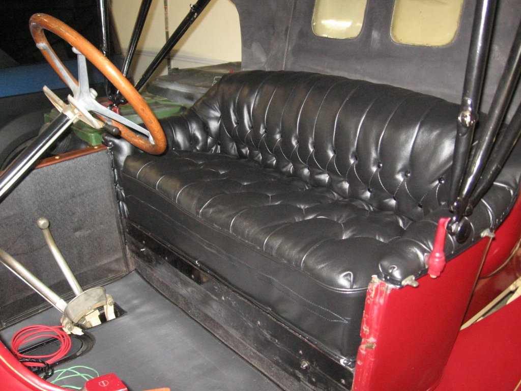

A bit OT, but here are some pics of the installation of a custom Classtique kit I recently installed on my 1912 Flanders 20. I sent them my original leather upholstery and they used it for patterns to make the new kit.
This was only my second attempt at upholstery installation. I definitely recommend getting a good pneumatic upholstery stapler, it will make the job much easier. Also, don't use the cheap hog ring pliers supplied with the kit, go online and buy some good hog ring pliers.
Class it Up also has some videos covering upholstery and top installation:
https://www.youtube.com/user/Classtique/videos
https://www.youtube.com/watch?v=9fHvyfIGhTg&t=16s
