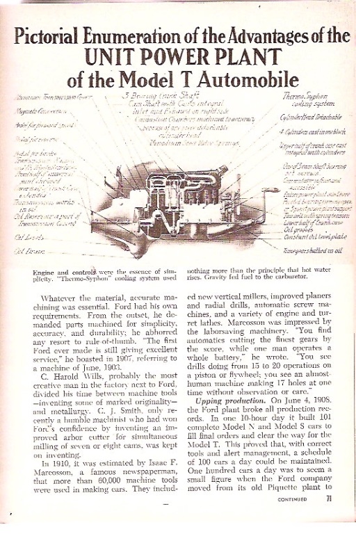

These 2 articles on the Model T in my copy of Popular Science I received in July 1963 when I was 9 years old, sparked my interest in Model T’s and embedded in me, with the determination to, one day own a Model. I saved the articles and read them often for 7 years until my opportunity came in 1970 when I came upon a classified ad in the Tampa Tribune for a 1926 Model T coupe for $650.00 when I was 16. My Dad and I drove over there and I bought it for my life savings of $600.00, which is all the cash I had. It was in bad shape, but complete and I spent the next two years Doing a complete restoration, bringing it to showroom condition. There was no internet for me to consult so the article on how to drive it came in very handy. It’s what I used as a tutorial and helped me immensely to learn how to drive it when the time came. It didn’t hurt that, by 1972, I had it memorized and basically knew what to do. Maybe it will help you. Jim Patrick

Jim
Same here on those 1963 Popular Science mags, had subscription and that Feb issue was one of 3 issues on restoring a 1925 runabout. Saved those then, and used them to help me fix and repair my 24 cutoff back then!
