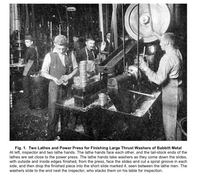

From 1914-15 Ford Methods and the Ford Shops:
Image 5-2-21 at 9.35 PM.jpeg (78.6 KiB) Viewed 3592 times

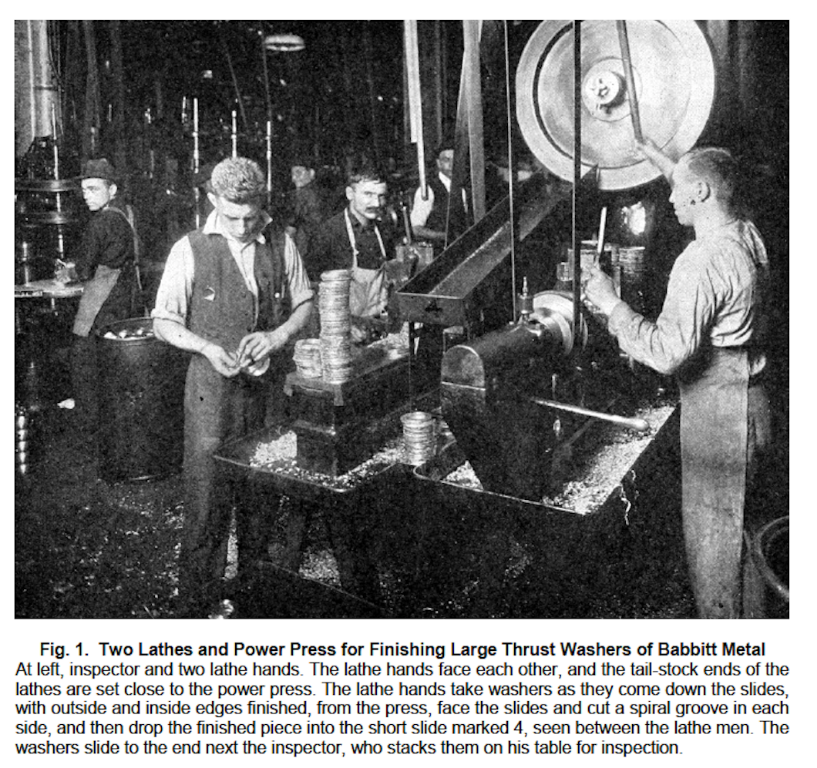

Here's the large print version for us elderly readers. :)

I still have the "question"----does my unrestored 1912 touring have babbit thrust washers? I tested axle movement some time ago and there wasn`t any "play". I`ve always assumed it has metal (brass/bronze) thrust washers. Seems like this is true until aprox. 1914, per Dan T.s article. Had a similar case with my restored 1911 Touring----To the best of my knowlege, the rear axle was never rebuilt. Thanks for any additional input----Paul

As the thrust washers were supplanted by bronze in 1915, we might confidently assume the early ones were indeed a true babbitt alloy. The clipping above showing machine methods on babbitt washers would seem to attest to this.
