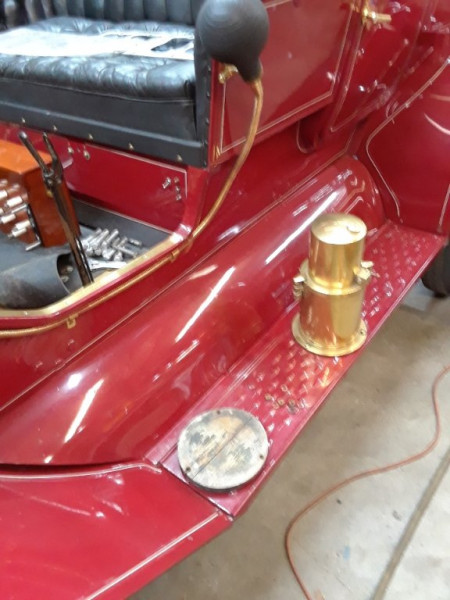

I am questioning how my generator is mounted to the running board. Mine has a 3/4 inch piece of wood under it to raise it above the ribs in the outside of the running board. perhaps the unit is the wrong size? (base to big in diameter)? I seem to not be able to find any photos close enough to see that area. how do all you seasoned club members have your generator mounted? photos greatly appreciated. or at least a very good description.

How about some pictures of your generator, that will give the visual to make some suggestions.

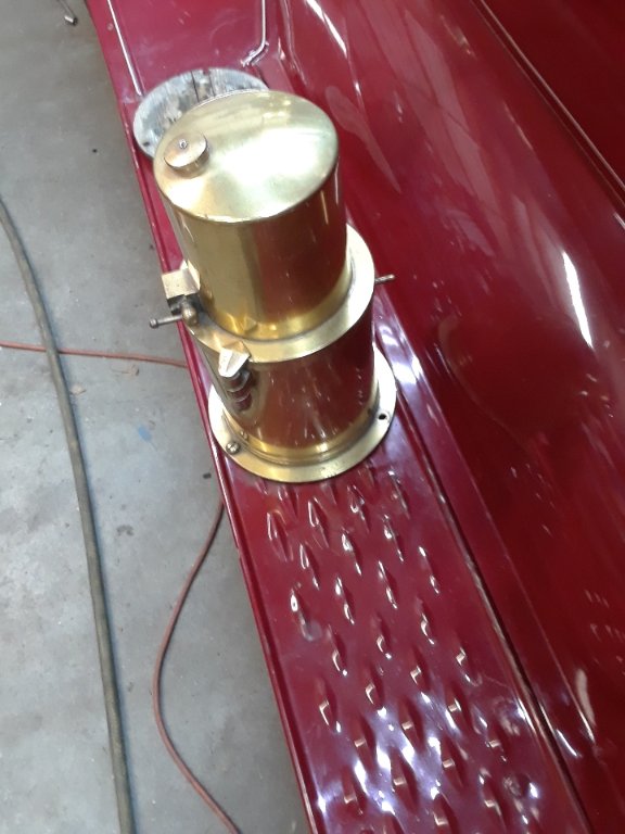

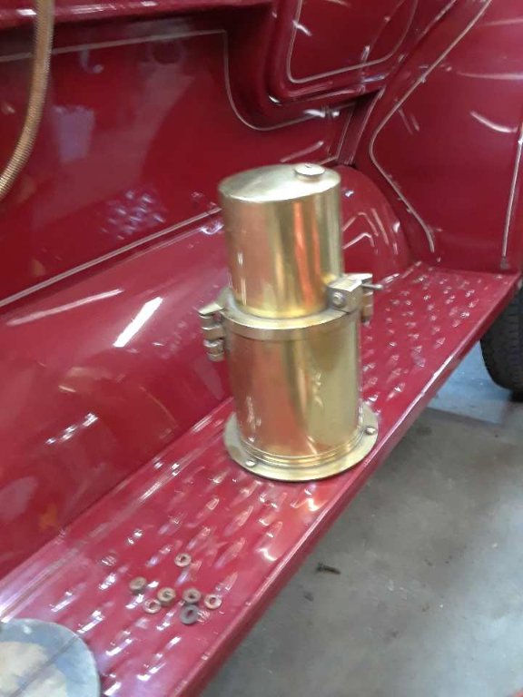

well yes, i should have posted a picture or two. upon looking further I do not think the generator that is on my car is correct. here are some photos[image][/image]

Post by JTT3 » Mon May 17, 2021 2:55 am
