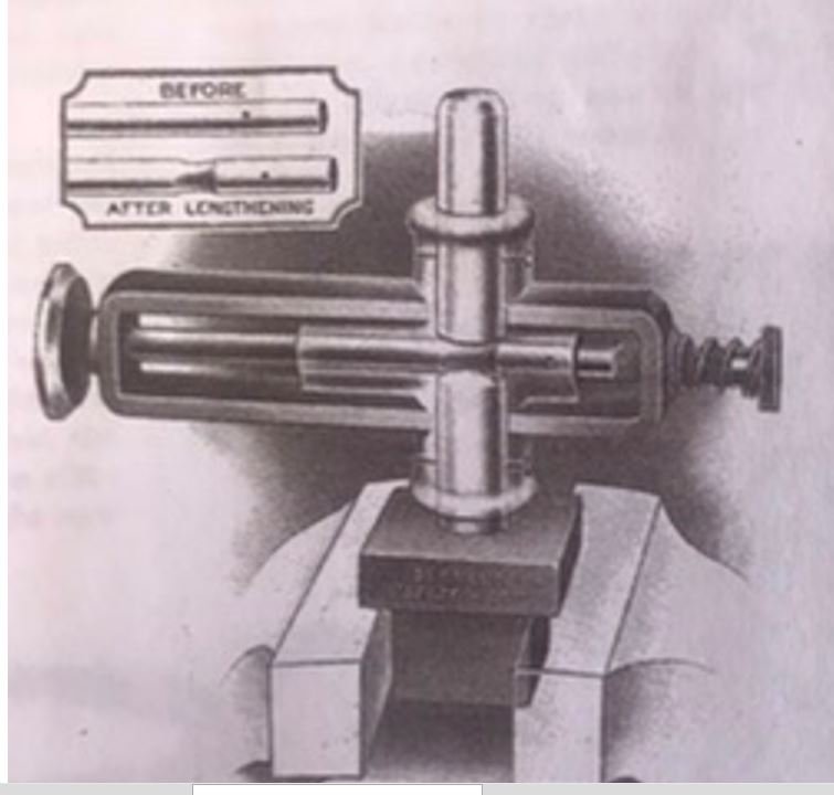

Stevens tool number T-256 is a Stevens valve stem wedge. Lengthens the valve stem without distortion!
Posts: 7307
Re: Interesting Stevens tool
Post by Allan » Mon May 17, 2021 8:10 pm
Kim, does it come with instructions? I can't get my head around how it works. It looks more like a jig to push the head off a two piece valve. That wold of course 'lengthen' the stem.

Allan,
They are necking down the valve stem diameter and that lengthens the stem. See expanded and rotated view:

Post by Allan » Tue May 18, 2021 6:42 am
Thanks Hap. Now it makes sense.
