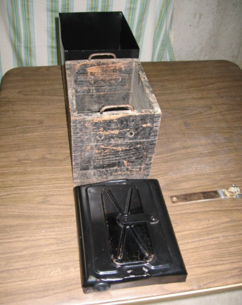

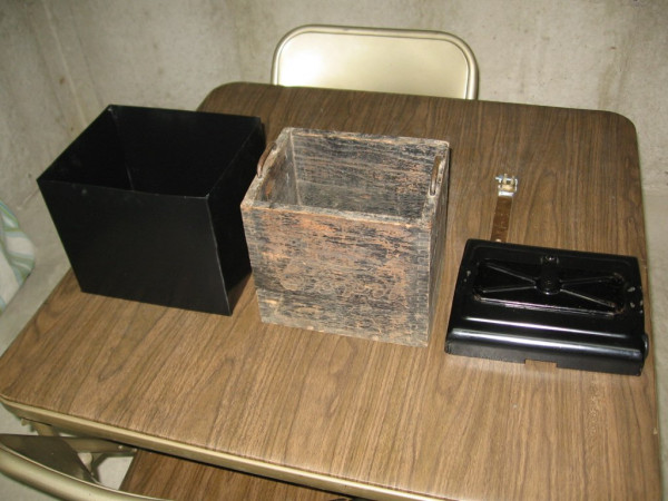

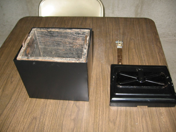

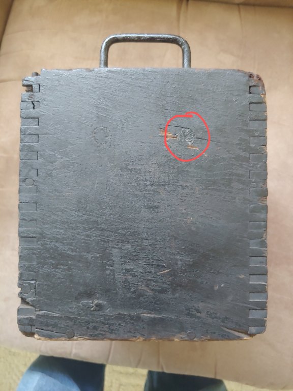

Found this at the Luray swap meet.

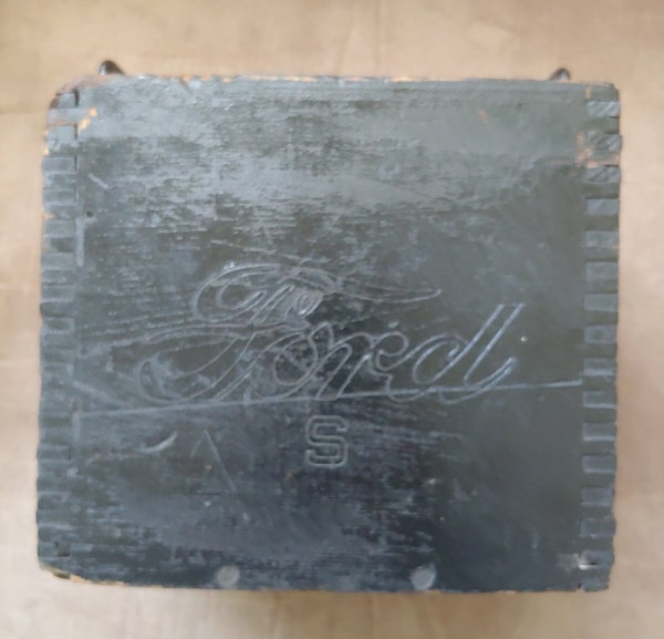

Is this an original box?
Looking at it I have a few questions.

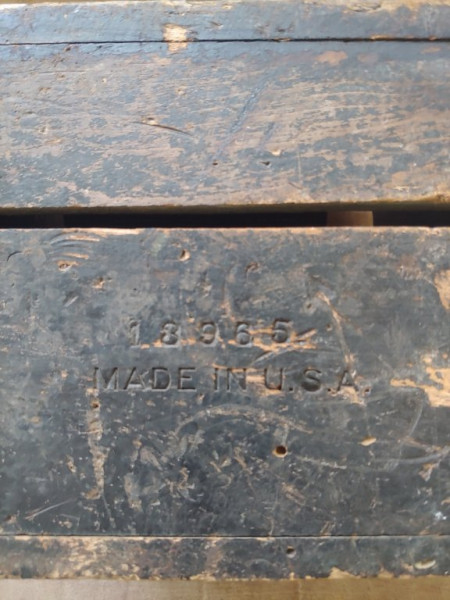

The bottom has Made in USA with a number, what was the number, part#?
Does the S indicate anyting?

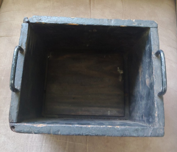

Does anyone have a box apart showing the metal parts?

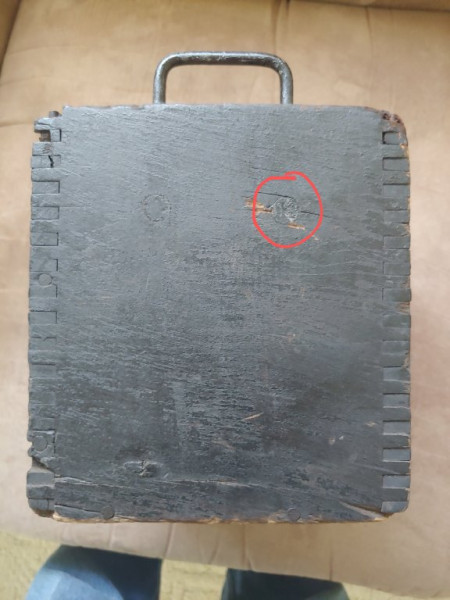

The rivets on the side, how do they "pin" the handle.
Seeing the metal parts would explain the assembly.
Brian

It sure looks original to me. Sorry I can't help you with your other questions.

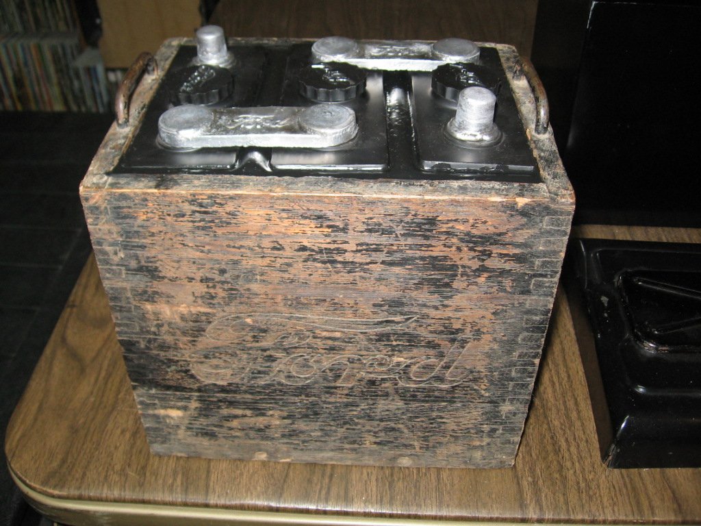

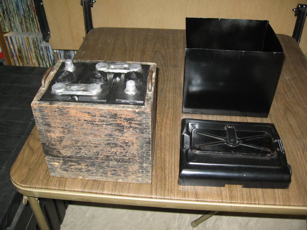

Here is mine bare, then all dolled up into a (non-functional) display battery. I got a complete battery top assembly from New Castle Battery company, then made a small plywood frame to space it up to the correct height in the box. Then I poured liquid truck bedliner into the spaces between the cell tops to simulate the original tar. Turned out very convincing, IMO. :)

Mark seems to have answered your questions. There is a difference between a Battery "Box" and a Battery "Case". If I'm mistaken, the earliest Ford produced batteries had a wooden outer case with metal handles that held the three lead cells and the acid. At a later date (maybe its in the MTFCA Encyclopedia) Ford discontinued the wooden outer case and replaced it with a molded hard rubber case with molded in handles.
A battery "Box" is the metal container that either battery fits in, to protect the battery from the elements, especially the early wooden cased batteries. It appears you picked up a early Ford wooden case at Luray.
Currently, there is an empty later Ford hard rubber case on EBAY. It is advertised as NOS. Current bid is considerably over $100.00.

To quote from the Ford battery manual, "The case or container used for holding the complete cells, is substantially built of hard wood thoroughly coated with acid-resisting paint. Due to each cell being sealed separately, no layer of compound is required over the entire battery. This adds greatly to the ease with which the battery can be taken apart. The case is provided with strong loop handles, which are securely anchored without screws or bolts."
Each two volt cell was a separate sealed unit containing the plate assembly and having contacts/poles built into each each unit. That would account for the survival of some cases in reasonable condition.

Your battery box is original. Here’s a Ford advertisement for your battery as it was sold back in the day:

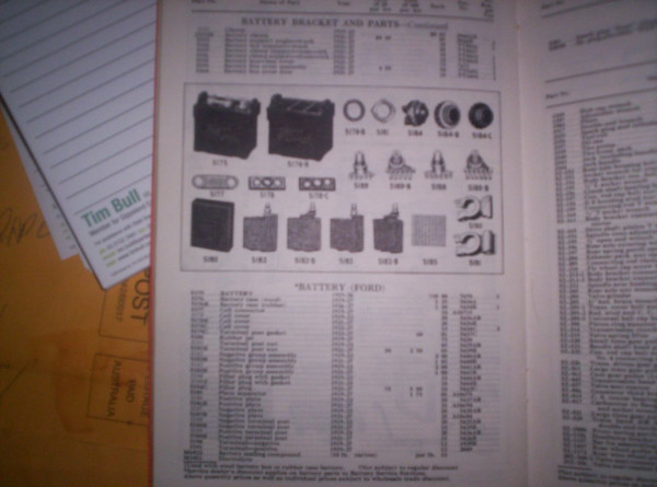

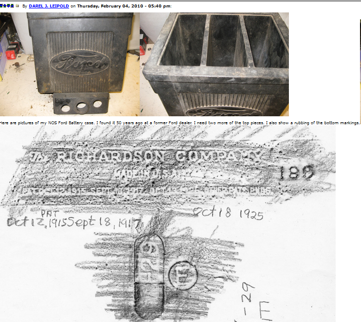

Allan, it seems that parts books differ some from the Ford battery manual, parts book break down to the battery positive and negative plates and cell jar.
Excuse the photo quality as my scanner has died.
Part No for the wood case is 5176 and rubber one 5176B

Jim, the Battery manual goes into detail on the assembly of the battery. The individual negative and positive plates are assembled into groups, with separators. These groups are assembled into hard rubber 'jars', which are individual containers for a group of plates. These are essentially a 2 volt battery. Three of these go into wooden case, and are linked together. The important thing is the individual jars are sealed, and linked together in the case. They are not sealed in the case, making their removal for maintenance/repair easy, and incidentally has led to the survival of some of the wooden cases. The batteries could be broken down into individual components, as you parts book shows.
The battery manual goes into great detail on how to assemble the components into a working 6 volt unit.

First, lets get the terminology correct. The wood box above is the battery case, not the battery box. The battery box is the metal box that the battery case goes into. I have several original battery cases, and they are what supports the cover of the battery box. Without an original Ford battery case, it will not support the lid very well. I eliminated that problem by making two supports out of thin angle iron. To the angle iron, I made two handles, that are exactly the same as those on the Ford wood battery case. These are placed on the ends of a modern 6 volt battery. With the factory battery clamps, the lid is held on securely just like the original. Don't forget to place the sleeve on the positive cable where it enters the lid. There is no grommet. I had to place a piece of 1/4" plywood on the bottom of the battery box to bring the modern battery up to the top of the battery box. I also put a piece of 1/4" plywood on each side of the modern battery to keep the battery snug in the battery box.
