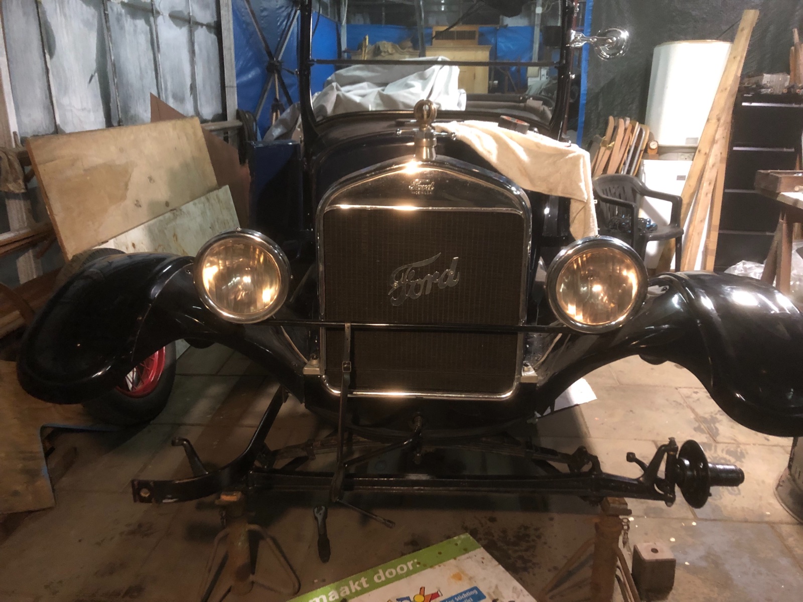

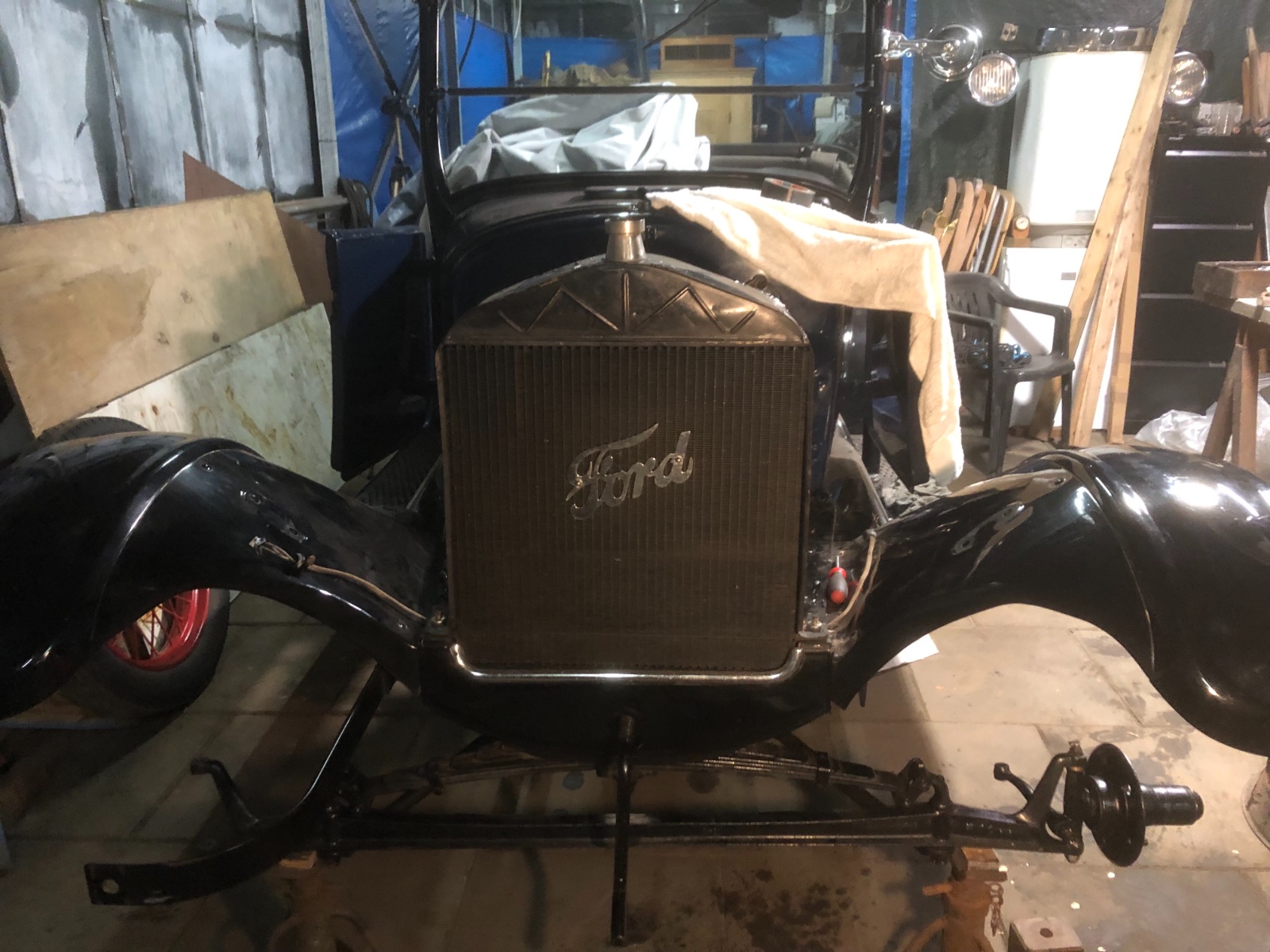

Its not possible without removing the lightbar
Because of the starter handle (in dutch “de slinger”)
After taking out the bar it is not a hard job to take out the engine
If you have an engine lifter..
