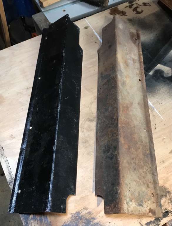

Post by Will_Vanderburg » Mon Jun 14, 2021 7:05 am
Here they are. They are originals. Need some work but can be made usable.
O.K. , now if you are willing to sell them what is the price tag ?

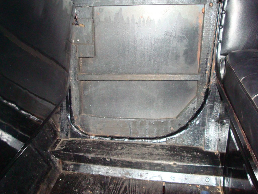

Post by Erik Johnson » Mon Jun 14, 2021 11:16 am
I suggest studying the matter further.
My dad's 1917 touring doesn't have sheet metal over the sills. He bought the car in original, unrestored condition from the original owner in 1949.
Here's a photo I took a few years ago when he was replacing the leatherette interior door panels (note the original factory paint/drips on the inside of the door).

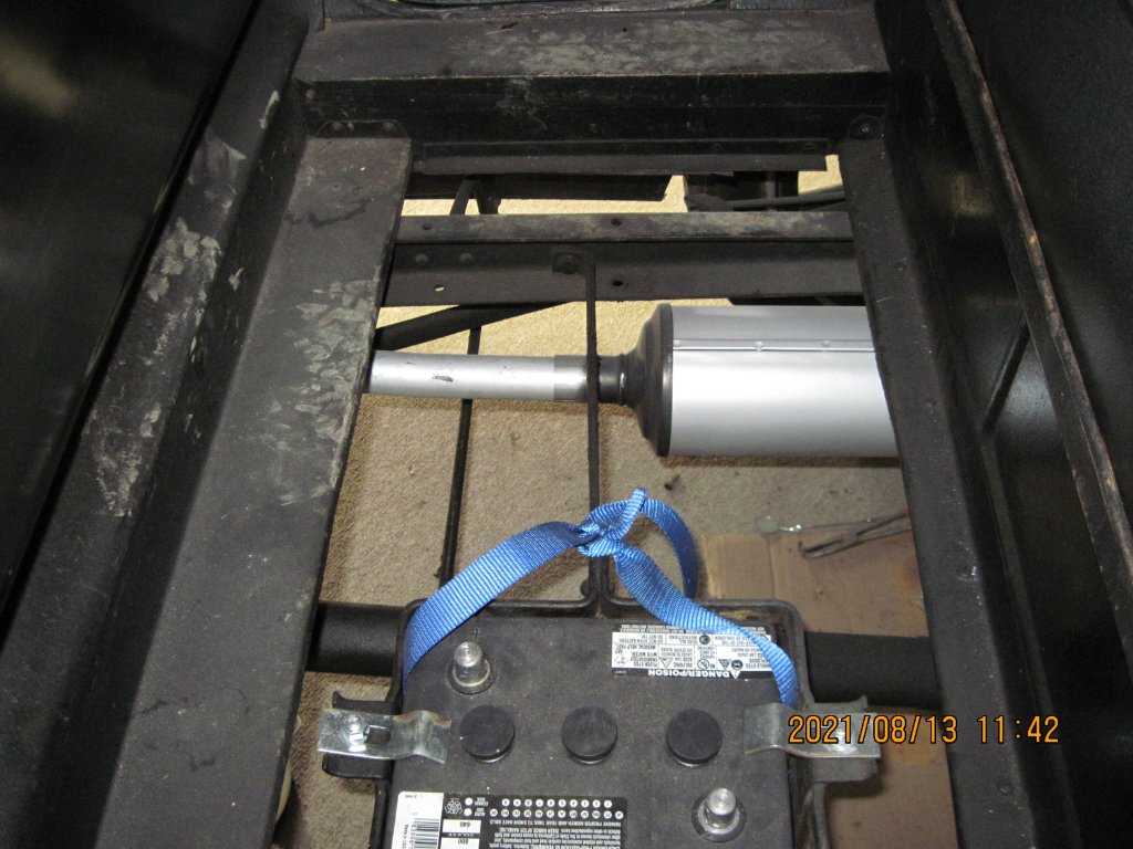

I know 1917s didn't have them. Without seeing the front of his car, I cannot determine the body/hood height.
I am fairly certain his chassis has the wrong running board brackets on it, if the picture he posted of the battery area is of his car.

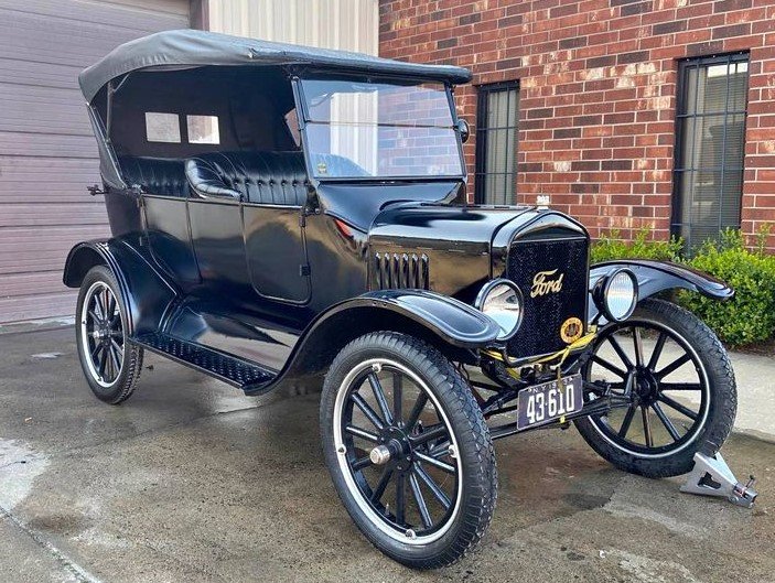

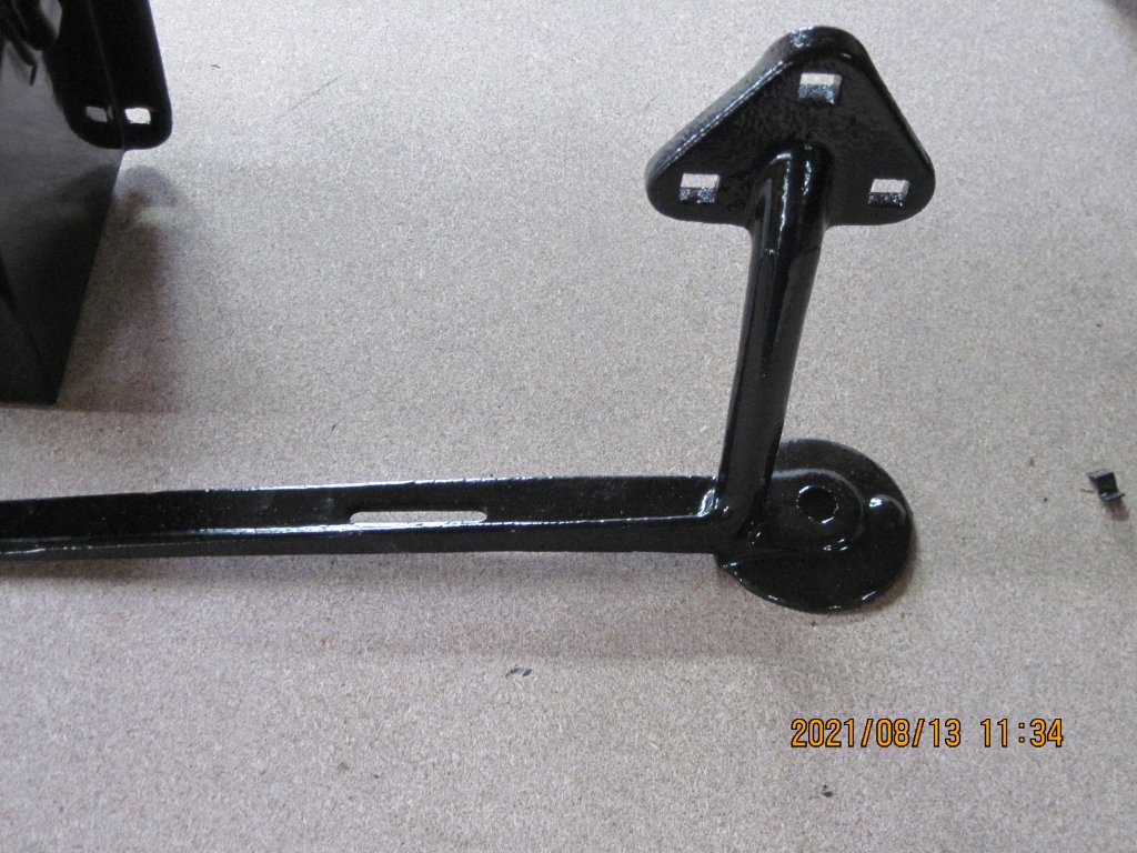

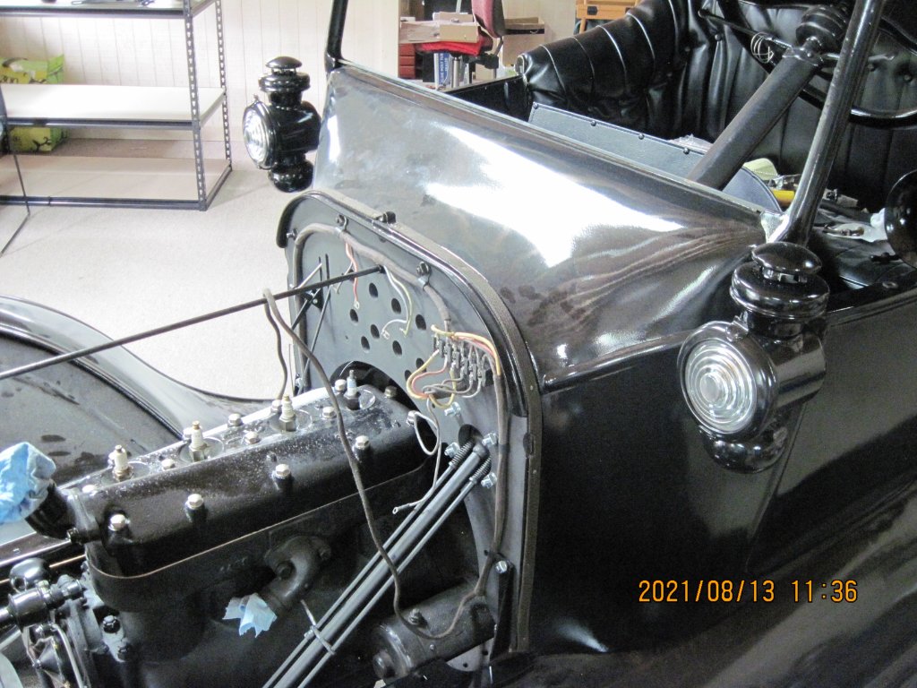

It's a low hood, please enlighten me with regards to the running board brackets being wrong, how so. It is my car , picture at bottom when I picked it up, engine was out and came with a spare October 1920 engine.
Other pictures showing bracket rivets to frame and cowl (yes, I used the wrong head bolts because I like them).

Post by Will_Vanderburg » Tue Jun 15, 2021 7:27 am
Running board brackets in 23 were stamped, not forged as they appear to be on your chassis.
Thanks, many things have made me question the year but parts swapping (by year) is so common, engine block change mostly , it's a Johnny Cash song car.

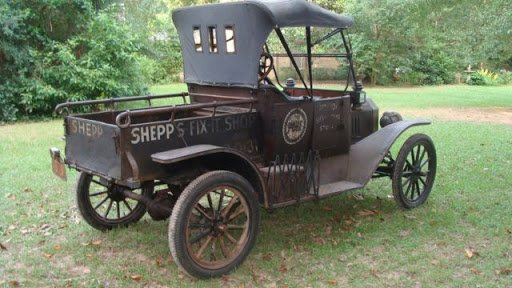

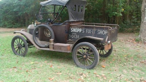

Has anyone on this forum done a touring car conversion ? If so can we/I see how it came out.
Picture below is from this forum, very nice car. This should be doable on a touring car. Would work great for farmers market.

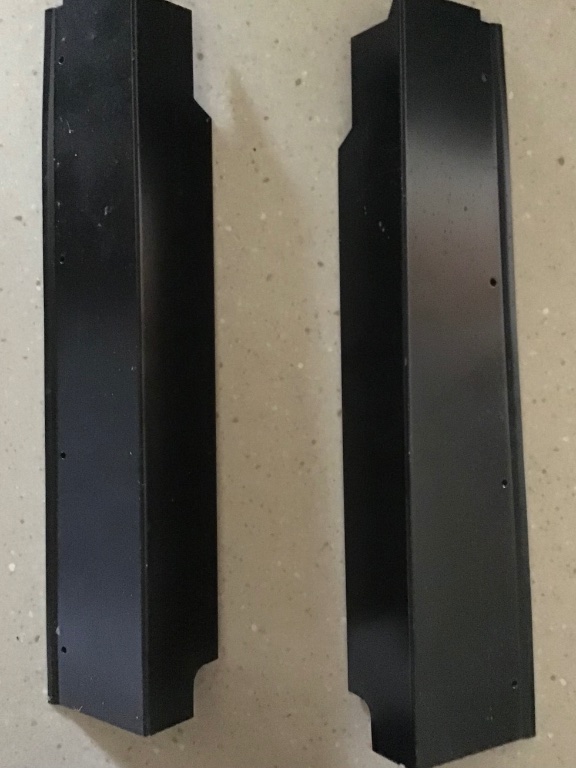

Post by John kuehn » Tue Jun 15, 2021 6:10 pm
Here are some new sill covers I bought for my 21 Touring but didn’t use. They are pretty nice. They were advertised by Howell sheet metal to fit 17-25 Touring sills. They do fit but I decided not to use them. I am planning to put these in the classifieds along with some mor T parts.

I know that , that's why I posted the pictures. Has anyone on THIS forum done it, how did it turn out.

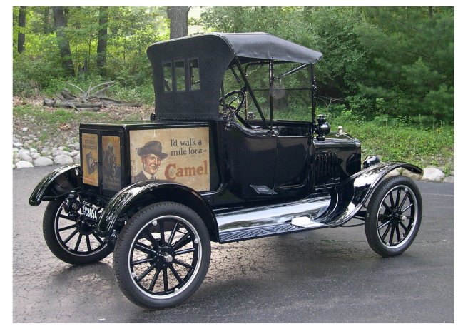

Shepps , Duplex pictures are of touring cars, the roadster would be a salesman set up

I restored the model t camel delivery. It was on a roadster not a touring. You are correct it is a very nice car. I restored it for Joe Southward in Olivet Michigan probably about 1997. It was sold after his death and I have lost track of it. It’s a 17 with a later set of wheels on it. Nice car and Joe was a very nice guy. I miss him and his wife Jane a lot.
