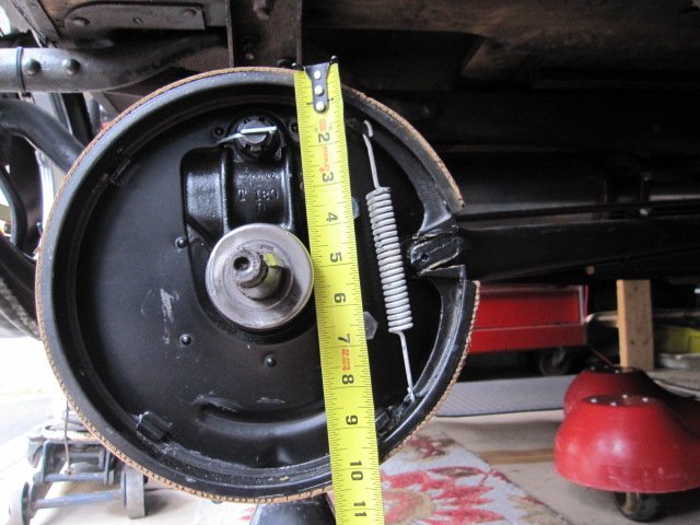

The last picture is the cam when my lever is set @ 12 O'clock or neutral, looks to be level @ 9 & 3, brake lining relaxed approx 10 1/2"

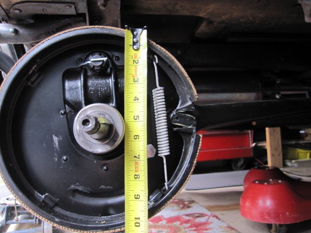

The second picture is the cam position with lever set back as I would when stopped & parked, nose down @ 4 and heel up @ 10, brake lining extended approx 10 5/8" +

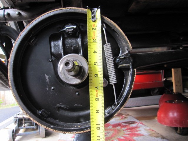

The first picture is lever forward as in high gear engagement, nose up @ 2 and heel down @ 8, brake lining is extending outward just a tick under 10 5/8" - this might be part of my problemo.
I think filing off some material on the brake cam upper right and lower left as pictured and some off the brake shoe ears in those locations where they ride will help relax the lining to a somewhat neutral lining position while in high gear (lever forward). Any input would be great.

It might seem intuitive that "neutral" means the brake cam is level, but that is not true. Your brake rods are adjusted a little too tight and the lining is likely dragging a little on the very ends of the material.
Do not alter the brake cam

DONT BE GRINDING.
When the cam is horizontal, the lever should be back about 10 o clock. If you could see it looking from the cam side. When activated ,lever moves forward to 2 o clock.
There are rights & lefts on those cams. Cams on wrong sides??

When you are going down the road, the lever is right forward. This is when you need the brake shoes to be completely disengaged. So, the rods should be adjusted so the cam is level when the lever is forward. However, engaging neutral with the lever will slightly rotate the cam and likely make the brake shoes a closer fit.
Because there can be a little slop/wear in the components, the closer fit can be compensated for by adjusting any slop out of the system. With the lever forward, adjust the rods so that the slop gets the cam just engaged on the opposite cam face to where it usually activates the shoes. When the lever is pulled back into neutral, the cam will transition from that opposite face to the working face, with minimal action on the shoes. This gives the best chance of non dragging shoes going down the road, with least drag in neutral, and optimum cam action when needed.
The same steps can be used on the earlier brakes too.
Hope this is clear.
Allan from down under
Hope this is clear.

Thanks for all the input on this matter, the explanations help and can now adjust from my current setting. Get it road tested with better results.

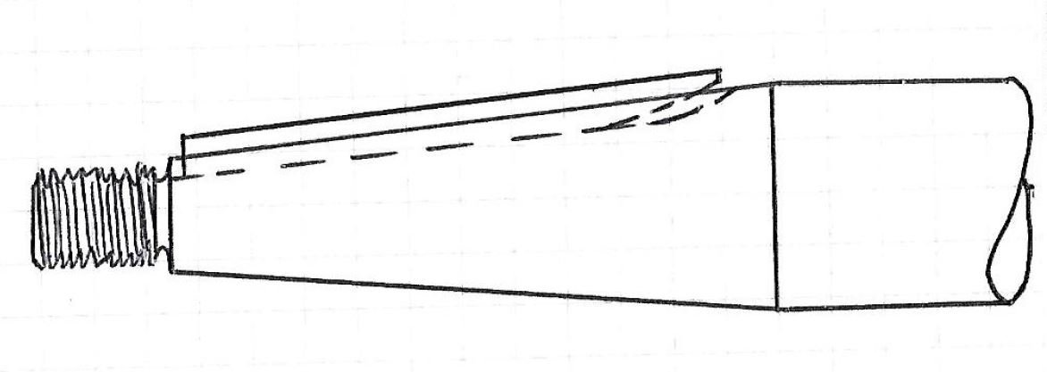

Looking at your axle key. It appears in the photos, that end of the key, adjacent to the threads, is tapered. If that's true, then the key is installed upside down and backwards. The squared off end should be adjacent to the threads, and the tapered side should be facing "down", to allow clearance for the shallowing of the keyway, as it approaches the axle seal.
Like this...
But maybe I'm just not seeing it right in your photos...
Like this...
