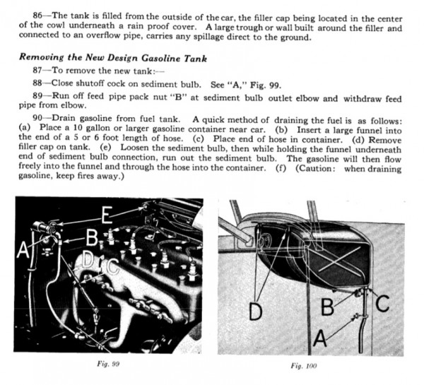

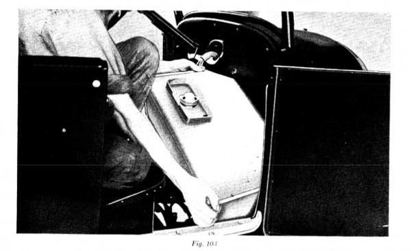

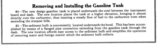

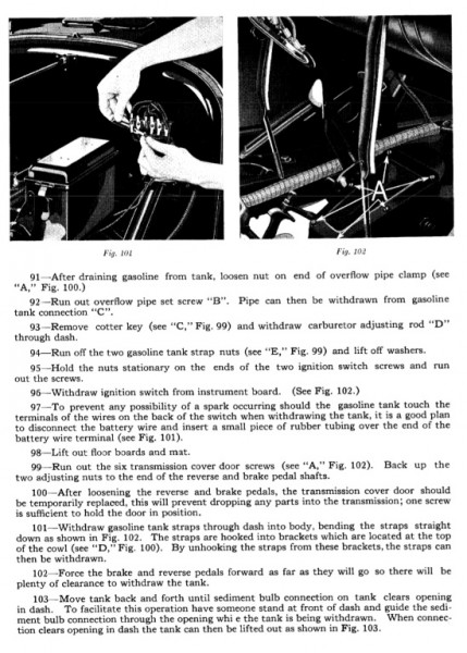

You shouldn’t have to remove or loosen the dash. You do have to remove the floorboards. The info on procedure is in the service bulletins.

The Bible says one thing and has pics of a closed car. On my touring. I had to remove dash and screws and one and two screws from the stantions and four bolts from steering column. Discovered and confirmed that the dust. from dash to firewall is different. Open cars are shorter than closed cars.

Post by Adam » Thu Jun 17, 2021 9:10 pm

Nope, just have to follow procedures (posted above). Done it probably four times. YES, there is no margin for error and it can be a real pain to get everything in proper alignment, but it can be done.
The coupes and tudors are super easy. The tourings and roadsters are much more difficult, but once you’ve done a couple of them, they aren’t impossible.
