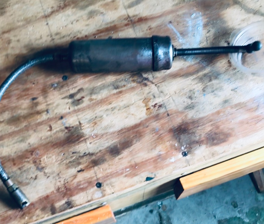

Apologies in advance for this query about modern Fords, but I was unable to find much information through Google and really don't want to join any Model A forums to post one query. I know many members here are familiar with and or own Henry's Lady.

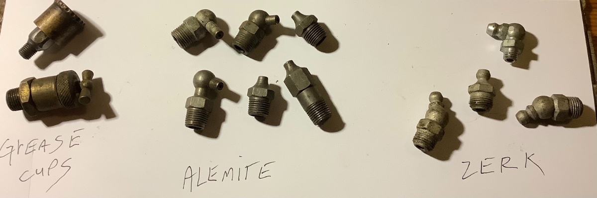

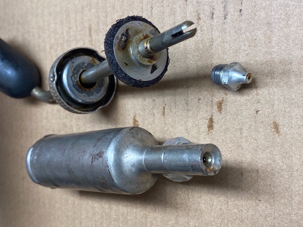

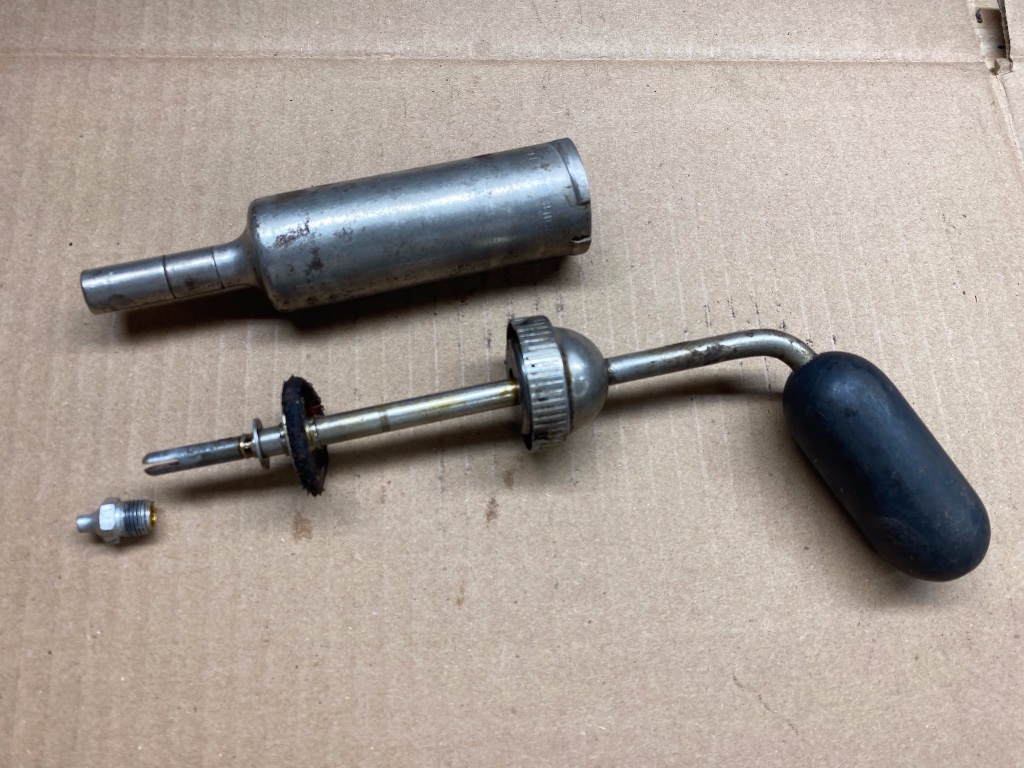

I believe the grease gun show below fits the original style Model A grease fittings, also pictured below.
Is this indeed for the Model A, and if so, is it complete and how is it filled and operated?
Signed, Befuddled
Signed, Befuddled

Typical Model A grease gun with the tool kit is this style.

Re: Model A Original Grease Gun Questions
Chris , the leather piston must be in good shape. To use, a wooden paint stir stick would be used to fill it out of a tub of grease. Not much else to tell. They are messy little critters.

I believe that I have proven to myself that the 'zerk' system as shown in your stash was either not available until the 30's and the precursor was a 90 degree twist and lock system that in my opinion is actually superior to the snap on type shown in your pic.
Here is a picture of a similar gun. This pic shows a screw type as opposed to a plunge type. The business end is the type of the T era. My '19 Hack actually has aftermarket grease cups used as front hubcaps
The A may be different, but here's what the twist on fitting looks like. They are still available and the Chinese use them all over the place!

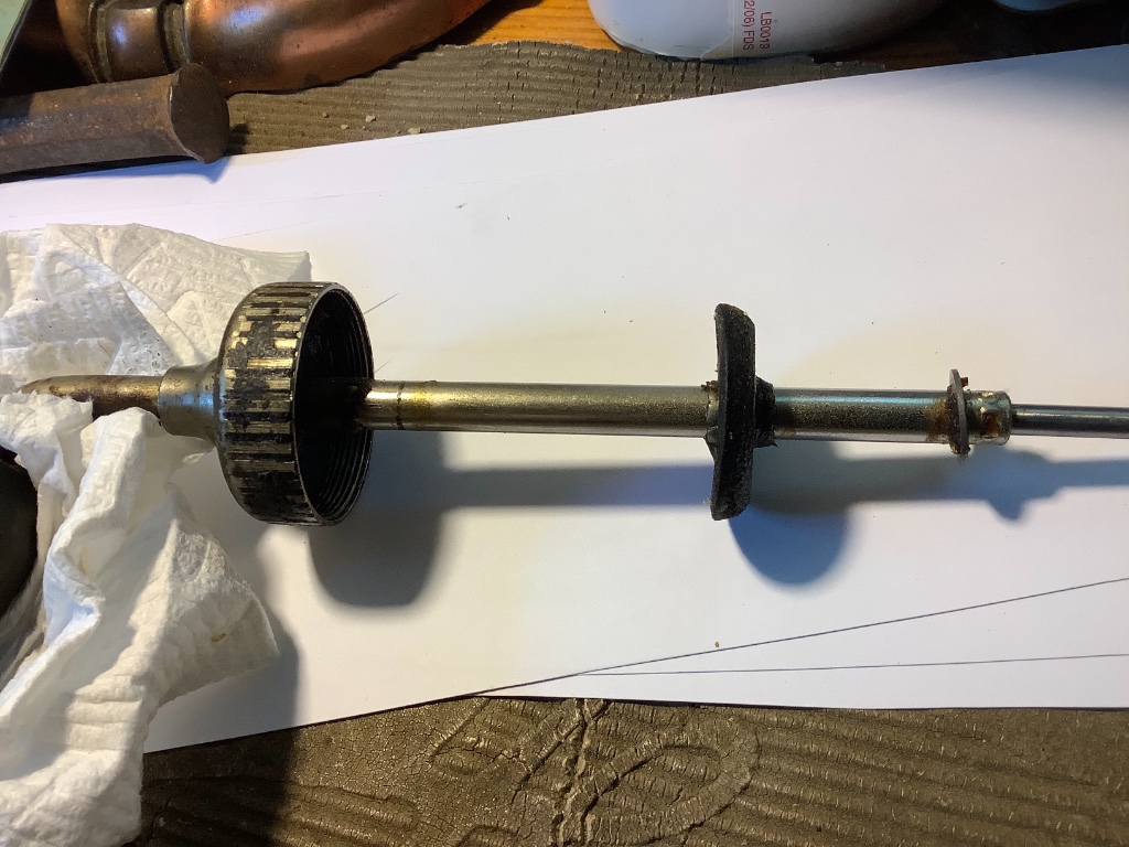

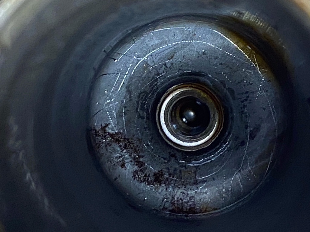

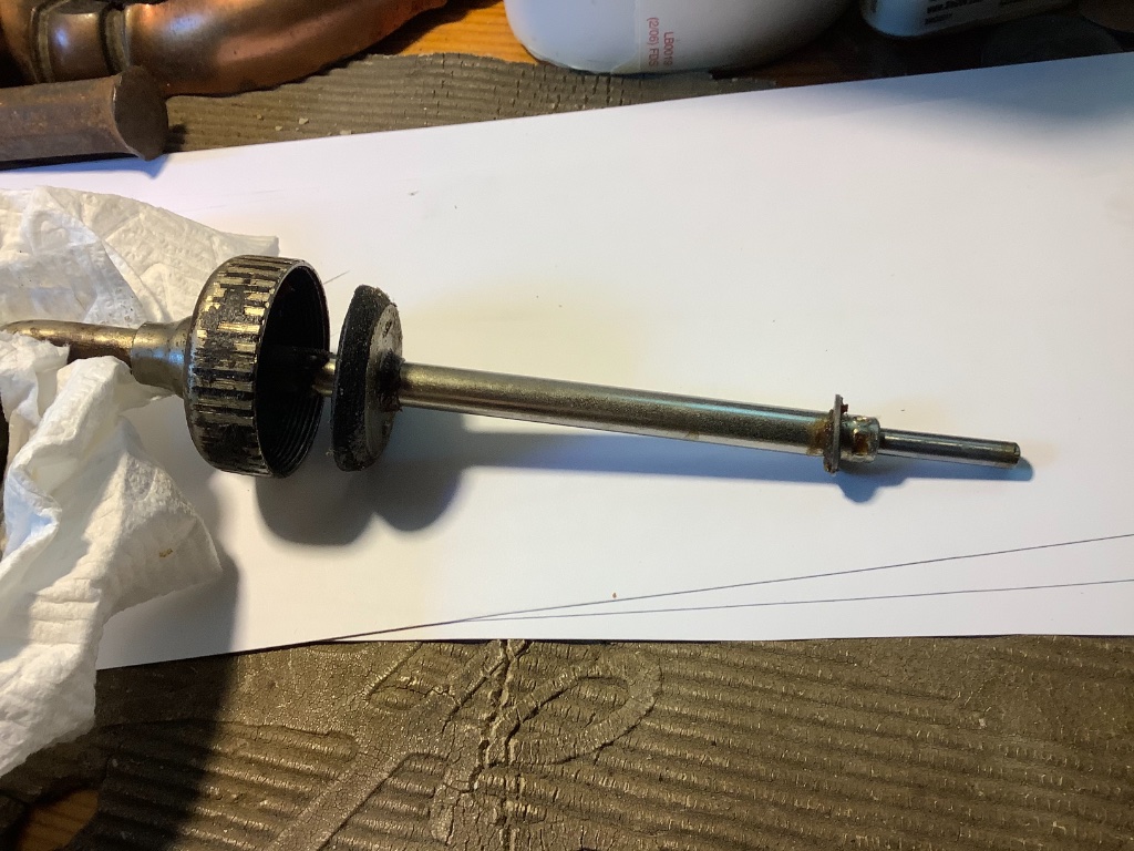

Thank you Tim. I'm echoing Steve Jelf's "Feeling stupid" sentiment with this grease gun conundrum.
On the grease gun in my photo above, the leather washer slides freely up and down the shaft. Is this correct? And what is the purpose of the washer? It seems no amount of plunging would move the washer in either direction, nor would the washer force/encourage grease to move toward the tip end as the reservoir is depleted. The shape of the leather washer appears to let grease travel from the tip end to the handle end, but discourage movement in the other direction.
The plunger rod travel is about 3/4", toward the fitting end, with a spring return. The fitting end appears to have a ball check valve.
I could fill it with grease and hope for the best, but I would really like a better understanding first, particularly of the leather washer. To my mind, there ought to a spring between it and the handle to keep the tip end filled.
What am I missing?
What am I missing?

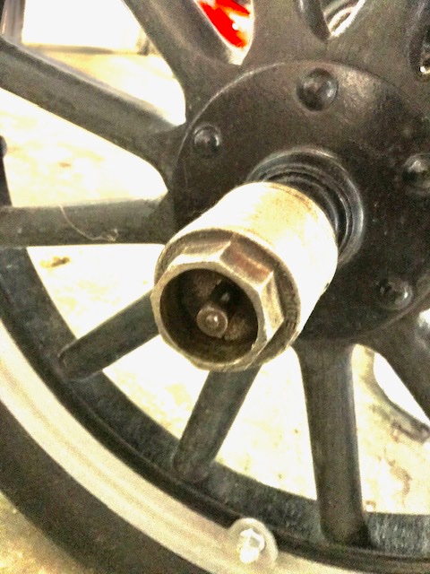

And not to argue, but the loose fitting in my photos was taken off the Model A in question, and matches exactly the illustrations in an seemingly-comprehensive and well-regarded Model A repair manual. The manual does not discuss original grease guns, only the use of a Zero-to-Model A adaptor, or the replacement of old style fittings with new Zerks.
My understanding is the pin type in your photo was not Model A, but used in other cars of similar era. I have a couple of those guns and a few loose fittings.

Chris, all you pump into the pin alemite fitting each time you stroke is what grease is captive in the slot. This causes pretty good hydraulic ( not sure the right word) pressure to do the deed. I’m heading out in a bit and will take one of mine apart, to see how the washer with leather operates. Hate to say without looking at one.

Mine has a solid pin that acts like the piston. The leather sandwiched washer just floats on the shaft, probably to aid in getting the grease neatly inside when filled. Perhaps the suction action keeps it on top of the grease when pumped. The stroke is not much but they work well. I’ll check a couple others.

No argument taken. Cars had grease systems from the time of inception.
There were grease screw cups...then, there were the pin type twist on, then there was a Zerk (early) and then there was a Zerk (late).
The 'zerk' concept came along as an idea in 1919, and as was common in the era...he who had a better idea got shut out if he didn't work or royalty free the car makers. The owner eventually gave up about 10 years in and sold his idea and patents to Stewart...the speedometer people and 'surprise' they knew how to sell to the auto folks!
There are some that believe all Model A were built with Zerk (early), some who want to believe that a Zerk (late) was used on later A and is in fact superior technology, therefore appropriate for all Model A.
So let's look at your problem backwards. From what you show, that's a Zerk (late). If the car is all Zerk (late)'s...then the tip of the gun has to be for a Late, so that it snaps onto the ball tip. End of discussion.
If the tip is for an Early...it's good for show but not that type of Zerk...no problem, tip can be changed on the gun, modern auto zone tip will work if you can get the threads to line up with the gun tip.

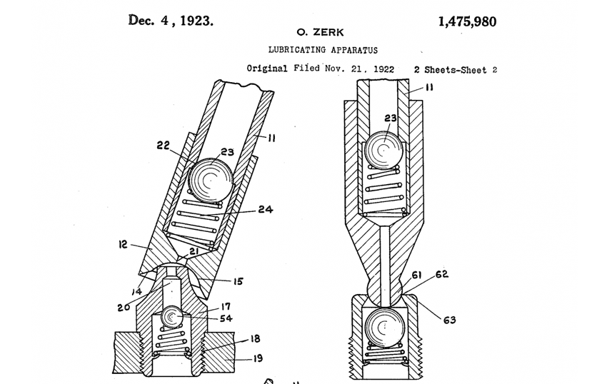

As far as how does the gun work? Here is the original patent for the Early type and its derivative.
There is a spring check in the gun, it moves forward when squished...

A pin Alemite fitting and a zerk fitting are two different animals, George. Chris is showing a pin Alemite gun.

And a cross pin Alemite is yet a different animal. I think one is shown on the hubcap picture.

Thanks, as always to those who replied. This has been a good education for me.
The gun I have does indeed work on these fittings. The secret, for me, was to ignore the apparent uselessness of that sliding leather washer.
It is no surprise most Model A have modern Zerks.

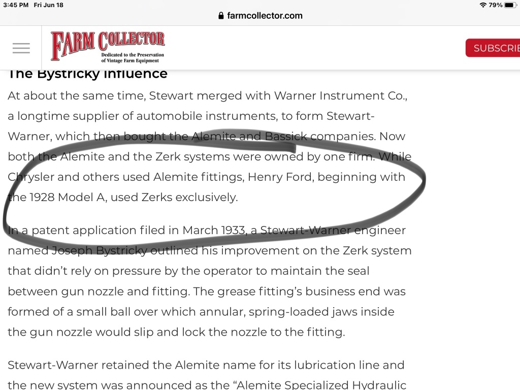

The farmcollector.com has a short story, " From Alenmite to Zerk ", that tells the story of grease fittings and how they got named, zerk fittings. A very interesting read.

Matt, this jumped out at me in that article

Yes, the Model A used the Zerk type fitting, like what was shown at the top of this thread. By the time the Model A came out, Stewart Warner owned both the companies that made both Alemite and Zerk type of fittings and chose to use the name Alemite for both types of fittings that they sold. The Zerk style fitting would have been less expensive to produce, no wonder in 1928 why Ford used that type, now sold by Steward Warner under the Alemite name. This has confused me for years, but it is now clear what type fitting is what.
