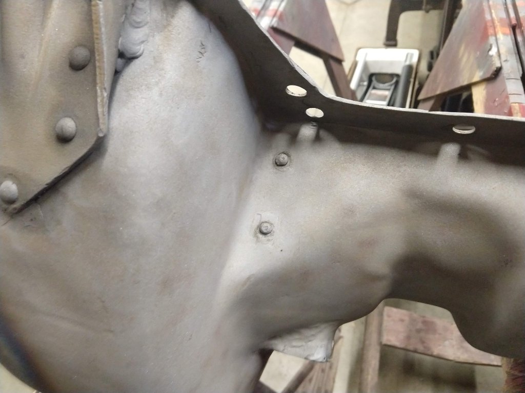

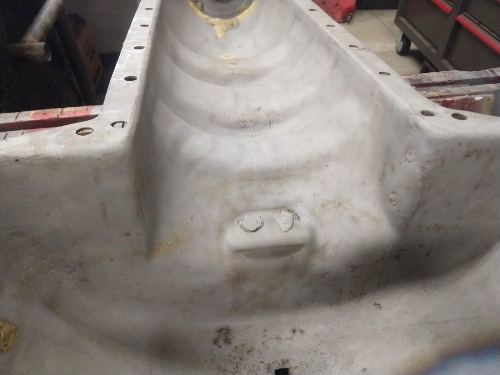

Pics of pre 2500 oil pan.

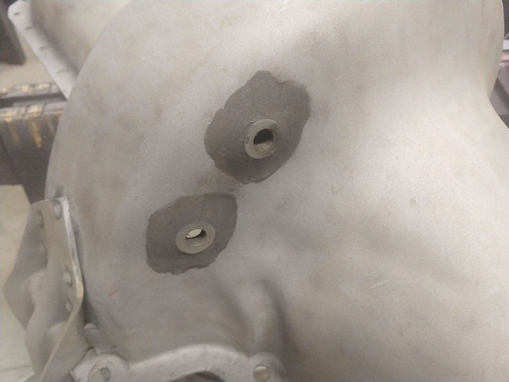

A few more.

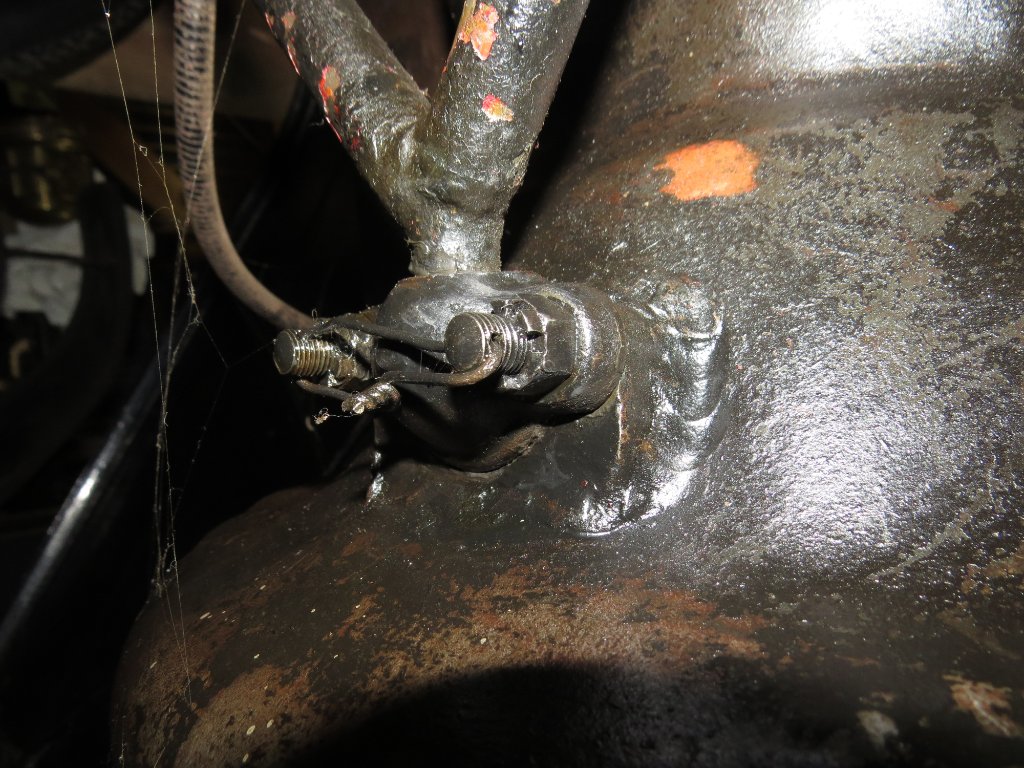

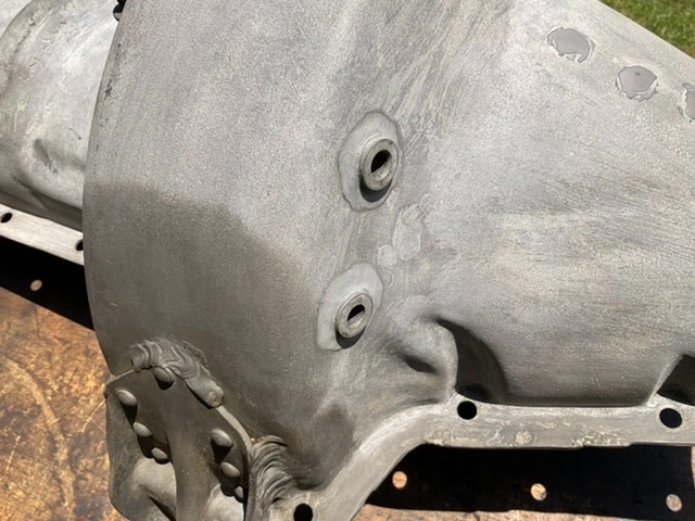

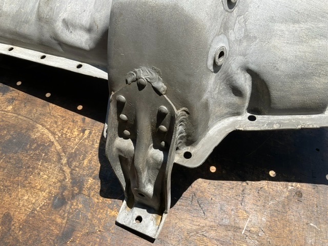

Post by Tod Wirth, WI » Tue Jun 22, 2021 11:42 pm
Thanks for coming to the rescue again Kim! Your photos are a big help.
I do have some more questions for you though.
Do you know the engine number for that pan by chance?
What is the single rivet for under the ball socket on your pan? This one doesn't have that feature.

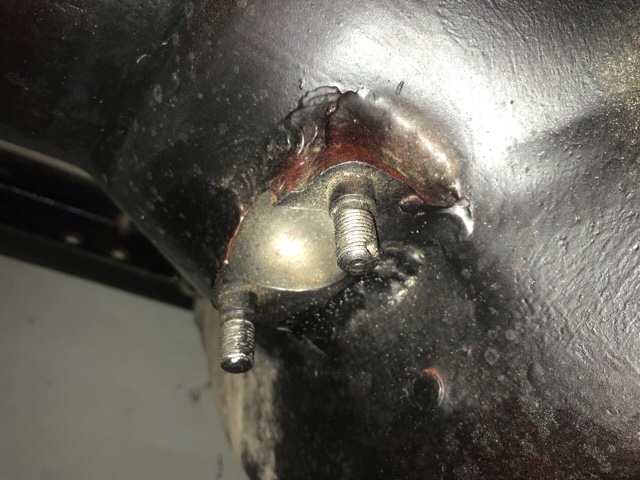

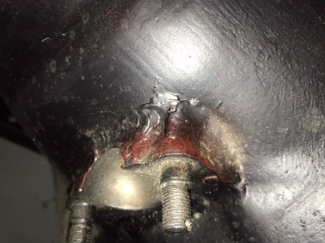

Here are the welds on the pan arms. They have been there long enough that 3 out of 4 are cracking, but how long? Seams like they were put there to prevent a problem as apposed to fixing a problem that was already there. Any sign of these on your pan? I don't remember ever seeing these on another early pan.

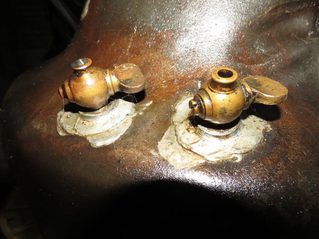

What do your petcock holes look like? Is it smoothed down like these? These have been brazed on the inside of the pan and solder has been used to finish the outside of the pan, and then ground to a fairly smooth taper.

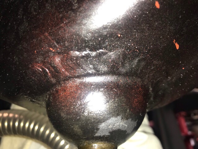

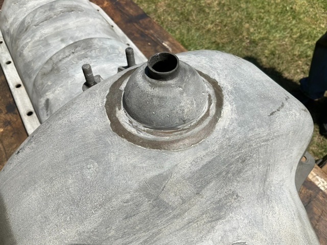

On this pan the welding around the deep tea cup is not as wide as yours and it has been smoothed/ground down some. The rear flange welding is rougher but some attempt was made at some point to add brazing and also smooth it out somewhat. The welding work around the ball socket looks like yours but has also been ground down to smooth it out some.
I took some photos of #220 a little while back, but unfortunately these details didn't show well in any of them. I thought the welding around the deep tea cup looked more like the pan I am working on, but I also want to say that the petcock holes didn't have the soldering around them and they just stuck out of the pan.
It seams a little odd that someone would try to smooth out the welds during it's restoration by Harrah's, but leave all the numerous dents I had to take out of this pan (strangely, a lot of them from the inside of the pan and not due to mechanical failure).

Post by KimDobbins » Wed Jun 23, 2021 10:15 pm
Pictures are of the pan from engine number 314. The rivet under the wishbone socket are for the oil dam.

Post by Tod Wirth, WI » Fri Jun 25, 2021 3:46 pm
Thank you again Kim for taking the time to take and post these photos!
I'm finding this quite interesting. You can see some progression from your very early pan to the pan I am working on (#1400). I was surprised to see that they started out welding the pan support arms, and all the way down the sides at that. Ford must have realized very early on that they had a problem and that the rivets holding the pan arms were not enough. Seams like the welding of the pan arms was a fix on par with the fish plate in the frames. Looks like they cut down on the welds on later early pans, but the cracks in the welds on this pan suggest they still had a problem. Brazing of the arms to the pan, later on, then makes sense to spread out the loads and stresses incurred. #1400 also shows a weld at the bottom tip of the ear like your #314, but it has been cleaned up more.
Like the pan arms, the nose casting does not show any signs of external brazing on #1400. #314 looks to agree with that.
Not sure what to make of the treatment around the petcock holes yet. Seams like they were refining the production process and the product as they went. This could be original. Not sure why someone would add it later other than to try to solve a leak. Nothing else is soldered on this pan so a later repair is my best guess at this point (but I was wrong on my guess about the welding on the arms). Would be helpful if I could see some other examples of pans closer to #1400. I will try to get a hold of either Royce Peterson or Arrdean Vaughan about #904 and see if they have anything to add. Any other suggestions?

Dave, Good to see that your pan arms are welded too. It is clear to me now that the welds on #1400 are original (but cracked :cry: ).
The soldering around the petcock holes is how I would expect to see it done if they were soldered, or brazed, at all on the outside. It looks to me like the brazing, inside the pan, on the upper petcock fitting on #1400 cracked and I think the solder job was a way of fixing it without disassembling the engine. Would still like to see a pan closer to #1400 on this issue.

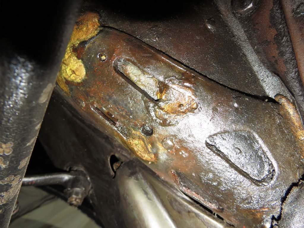

Those rivets below the transmission were for some kind of band support. I've never seen the drawing of the support so I don't know anything further. I'll post some pictures of the pan from #980 tomorrow.

The band support was an “L” shaped sheet metal bracket that was riveted to the pan directly under the transmission on the earliest Model T’s. It seems the Ford engineers felt it was necessary to have something to prevent the bands from dragging on the transmission drums. Most examples of early (very low numbered Model Ts) surviving pans have had the band support removed or broken off. The drawing for the band support is in the collections of the Benson Ford Research Center at The Henry Ford.

The “Oil Dam” on #980’s oil pan is of the type used on the first 2500 cars according to the factory records I have found. It carried the factory part number T-814. Technically, the one on #980 is an example of a T-814A. A slightly different design for the oil dam was used on later 1909 and 1910 cars. The later dam used a slot in stead of the 1/2” round hole you see in the picture Kim provided. There is no mention in the early pan documentation that the oil dam was to be welded in place (the factory drawing shows where other parts were to be welded, including the oil petcock supports).
The band support was riveted to the bottom rear of the pan, under the transmission. It was given the factory symbol or part number T-813. It appears to have been used on the first 2500 cars only. The drawing for the band support looks something like the photo below:
