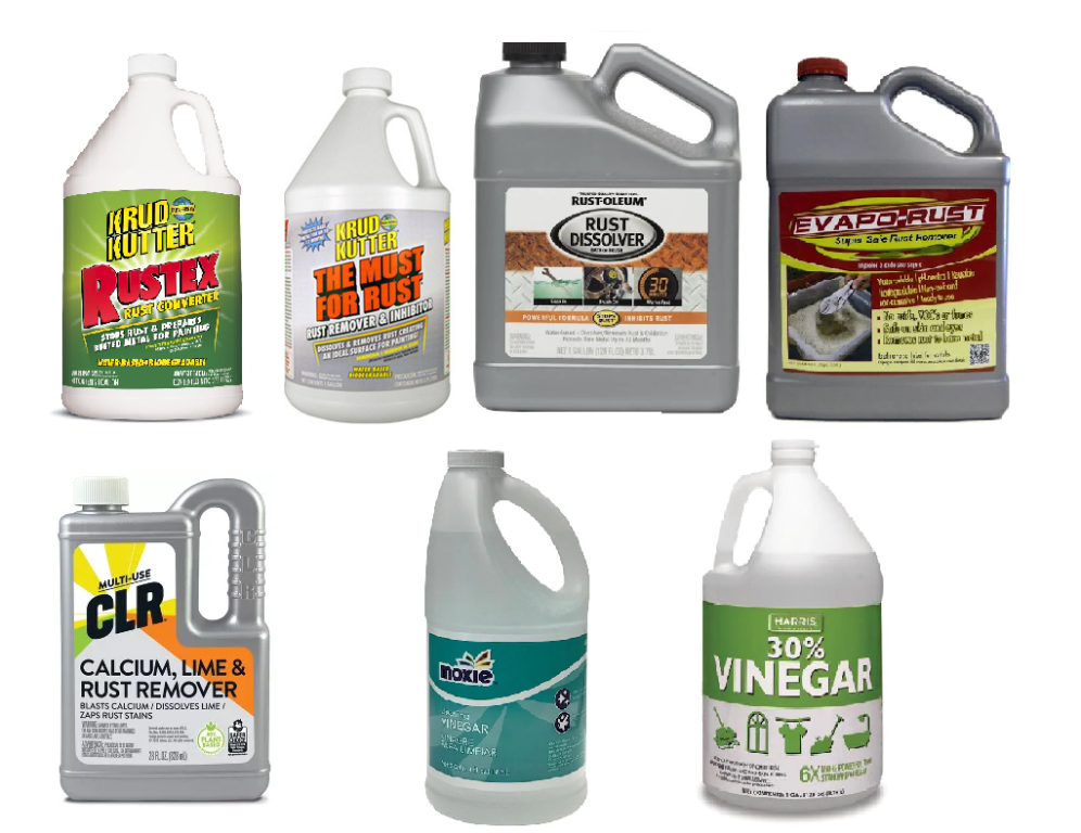

Re: CLR, thermocure or evaporust?
I have used all of the pictured products for rust removal except for the 30% Cleaning Vinegar. I did not find CLR to do a good job on rust but use it to clean (short soak) Copper and Brass. Rustoleum makes the Krud Kutter products and as far as I can tell "The Must for Rust" and "Rust Dissolver" are the same solution in a different container. All 3 of these products are phosphate based. I did an experiment with RUSTX, THE MUST FOR RUST. EVAPORUST and CLEANING VINEGAR using similar rusted items. All 4 produced the similar results, however EVAPORUST took the longest and the Cleaning Vinegar began to show some oxidation after a few hours. My preferences are the Krud Kutter products and for something like a head I'd used Cleaning Vinegar because it does a great job and is very inexpensive and no need to seal the metal as the other products claim to do (going to try the 30% some time.) To make these products last longer, it helps to de-grease and remove dirt off the parts first. Also transferring the solution after use to another clean container leaving the residue behind will also help.
What the manufacturers say
Krud Kutter®Rustex™Rust Converter is a rust inhibiting coating which converts rusted metal overnight into a rust retarding, paintable surface. When applied to rusted surfaces,iron oxide (rust) is chemically changed to ironphosphate, an inert, hard substance that turns the metal black. This increases the paint adhesion, and durability of the coating
Krud Kutter® ThMust for Rust - Rust Remover & Inhibitor
The proprietary formulation penetrates into every void of a metal surface and dissolves rust/oxidation through chemical action. Then tiny, rust-inhibiting crystals are formed and become integral with the surface molecules of the metal to resist future rusting. The corrosive agents attack these crystals instead of the metal. Once completely dry, the surface is ready for the next step, whether it be painting, welding, plating, lubricating, etc. Or simply leave the surface bare, and the crystals will inhibit future rust formation.
Rust Dissolver
Quickly penetrates every void of metal surface to dissolve rust FAST! The powerful, proprietary formulation takes the hard work out of rust removal and transforms surfaces to like-new condition. Rust-Oleum® Rust Dissolver Bath is a specially formulated water-based product designed to dissolve and remove rust and oxidation on a variety of surfaces. It is suitable for use on iron, steel, aluminum, chrome, galvanized metal, porcelain, tile, fiberglass, glass, auto cooling systems and firearms. Apply by brush or as a bath
EVAPO-RUST® rust remover is an environmentally-safe water-based product that removes rust in minutes, without scrubbing or sanding. It’s so easy to use, anyone can restore their rusted tools, auto parts, hardware, cookware, and even firearms to like-new condition. Since Evapo-Rust® Super Safe Rust Remover is reusable, one gallon will remove 1/2 lb of dry ru
Rust Dissolver
