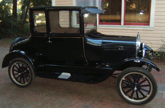

The passenger side door on my 1926 coupe sags a little so that the body belt on the door is about 1/4” lower than the body belt on the body. It does, however, latch properly. I need to raise the door so the the belts are even. What is the method by which this can be done? I am thinking that the top hinge can be bent slightly forward and the bottom hinge can be bent slightly toward the rear while the center hinge remains the same so that the door tilts upward, but will continue to latch properly.
Is this feasible? I seem to recall reading somewhere and seeing this done in an old period photo with a special tool that I recall had a long handle. What say you? I’m not going to try it without more information, advice and opinions. Jim Patrick

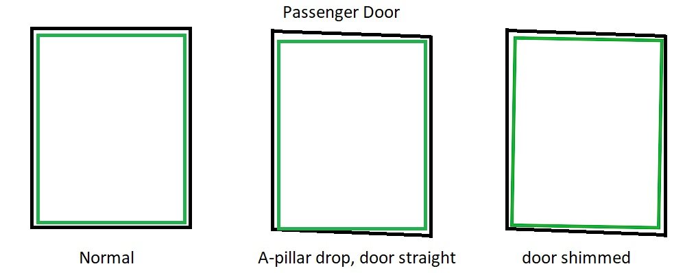

You really need to to see if the pillars are plumb and the top is level to see what the real problem is. Otherwise, you may end up with this.
The real fix is bending the frame back up or wood blocks between the body and the frame until the next full restoration in years to come.
