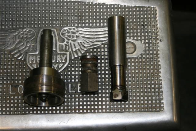

Hayes made a special puller for the rear. Screws in like hub cap and pulls wheels. Dan

Posted on an old thread by Mike Bender http://www.mtfca.com/discus/messages/29 ... 1176499853

My son made me a puller. It is a simple thick steel disc with the hubcap thread machined on the outside. He heavily welded a large nut on the outside and this is used to screw the unit into the wheel. A bolt screws through the large nut to register on the axle to provide the 'push' to get the wheel free.
It works like a charm, and I have since found out that a factory Hayes puller works the same way, except that the hex to screw it into the wheel is part of the Machined disc.
