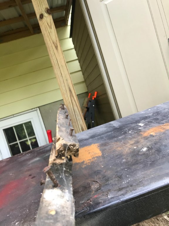

Here's part of my original Sills on my Centerdoor. If you look just beyond the screw, you can see the joinery used to put the wood pieces together.

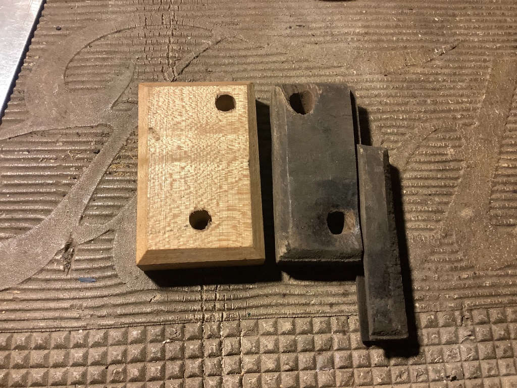

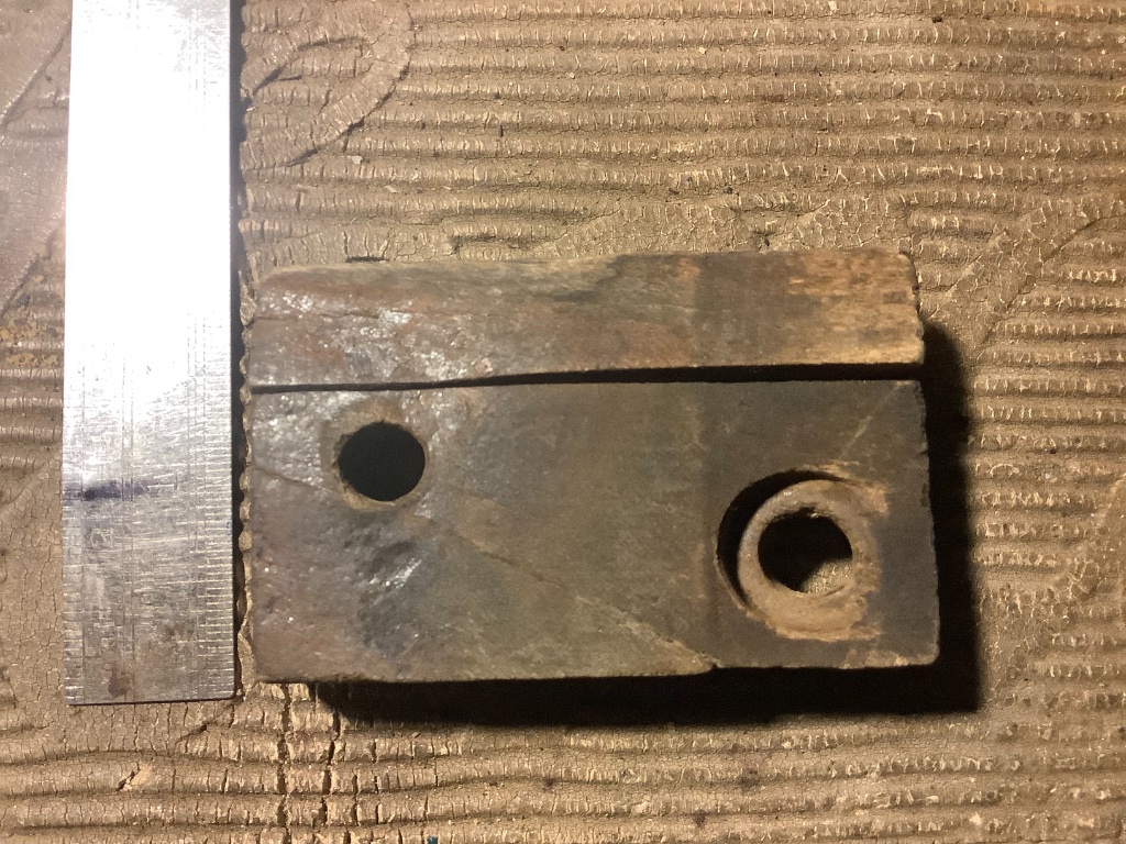

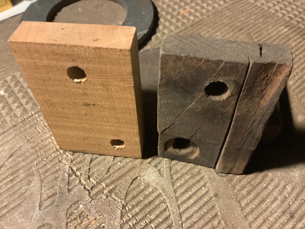

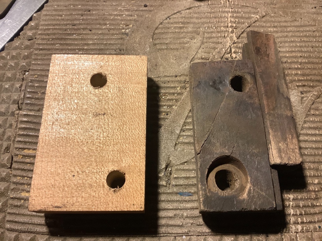

Here is a small ford wood part with the linderman joint. You can see why they haven’t been seen much from this specimen. My speculation that wood boards were made from scrap, and machined into smaller parts. Too small for this operation , it was charcoal time, baby. Note the angled, counterbore hole on the original jointed hood block. Two different hole diameters, also.
