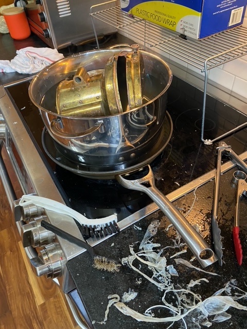

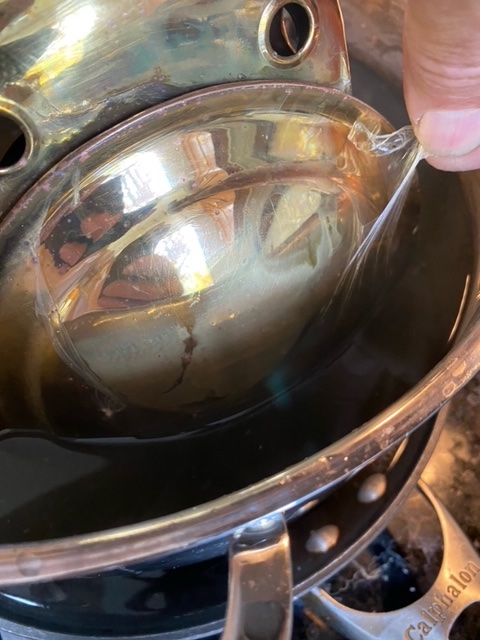

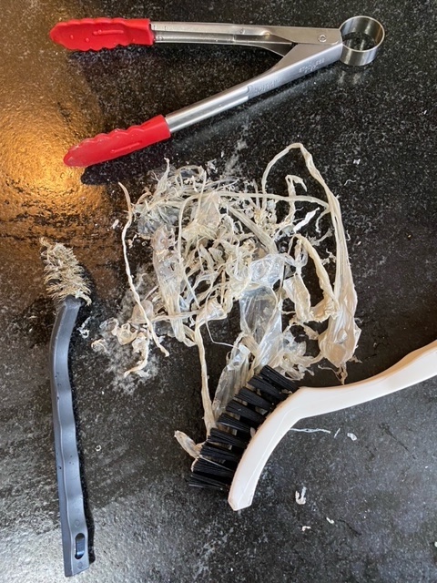

Tom advised me to submerge my failing clear coated 1911 brass in a pot of heated vinegar and, just as he said, the clear coat fell off like a cellophane wrapper. His brilliant solution turned a full day using solvent over and over again on only one cowl lamp into stripping completely clean three lamps in only 2 hours. Thank you Tom Zimmer.
As you can see in the pictures, I used a large frying pan full of water to double-boil a lobster pot full of vinegar. Upon reaching temperature the clear coat delaminated in only 1 or two minutes. I helped it off with a soft brass wire brush and small tongs. This was way easier that I ever expected. However, I should have added to the process some thick dishwashing gloves and full coverage lab goggles.

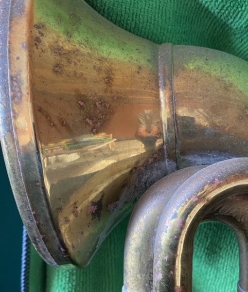

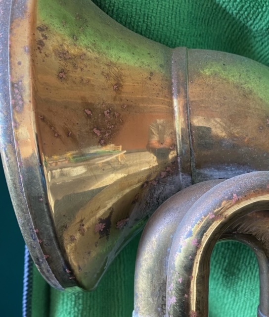

Hello fellow Model T-ers,
I am frustrated. Almost all of the brass on this 1911 Touring was coated with clear coat. Then, the car was left in the sun for 3-1/2 years, so an unnatural tarnish formed under the clear coat (picture #2).
Im using this chemical (picture #1). It is the strongest stripper I can find here in Northern California. However, it takes a minimum of 6 separate ‘applications and removals’ (15 min soaking each time) to get even close to removing the clear coat.
Would any of you know of an easier way to accomplished this?

Steve, I had the same issue with my 11 t. I went to Costco bought a couple jugs of their vinegar. Use a plastic bucket, totally submerged. 1st time I heated the vinegar up prior to using, but I found leaving bucket in the hot California sun provided enough heat. Need to leave it most of the day, but you need to check it occasionally. What happens is the old baked on clear coat begins to break down and eventually it comes off in sheets of old clear coating. I did all my original brass. Hope this works for you. I also used a buffer at the end to get at hard to reach areas.

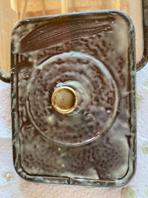

Previous (pre-vinegar) photos.
