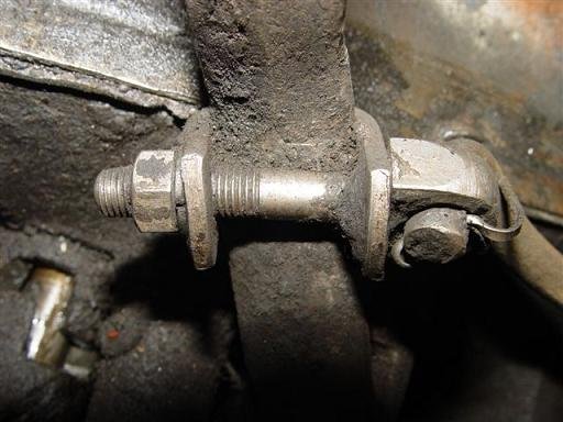

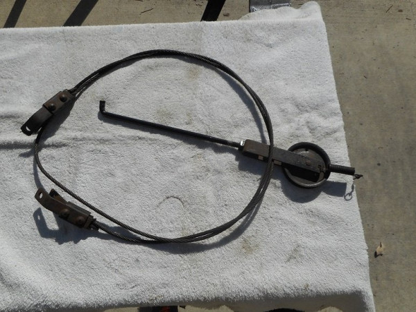

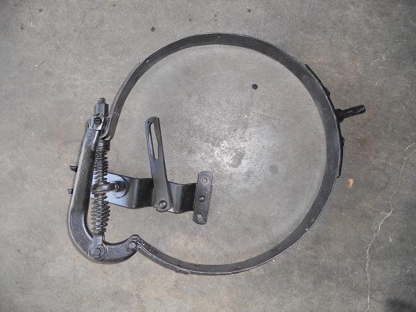

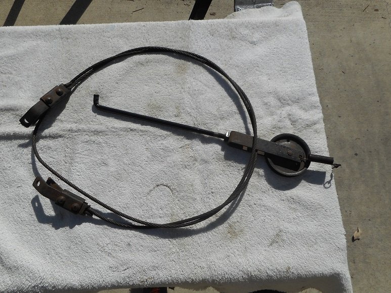

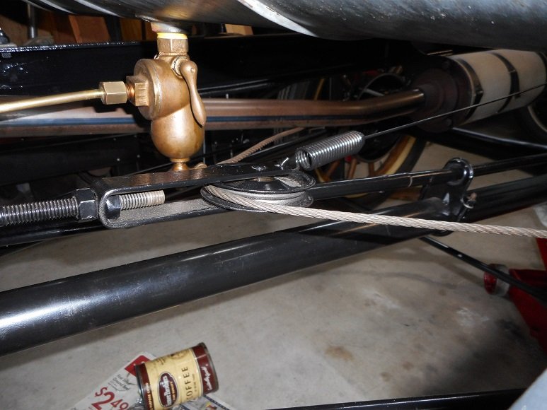

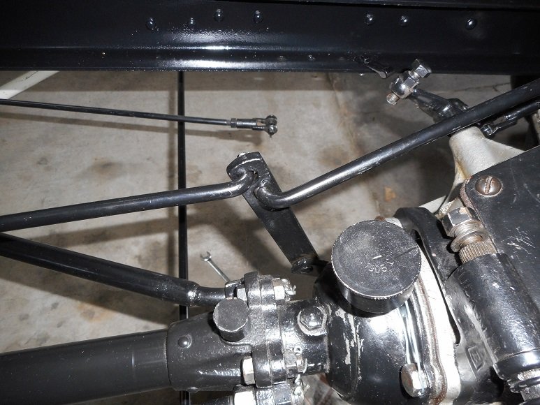

For those who have been around long enough to remember, Bud did not make the first style Rocky Mountain brakes. Jack Sunderlin made them. Jack was NOT a mechanic, and failed to put the adjusting cams on the brake bands. He also had no idea what the equalizer looked like, so instead of doing the research on what the part really looked like, he chose a Bennett equalizer, which is totally incorrect, and works with rods instead of the correct cable equalizer. When making a reproduction part, it pays to know what you are doing before offering the parts for sale!
Posts: 3960
Location: Lomita, California
Re: Rocky Mtn. Brakes Exploded Diagram
Post by Original Smith » Tue Aug 10, 2021 11:04 am
I will attempt to post the correct parts over the next few days.

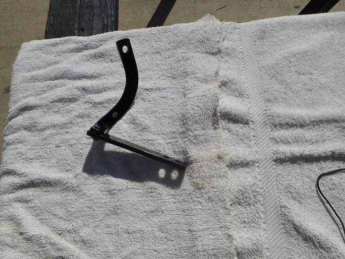

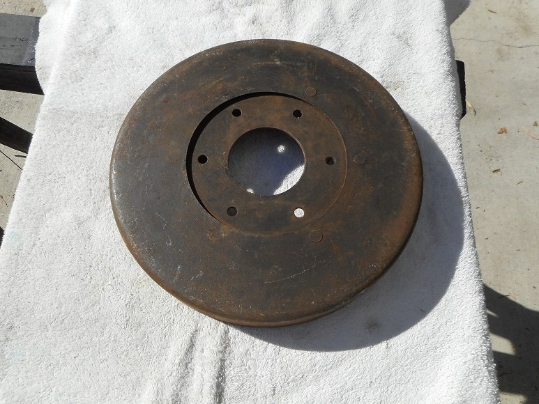

Here are some additional photos:
Brake Band.JPG (53.71 KiB) Viewed 2955 times

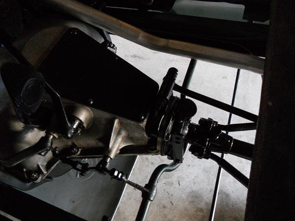

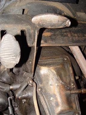

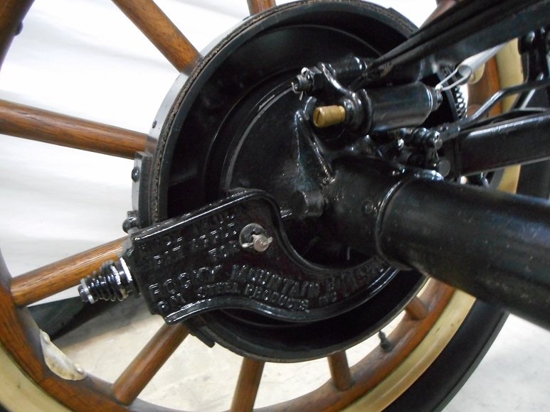

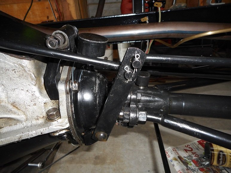

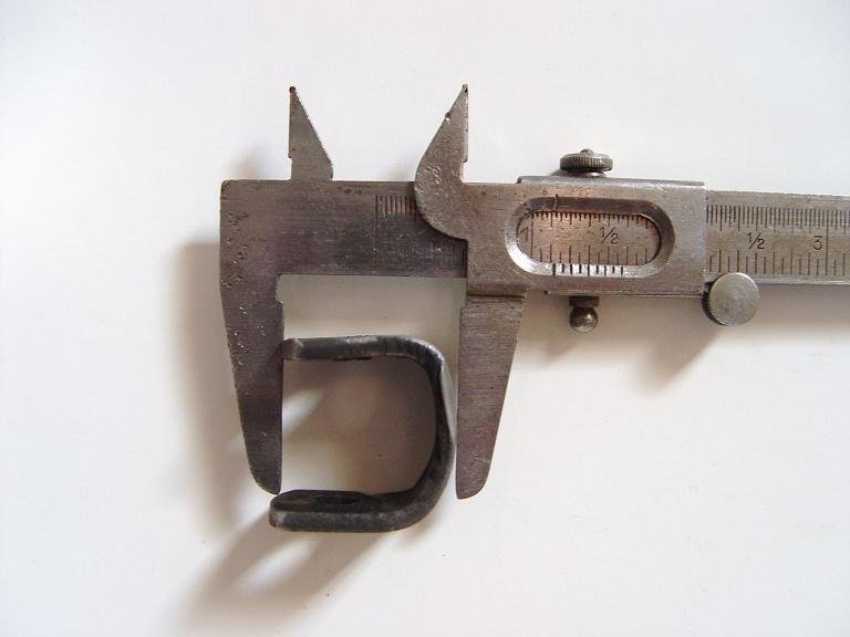

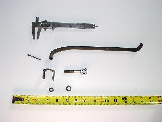

More photos:
Rocky Mountain Brake4.jpg (35.37 KiB) Viewed 2879 times
RM Clamp 1.jpg (41.07 KiB) Viewed 2879 times

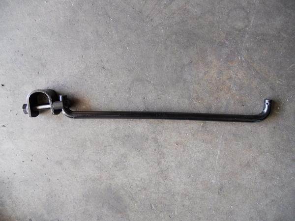

Pedal Clamp & Rod.JPG (48.59 KiB) Viewed 2879 times

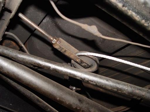

Bell Crank.JPG (47.97 KiB) Viewed 2879 times

Post by Original Smith » Thu Aug 12, 2021 11:33 am
That does it for now. I think it's easy to see why the original design is so much simpler that what is available now. There are a few of us who are fortunate enough to have these brakes. Just last year, I really lucked out and was able to purchase an original never used set of these brakes.
