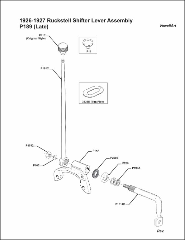

Post by VowellArt » Sat Aug 07, 2021 5:05 pm
I was told that the Spline fitment was the later version of the P189A shifter, but since I don't see it listed anywhere, I can't really give it a part number other than to suggest if may be a "C" because P189B is the designation (by Chaffin's Garage) for the Pillow Block Left Hand Shifter Lever, so, I'm just going to give it a temporary part number pr P189.
If any of you guys know what the real part number is for this assembly I'd appreciate if you could post it here and I'll make that correction.

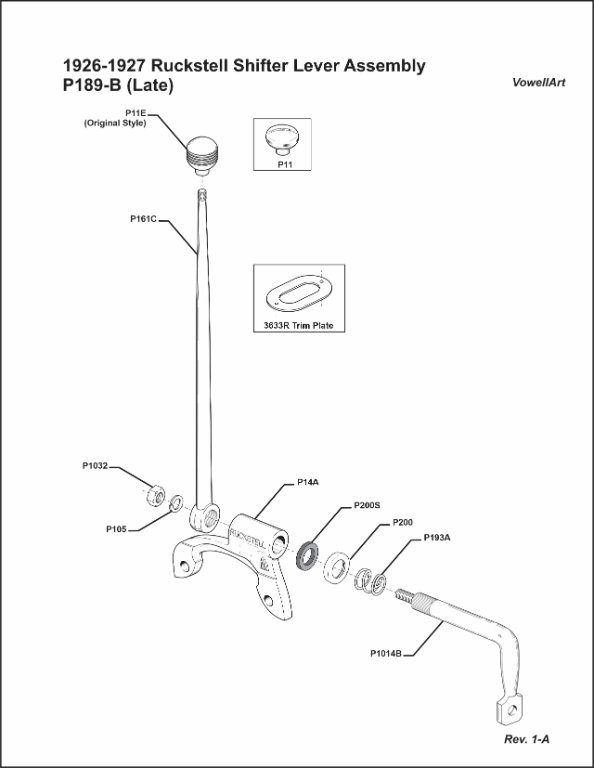

Post by VowellArt » Sat Aug 07, 2021 5:52 pm
Slight change

Post by RajoRacer » Sat Aug 07, 2021 7:02 pm
Great Job, Martynn ! I'll pull mine apart again but I don't recall seeing any numbers - there was a casting symbol on the shifter handle, I believe - I'll check.

Post by VowellArt » Sun Aug 08, 2021 7:53 pm
Dan Treace pointed out that the proper designation for the spline shifter is P189-B....don't go expecting to get a spline shifter from Chaffin's Garage under that part number, because that is the number they use for their Pillow Block left hand shift assembly.
