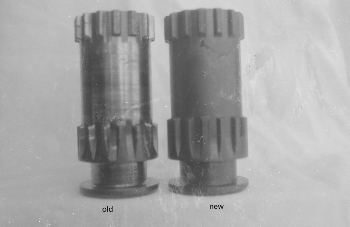

Luxford
- Posts: 300
- First Name: Peter
- Last Name: Kable
- Location: Australia
Re: Ok ruckstell experts here's one for you
May be this, check out what a new ones length of the teeth is with Chaffins.

- Posts: 4694
Three things to look for.
1. Length of teeth on sliding spline as shown in the picture posted by Luxford.
2. Sometimes someone will file a groove in the shifter so that it can be set between Ruckstell and High. In that case, by moving the shifter either all the way back for Ruckstell or all the way forward for High should keep it in the intended gear, but do not stop partway or you will find neutral.
3. This one I actually had on a Ruckstell I installed on a car. The shifter fork was not in the groove in the spline when the shifter was installed, so it didn't move the spline.
Anyway, other than filing a groove, the only natural way for it to happen would be number 1 which happens over the years if the engine speed is not synchronized with the axle speed causing it to grind when you shift and wears out the teeth on the spline and also on the internal parts.

In high gear, the P146 slider locks the P139 Bronze bearing carrier to the P145 Planet Carrier Plate so that the planetary assembly cannot rotate separately from the ring gear carrier. If you re going into neutral AFTER shifting to high, that has to indicate that the end of the P146 slider is disengaging from the P145 Plate. So a few thoughts- the P122 is pulling the slider too far for some reason (per Johns comments above) OR 1) the splines on the end of the P146 Slider are worn and/or 2) The internal spline teeth on the in the P145 plate are worn or 3) the fiber washer P171A, that controls the internal side play of the planetary assembly has disnetegrated and is allowing the P145 to move over enough to disengage from the end of the P146 Slider teeth. One quick check for #3- how much axle end play do you have- if it seems excessive the P171 washer may be the problem- more so if the other parts have worn. Good luck!

Could be, we assumed he had tried it with the shifter installed and was getting the same results?
But you know what they say about assuming!
Maybe if the shifter had been installed (suggested in a round about way and directly by several people) he would have found no issues, and this whole matter could have been laid to rest early on. (or if it was, did not come out and say it)
Glad it was sorted out, but in my OP, I think he came with a chip on his shoulder and then copped an attitude towards people trying to help, because right or wrong, that is what they were trying to do.
Wishing you happy trails
Mark
- Posts: 5268
4th post, I suggested shifting into position & removing to see where the lock sleeve was. That was based on the OP where I interpreted the innards had been checked as stated. Shifter position is the only possibility. Late in the game, we find, its not been actually checked to the extent necessary internally. Some one early on suggested the fiber washer was gone. I dismissed this in my mind from what I thought was said to be ok. In retrospect, that is a good guess. With my familiarity with rux builds, If it aint the shifter, There are serious issues & stuff is way out of spec. Guessing that the fiber washer is gone & chewed the castle base needing re-machining & a much thicker fiber washer to stop the internal sliding of the differential as a pinpointed answer is not important. It has to come apart. Until it is apart, one cant blindly determine the exact few or many parts to rework or replace.Mark Gregush wrote: ↑Fri Aug 13, 2021 2:15 pmThe problem, maybe, for some of us, me included, we did not pickup on the fact he was sliding the clutch gear back and forth "WITHOUT" the shifter in place, and was not trying with it installed. With the teeth all lined up, the clutch gear can be slid all the way out, the yoke and notches are what hold it in place.
Mark

I would take the shifter out of the rear end and shift it with a screwdriver or something similar. You may find the problem. The fork on the shifter may have come loose and not shifting it far enough. You may find something not so easy . Good luck!

In regards to the problem it was sourced, repaired and is not back in perfect working order. No new parts were needed, no book was needed just a few pointers from a couple members.
