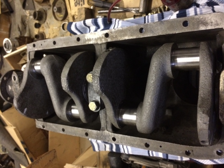

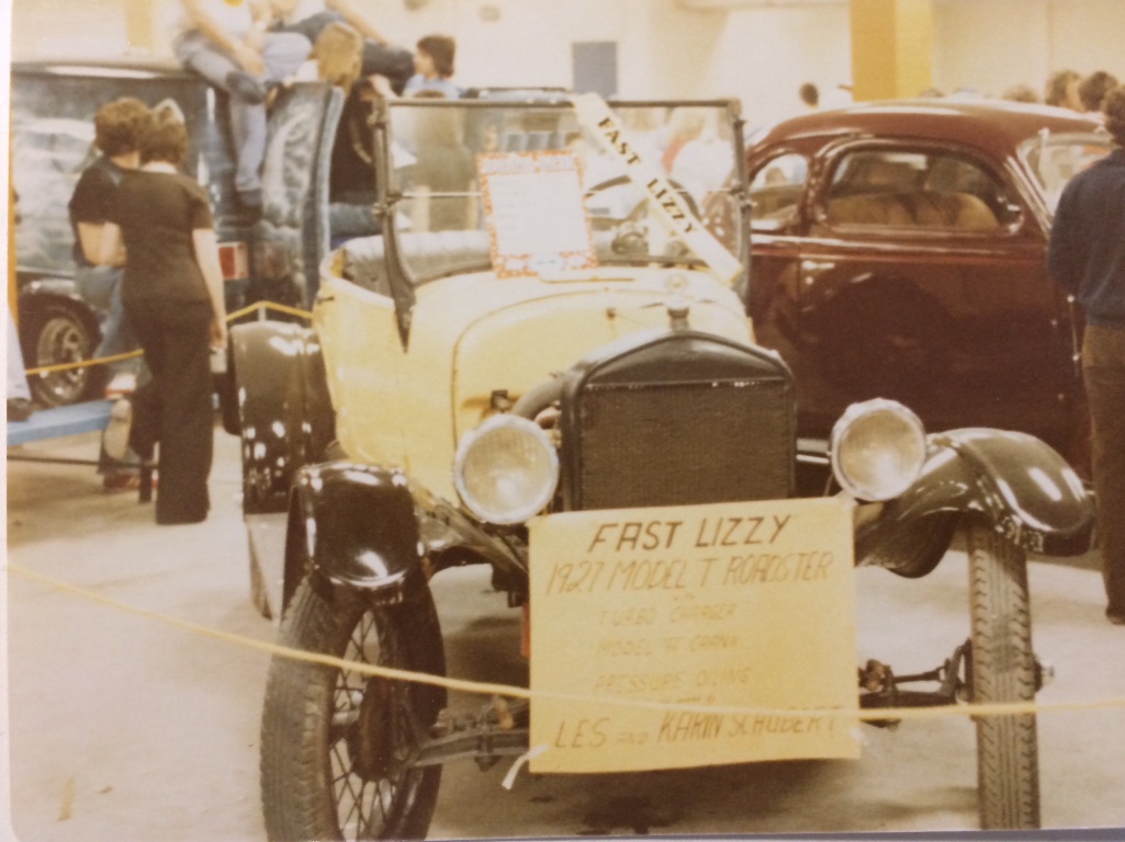

The engine bottom end
A couple of pictures of a turbocharged T I built in the ‘70’s. The engine is still running, but I removed the turbo and went with a Stromberg 97

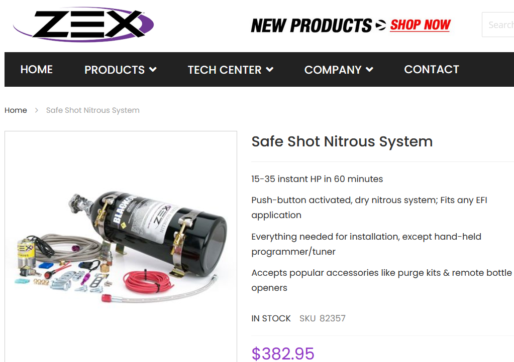

There may be a misunderstanding about NOS systems. Advertising sounds like they start producing 200hp to 1500 hp+p. In reality the hp gain can be regulated to say just 5 more hp. But if your selling system who would spend $400 to gain an occasional 5hp
Here is a system https://www.zex.com/safe-shot-nitrous-system-cpg.html proving 15-35 hp gain. So the question is how much additional hp can a stock T engine handle, regardless of the method used to cause the increase

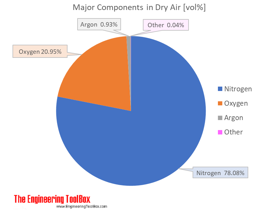

When nitrous oxide decomposes....it allows an oxygen concentration of 36.36% to be reached. Nitrogen gas is non-combustible and does not support combustion. Air—which contains only 21% oxygen, the rest being nitrogen and other equally non-combustible and non-combustion-supporting gasses—permits a 12-percent-lower maximum-oxygen level than that of nitrous oxide. This oxygen supports combustion; it combines with fuels such as gasoline, alcohol, diesel fuel, propane, or compressed natural gas (CNG) to produce carbon dioxide and water vapor, along with heat, which causes the former two products of combustion to expand and exert pressure on pistons, driving the engine. Nitrous oxide is stored as a liquid in tanks... when injected as a liquid into an inlet manifold, the vaporization and expansion causes a reduction in air/fuel charge temperature with an associated increase in density, thereby increasing the cylinder's volumetric efficiency. As the decomposition of N2O into oxygen and nitrogen gas is exothermic and thus contributes to a higher temperature in the combustion engine, the decomposition increases engine efficiency and performance, which is directly related to the difference in temperature between the unburned fuel mixture and the hot combustion gasses produced in the cylinders.
This chart about the air we breathe may surprise some folks

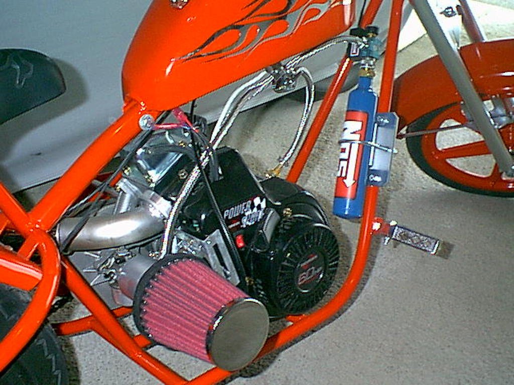

Post by henryford2 » Sat Aug 14, 2021 9:57 pm
Added it to a mini chopper I built for my son long time ago (when the chopper motorcycle was the big thing) Enjoy

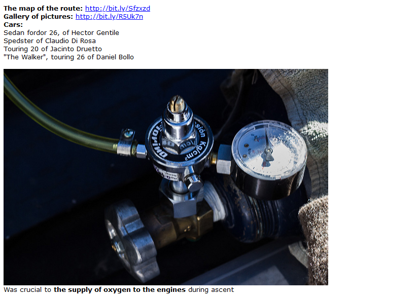

If you did that, there is no doubt that it can be done to a T. And if they added Oxygen for the climb to the top of Abra el Acay in the province Salta, Argentina, just 16,000 ft above sea level then ........ http://www.mtfca.com/discus/messages/41 ... 1400256343
The ride up https://www.youtube.com/watch?v=wLdh1ghE7Qs
The Oxygen tank hook up.. https://www.youtube.com/watch?v=xU7lXosh2ns
