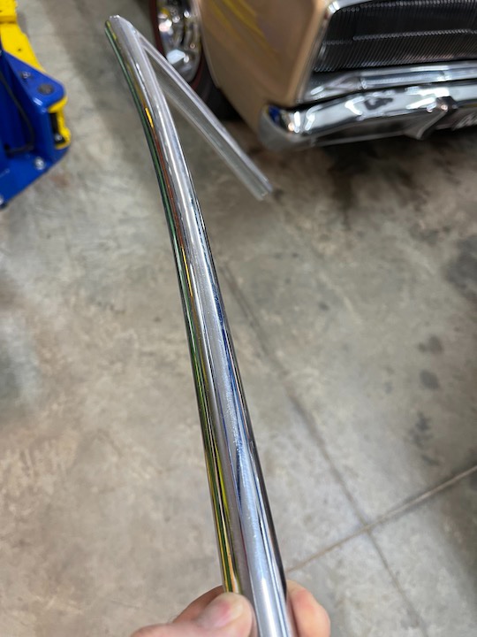

So I'm going to start putting the windshield together soon and I was looking at a car as a model. Take a look at the rubber gasket in a grove on the bottom of the frame.
Now take a look at my frame. There is no grove in the frame. Did the nickel ones not have it?

I would think all the original ones had the groove. You may have a repro there.

Could be but I'm not sure how to tell.

You can tell by the lack of groove.

I betting it's a reproduction. Yes it's chrome along with the windshield side supports and hardware. Could be for making a speedster. Thanks for all the info.
