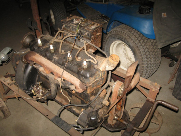

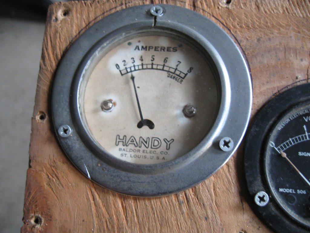

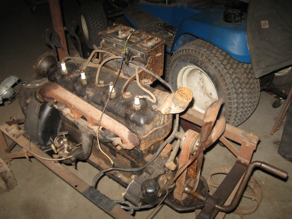

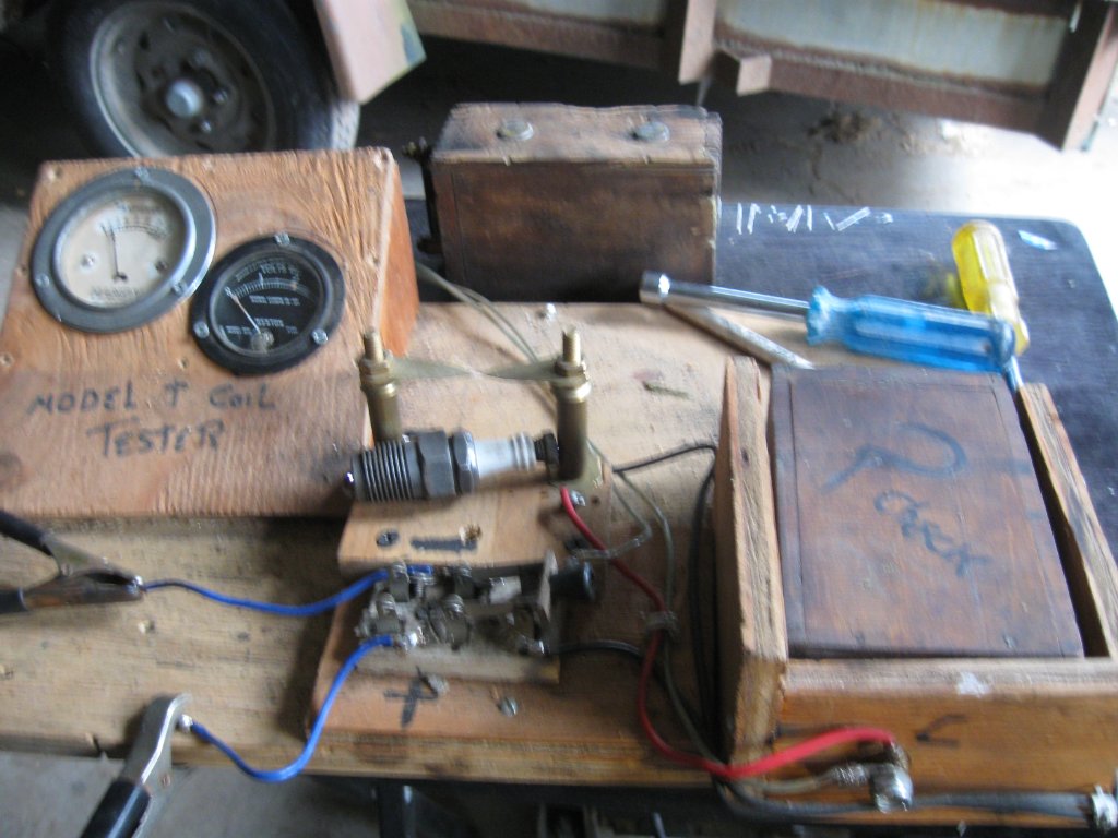

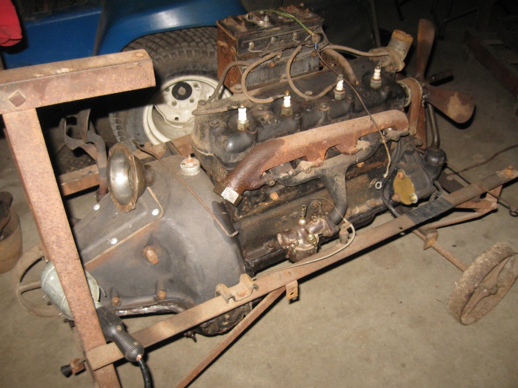

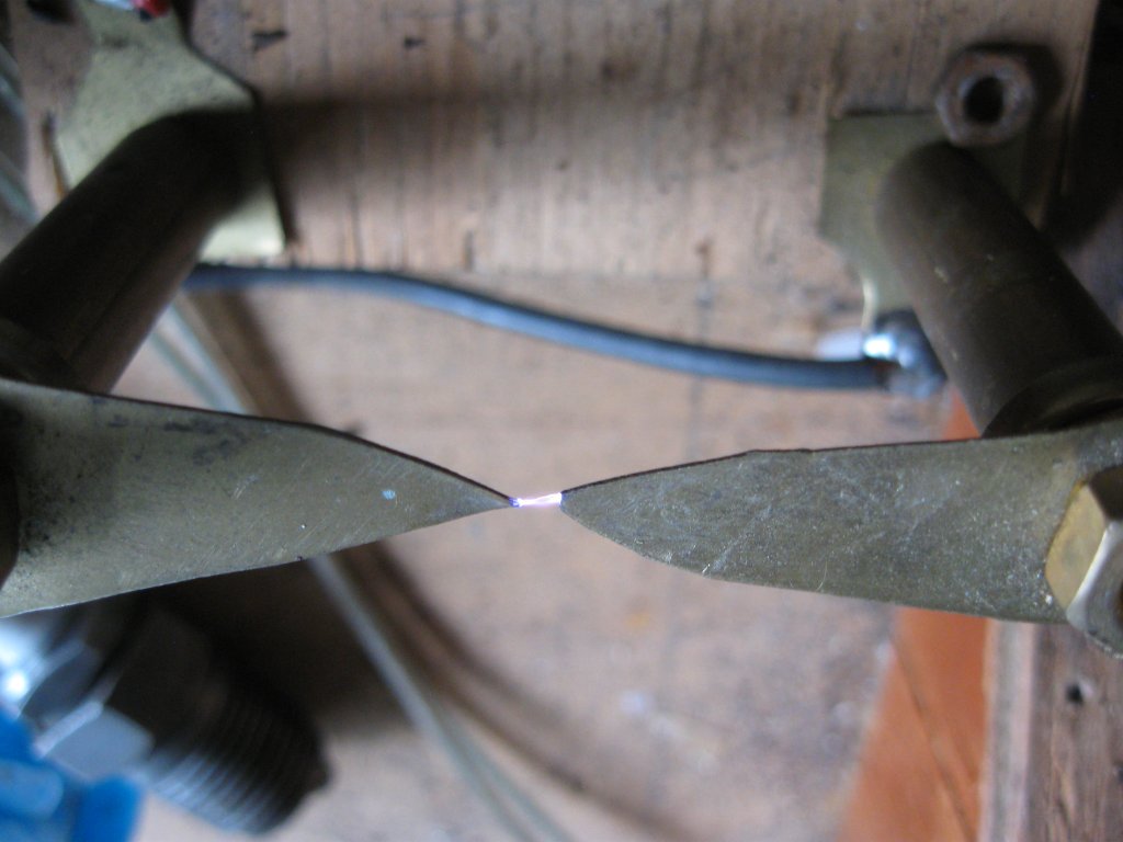

is there any fixin to the rubber coated coils?- i've been going through a bunch of coils getting them in working condition rather than letting them set around collecting dust, i found one that's coated in what looks to be plastic,and no way to open it,is this like all other [new] stuff-a toss out,or is there a way to make it buzz again, here is some pictures of my system i built years ago to keep my ford buzzing.the 25 engine i'm getting ready to take to a show, its been setting for years, i'm going to bring it back to the living the 25th of this month, thanks for your help, [hate to toss any thing ]thanks to Bill Harper for the hogs head, we will hear another coughing back to the running.
