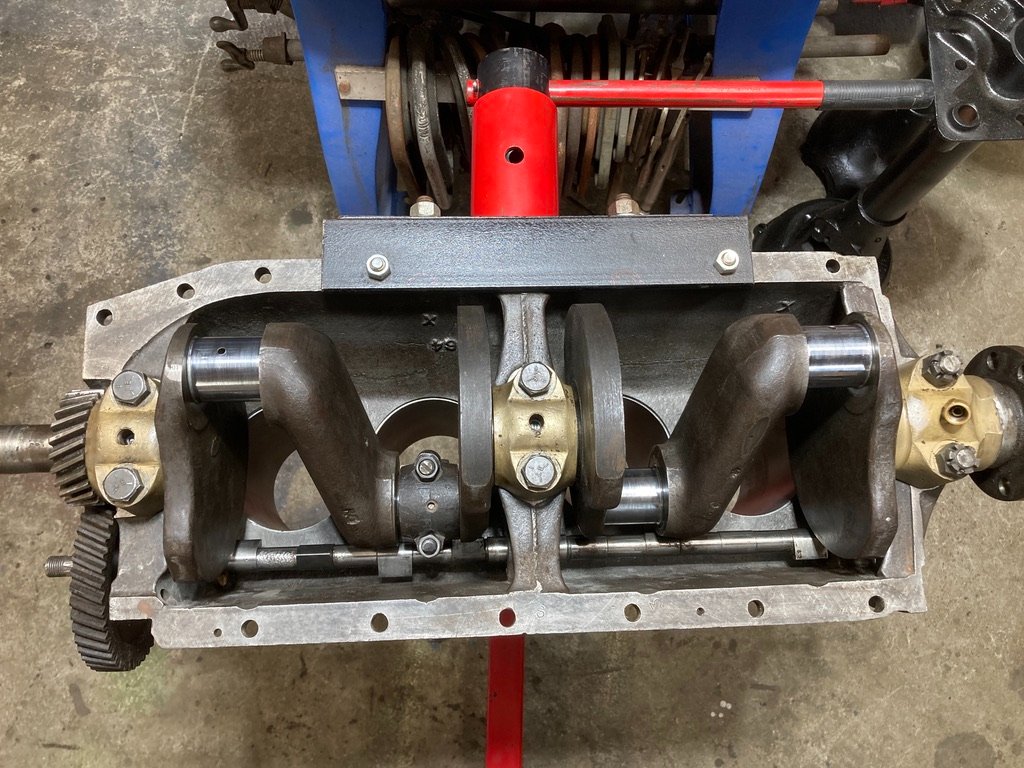

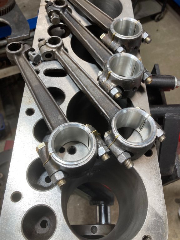

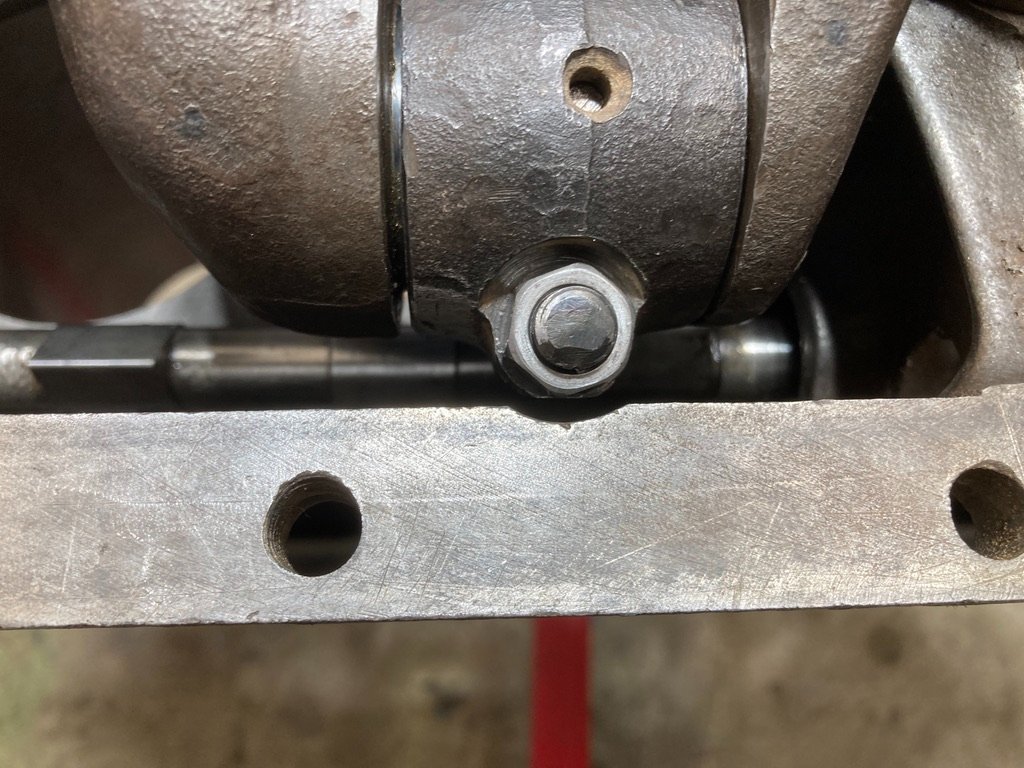

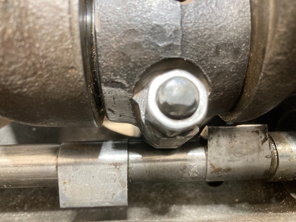

Just some updates on the progress (or lack of) on the Orville Enyeart engine built for Andy Mounce. I've posted before, but as originally built the bore was 3.8750" and the stroke was increased to 4 5/8" by using a Model B crank and grinding the main and rod journals offset to Model A specs and using a 7" connecting rod. The engine when I got it appeared to have broken a ring and destroyed what I expect were custom Egge pistons as well as scoring the already oversize bore. I had Joe Bell pour new babbitt and the engine was sleeved to standard, now the engine is only 204 cubic inch. A lot of close fits with the cam shaft and the connecting rods when you move everything down and close to one another. I'll post more as work progress (rods are out for babbitting), hoping that by this time next year the engine should be together. I would like to solicit some advice on:

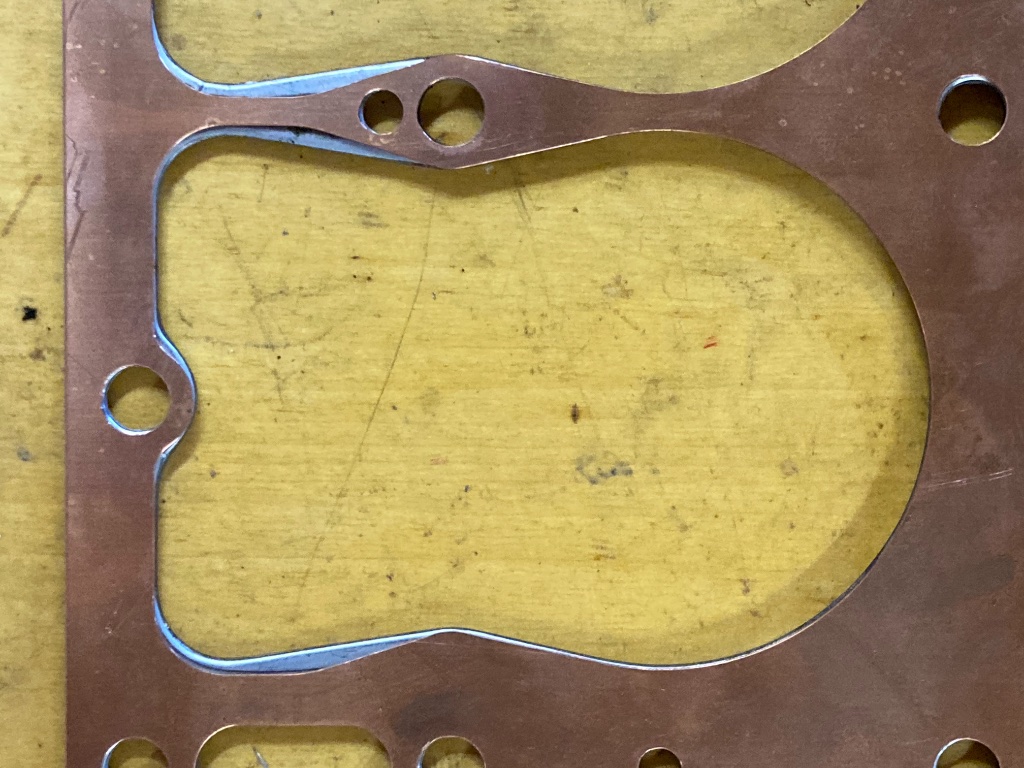

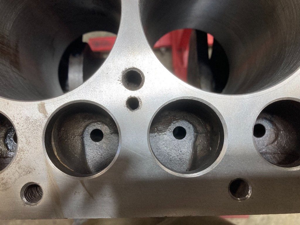

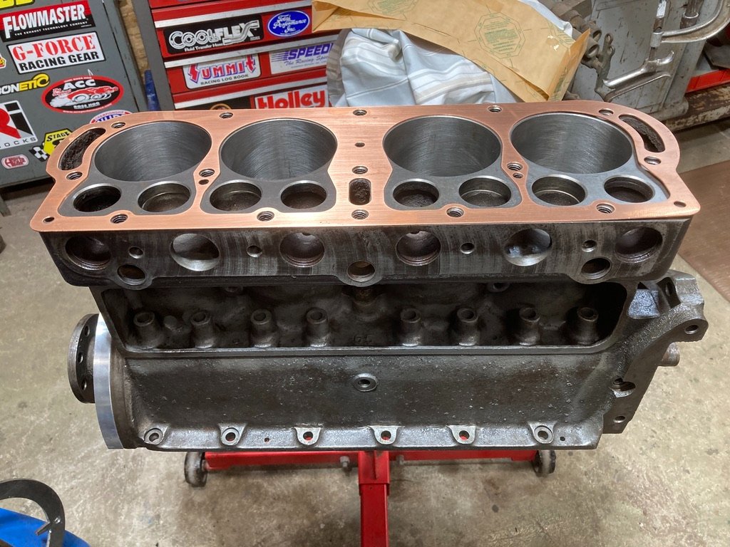

Solid copper head gasket for stock head. The intake valves are almost 1 5/8" in diameter so they interfere with a "standard" head gasket. Looking for side clearance on the rods between the crank throws on a pressurized oil system. Thanks

I’ve got a handful of these solid copper gaskets available. They are .040” thick and were designed to clear 1.720” valves on both sides. The pic shows the solid gasket on top of a new steel sandwich gasket

Kevin, email sent, that looks like the ticket, thanks

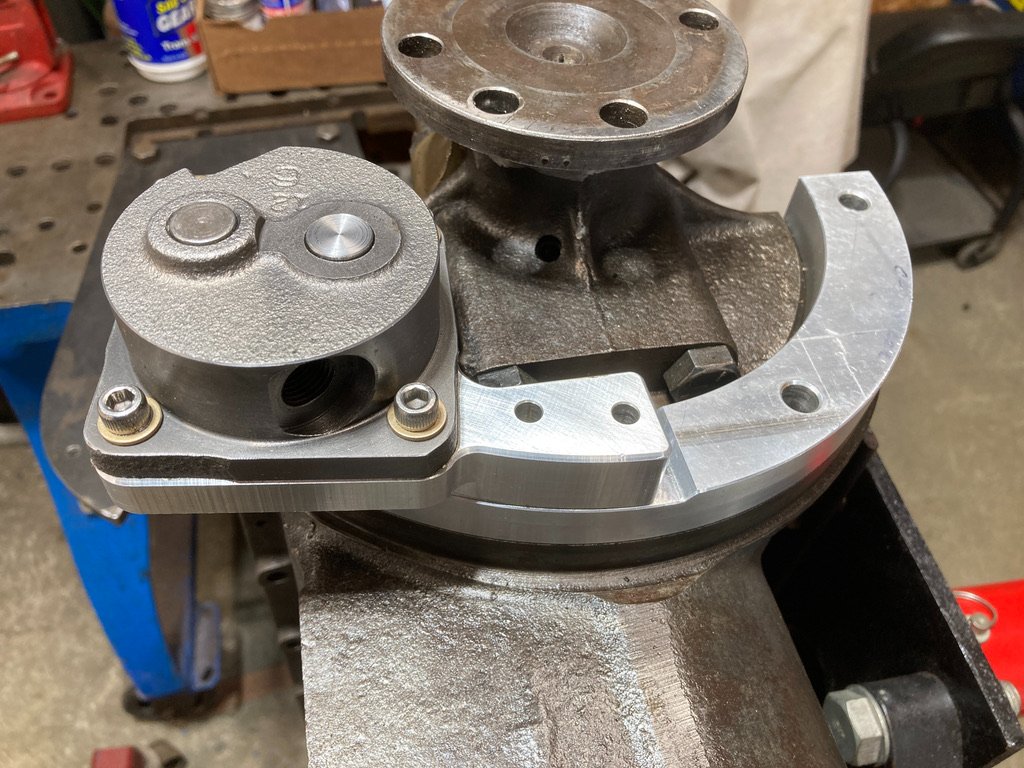

Last update for this year, the snow is starting to fall and the shop is not heated (intentionally)! Coincidentally, the engine was originally built in California and in a runabout way it's returning there. Joe Bell (Tiffin OH) for the babbitt and machine work, Dan McEachern (Alamedea CA) for the oil pump & spacers, Kevin Pharis (Orangeville CA) for the sold copper head gasket, Dude Green (Yuba City CA) for the rod work, Ross Pistons (El Segundo CA) for the pistons. Enjoy
