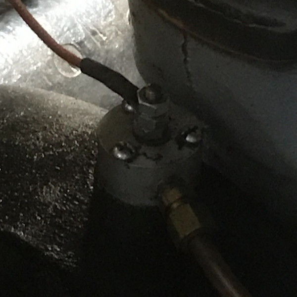

I’m helping a buddy with the ‘22 he bought. He’s been able to drive it about 200 miles, dealing with problems as they appear. It used to run good on mag, now the mag appears inoperative. It has an oil line attached at the mag post. Anybody have any experience with what the problem might be or suggestions as to how to proceed?
Posts: 8660
Re: Mag quit working-help!
Post by TXGOAT2 » Sun Sep 19, 2021 2:50 pm
I would check for voltage at the mag post terminal with the engine running about 800 rpm. Use an analog AC voltmeter. If you dont see voltage from the mag post to ground, the problem is likely the internal contact at the mag post. If voltage is present with the engine running, there is probably a problem with the wiring or the ignition switch.
Posts: 2331
Last Name: Juhl
Location: Thumb of Michigan
Post by Oldav8tor » Sun Sep 19, 2021 3:00 pm
Thanks. I checked the wiring and switch. Also tried a jumper from the mag post to the coil box with the switch off, bypassing everything. No go.
I don’t have an analog meter so with the engine running on battery I carefully touched the mag jumper to ground...no spark.
Are the three screws that hold the mag post threaded into the hogshead? We’re afraid to loosen them for fear of dropping a nut or something into the tranny.

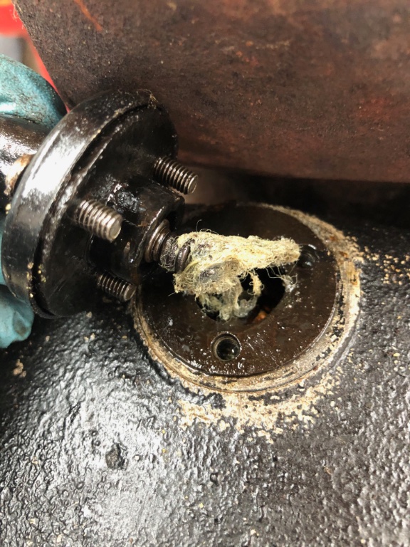

Post by DanTreace » Sun Sep 19, 2021 3:35 pm
Tim
Loosen the three machine screws and lift up that mag post. You may have to loosen and/or remove the oil line to the fitting.

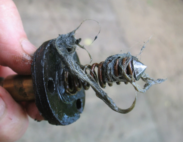

These have an internal spring, like a ball point pen spring, inside that pushes out the needle for contact to the coil ring solder blob. Check to be sure that contact is working.
Most times its crud causing ground and lost of AC power.
Here is one with Kevlar fuzz, excessive since the drums were filled with pits and sharp edges, that shredded the linings.

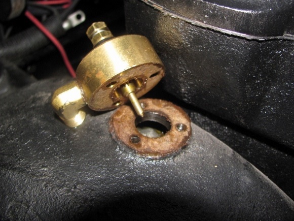

We removed the post and got a bit of a surprise. No fuzz.

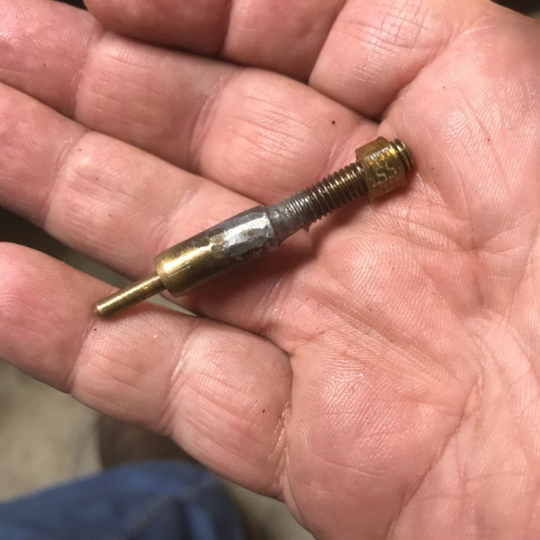

First, the brass spring-loaded post was off center and when removed appeared to have been repaired. It also has a little bend to it. It was insulated from the collar by what appeared to be a piece of plastic hose and two nylon washers...the inner one of which was half missing.

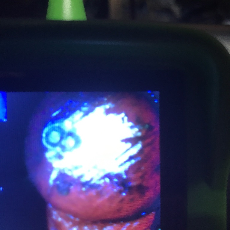

Looking into the hole with my cheapie borescope we saw two dimples in the contact surface. We think the post should be replaced regardless....should we worry about the contact surface?

The dimples in the contact button surface should cause no trouble. Just make sure it's reasonabley clean.

The dimpled contact surface usually means you have a older original mag ring that’s still working. The rebuilt ones I’ve used will usually have a newly soldered button. I think you’ve found your issue. Buy a new mag post with oiler connection and install it. One thing to remember with a new mag post with the oiler connection is to make sure the new fitting will install with your old oil line or replace the entire oil line oiler assembly on your car.

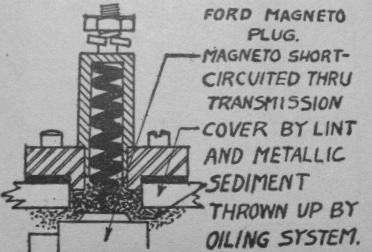

Someone mentioned metallic debris getting caught in lint at the mag post. I wonder if that doesn't explian some weak mag situations. I'd think metal debris in lint at the post and button would have a good chance of forming a resistive, or partial short that would ground some of the mag output, but not necessarily all of it. The result would be a weak output, not a dead mag.

My friend Gene and I want to thank all of you for the information. Model T's are certainly a learning experience. Gene is going to order a new mag post tomorrow so fingers crossed that it solves the problem. The one he removed had poor insulation - just a piece of plastic tube between the brass post and the aluminum collar and a couple of nylon washers. The post sold by Langs looks to be much better constructed.
