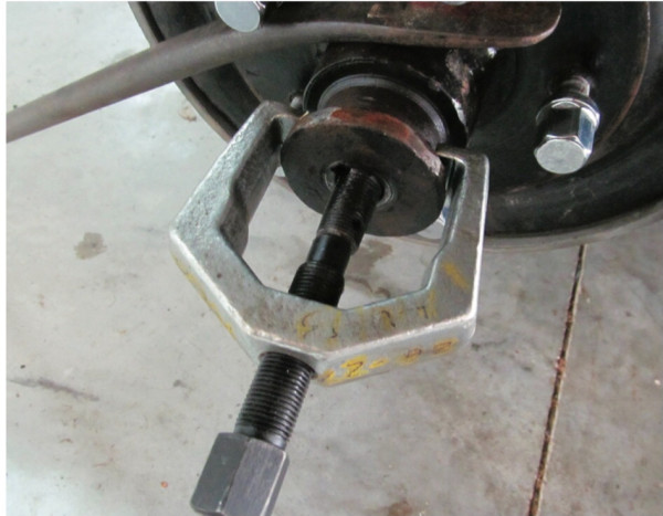

If you are using a Ford hub puller that screws on the hub cap threads and has a bolt that screws thru the end, it is a combination of tightening the bolt and hitting the bolt with a hammer many times, tighten more, hit more, repeat until the wheel comes loose. If you are just trying to remove the wheel by turning the bolt it isnt going to work. If you are using a cheater to apply more force to the bolt STOP or you will ruin the puller and or the hub cap threads. The jarring from pounding is needed more than the force of the bolt pulling. The wheel needs to be jacked up off the ground so as to not dampen the shock of the hammer blows and place any additional forces on the hub to axle connection. Get that wheel and axle vibrating and it is going to come loose. OK, so what to do if the hub cap threads and or puller are too damaged to continue you ask, use a wheel knocker. A wheel knocker is a large steel nut about 2 inches long that screws over the axle threads and seats on the end of the axle. Pounding it repeatedly with a large hammer not much bigger than a common claw hammer, will vibrate the hub off. If you need one PM me with your address and I will loan you mine. Do not use an axle nut as a knocker, it is too small and will ruin the axle threads.

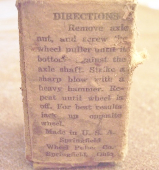

Try jacking up the opposite rear wheel with the wheel puller tightly in place, strike the center bolt with "authority" using an engineer's hammer. This method worked well for me on a hopelessly stuck rear wheel.

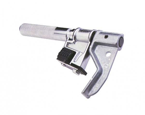

Here is a picture of a Ford wheel puller and a wheel knocker. Both work about equally well but take time and a lot of pounding. Everyone should have a wheel knocker in their on-the-road tool box.

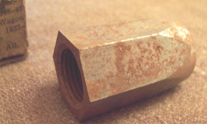

Some don't like the 'Knock-Offs". But they work for me on stubborn rear hubs.
The Knock Off threads all the way on the axle end, butts the axle end into the tool, so threads on the axle are protected.
Then lift up the opposite wheel with a jack.
Leave the stuck hub wheel on the floor, and whack that Knock Off tool with a big sledge head hammer , 3 1/2lbs. with 9" handle and give a quick, sharp swift smack. Swing it.
After two or three, sometimes more, that hub will 'pop' back off the axle taper with firecracker sound, and be loose again!.

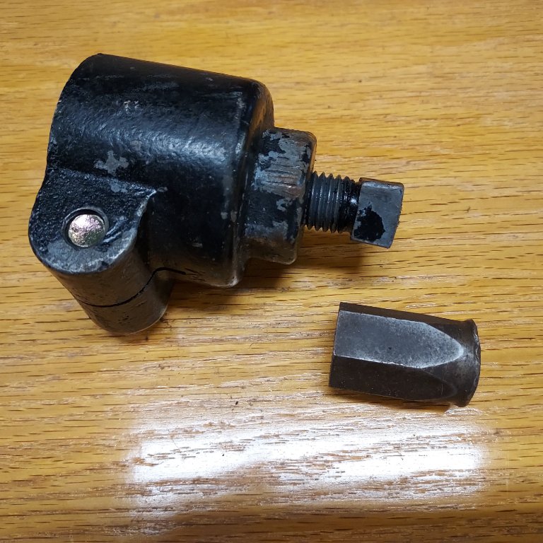

Steve, if you are able to get the crooked puller off the hub, you can use a thread file or a Stevens T-181 tool to clean up the hub threads. I have one of these that I bought on Amazon, but other places also carry it. It requires some fussing, but does an adequate job.
If the internal threads in the puller are toast, then a thread file or a new puller may be your only choice.

- Posts: 4042
Re: How to remove a stuck rear wheel?
Made this puller same way, after you turn the screw tight against the axle stub, then sharp fast whacks with a 3 1/2 lbs. 9” handle mallet works. Sometimes re-tighten the screw, but hit hard the end of the screw with a good fast swing, no taps, whack it! The hub will make a loud “Pop” sound and be loose then.d 100 ft/lbs and have been tapping around the nose of the hub with a small hand sledge hammer a couple of times a day for almost a week. No movement yet. Is there anything else to try? or should I just let time take its course…
Tire iron is jammed on floor to resist hub turning as you tighten that screw against the axle stub.
