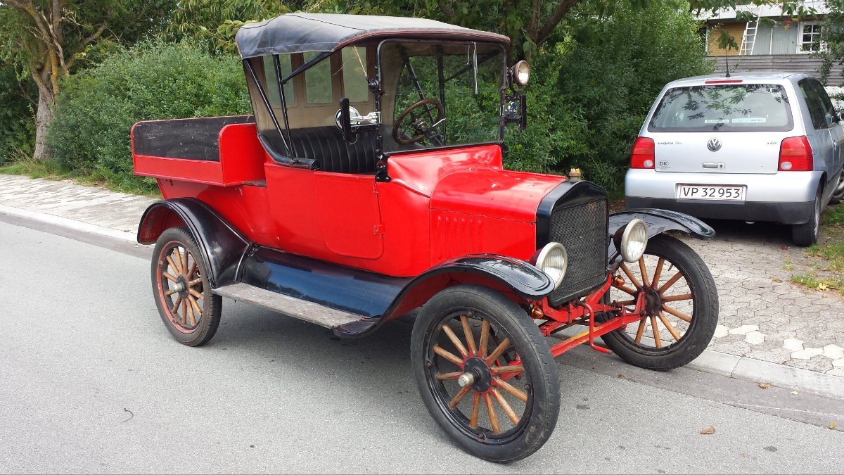

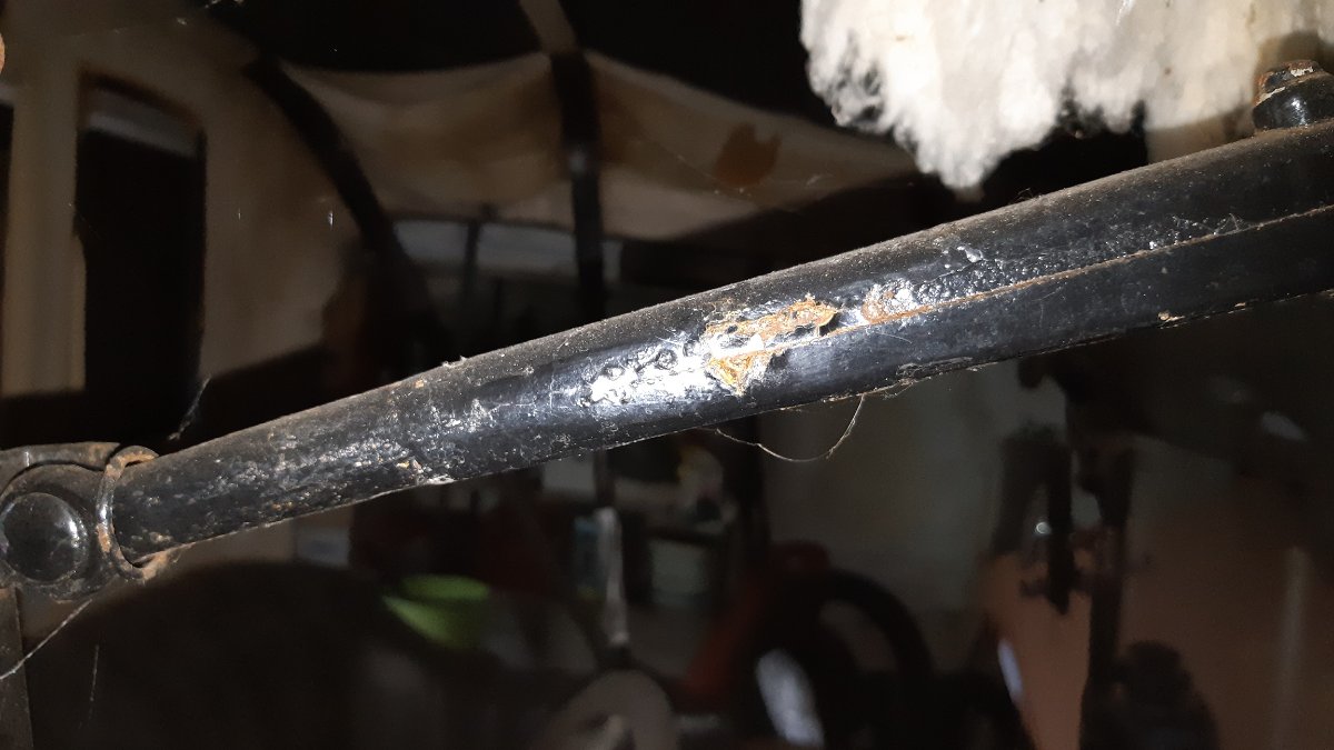

Hi,
my top irons on my roadster Pick-up are broken over - rust. It appears that there are wood inside the lover part of the irons and with some holes in the irons (missing fastners for side curtains I think) moisture and even water gets in.
Are any vendors selling new irons? I guess not as I have not been able to find them. And anyway I need to know what year my body is. It's titled as a 1921, but since I've been told that this car is build out of (at least) two cars, the body and hence the irons may be another year. So once I got the year (but 1917 - 1921/22 is the same?) my option is the classified and WTB? Or eventually try to weld and reinforce?

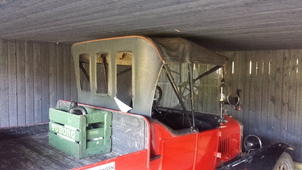

The bows you have are the round earlier style. Pre '18. The body is 17-22, so the rectangular profile bows would be more expected. BUT, before you plunk down the money, note this is a touring car body front half. Will a roadster top fit properly, or need some customization? I dont know that, but would not assume it would directly. Might take some comparison with a "real" roadster of similar year range.

Those are actually 1918-22 square top irons/sockets, not pre-1918 as someone posted earlier.
- Posts: 4694
Re: Top iron - what year
To me, they look correct for a 1921. There is some wood in the upper part of the bow but not all the way to the pivot point. The wood is just inside the part where the top material and pads are fastened. I had one break and a neighbor brazed it back together for me. The braze will not hold paint, and shows, however the bow has not broken since then. Maybe you can work some sheet metal into the area inside the area where it broke and then braze things back together. Your work might show, but will save you a lot of money. Other used bows might have worse issues than you already have. I have been working on a 20 touring for a friend, and we had to take about 4 sets of used bows to find enough good parts to make one for the car. New ones will cost you "mucho dinero". That's much money in English.

It is indeed a front half of a touring. The guy that made it claimed as I recalls it, to be a 1919 body.
It have some numbers in the wood. I'll take some pictures and start another thread for that.
I doubt that they have made a lot of modifications when they did the car back in 1963. The guy that build it died some years ago, so I'm unable to ask

A second closer look. They still look early on the right(optical dillusion?), but the middle bow does look flat (later style)

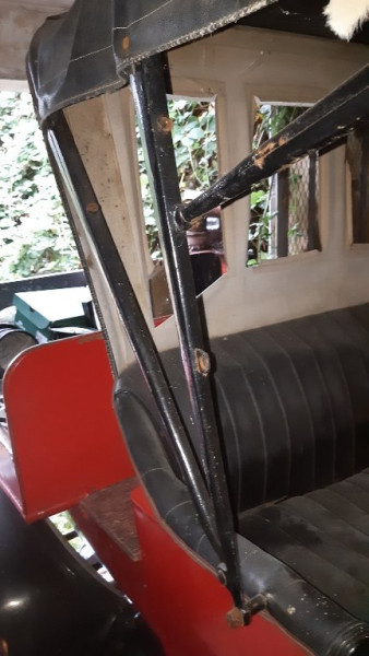

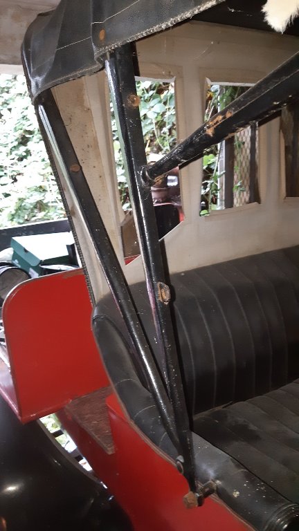

I went down in the basement (my workshop) and took some more detailed pictures. The ends are rounded, but center parts are square:

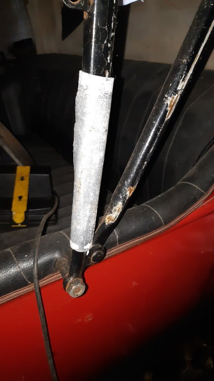

Here is my temporary repair:

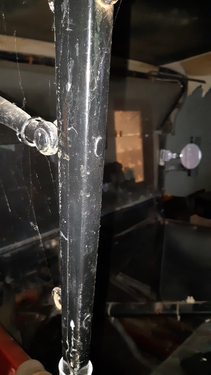

and there are other suspicious places I need to look into before breaking apart eventually:
Those are definitely 1918-22.
1915 -1917 are oval all the way up. Also, the first bow pin is inserted into the second bow eyelet from the inside, and there is a key/keeper on a leather strap screwed to the bow.
1918-22 are for the most part square/rectangular. The first bow pin is inserted into the second bow eyelet from the outside, and the wire keeper slides up and down on the bow as shown in your photos.

My 1917 touring has oval bows. I fished the wood pieces out of them and poured liquid epoxy into the tubes both to prevent rust and to provide strength. You might consider something similar if your sockets are repairable.
- Posts: 4691
For comparison purposes I measured the two top anchor points my on 1919 Roadster and 21 Touring. Those two cars should be pretty much like your car since they are in the same body style era.
I was thinking the two anchor point distances were the same but they are not.
I measured the diagonal distance from the windshield point to the front seat anchor point.
The distance from the two points on my 1919 Roadster is 26”.
The 21 Touring distance is 33”.
From the looks of your picture maybe the bows were altered someway from a roadster set.
Some Cutoff Tourings still used tops so they must have used did something to make them fit.

- Posts: 4411
A couple things.
Comments above about braze repairs showing. I haven't had an opportunity to really test this long-term yet? But on several braze repairs I have made over the years, I have coated the brass with plain Epoxy glue. Just a thin coat of simple clear Epoxy. The Epoxy sticks to the brass pretty well, and the paint adheres very well to the Epoxy. The one downside I notice, is the flow smoothness of the Epoxy can leave a "plastic" look to the finish. But a quick brush of medium sandpaper before painting helps with that. A good multiple coats of priming and sanding can make a really fine finish!
When I was working on, altering, repairing, and fixing, the top sockets for my 1915 runabout a year or two back, I had to 'fix' some low end rust through. That area is notorious for internal rust issues. Under the best of conditions, in normal use, water condensation and even direct rain can find it way in, and just the dampness sitting there (where the least paint ended up originally!) causes excessive rusting from the inside out. My top sockets were the wrong ones and not a matching set, altered to fit and look basically correct.
The mismatch sockets all looked solid, until I began heating and hammering on them. Then a couple of them revealed serious weakness in that critical area. One I managed to break completely off, another remained in place held by the remaining less rusty side. Both of them, I opened up the seam on the side, then brazed steel rods inside bridging the rust areas. I then filled in with a bit more brass, and closed the opened seam, brazing it back together. The finished sockets look pretty good, and should be at least as strong as they were when new.
The cutoff touring car body does complicate things for your car. The front seat dimensions are slightly different, and the body/top iron's locations are very different! However, it appears most of those issues were dealt with when the car was being restored. So, as long as things are fitting okay, you should be fine.
