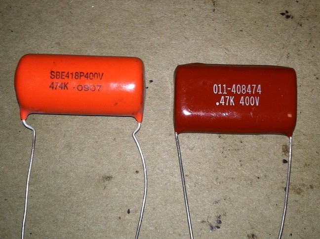

BE_ZERO_BE
- Posts: 662
- First Name: BOB
- Last Name: CASCISA
- Location: POULSBO, WA
Re: Source for High dV/dT capacitors
The difference is the dv/dt rating.
The one on the left has a dv/dt of 700v/uS.
The one on the right has a dv/dt of 1700V/uS.
The one on the left was the standard before the custom capacitors were made.
Respectfully Submitted,
Be_Zero_Be
Be_Zero_Be

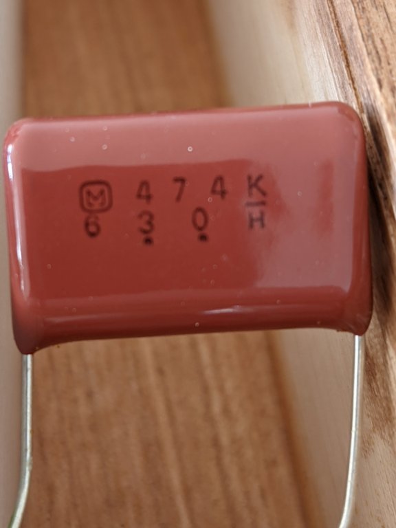

The equation dV/dT is used to express the capability of capacitor's dielectric to withstand high current pulses.
These current pulses naturally occur in all trembler type ignition coils (invented in the late 19th century) because of the nature of the coils internal circuit design.
The Model T Ford ignition coil is a Trembler Coil. Because of these naturally occurring electrically current pulses, when purchasing replacement capacitors the dV/dT capability must be taken into consideration.
When solved, the above equation (dV/dT), is expressed in Volts per Microseconds where "d" is rate of change, "V" is Voltage and "T" is Time.
Capacitors come in varying types of internal construction. If you carefully study a capacitors electrical specifications you will notice some types have high dv/dT ratings and others are lower because their of there intended use in circuit design applications. Capacitors not intended for high current applications usually do not even mention dV/dT specifications. This is usually the case with metalized Mylar capacitors, commonly and mistakenly installed in Model T coils, but well known to work for only a short time.
The original Ford coil capacitors are of the film/foil type internal construction which generally have higher dV/dT ratings because of the type dielectric used. The film is the waxed paper dielectric and the foil is Tin foil, the electrically conductive element.
The two capacitors shown in the photo above were specifically selected or developed (physical size and capability ) to be recommended to Model T Ford parts suppliers to sell for use in Model T Ford ignition coil repair. Many thousands have been installed in Model T coils and are known to work well and will last another 100 years.
There are several commonly available capacitors that will reliably work in the Model T coil, but you have to be careful and know exactly what you are doing. The world is just a little too simple and can be a trap for logical people.
Hope this helps.

All thatr is mentioned above of pro & cons of the two capacitors are correct (and nice to see "The Coilman" is back sharing his knowledge) but one thing is omitted:
The physical difference in geometry:
The left one do not fit right into the void from the original condenser and require some more digging out tar and rearranging the glassplate insulator.
The right one fits just in: And sorry Ron - my workbench is not as clean as yours use to be

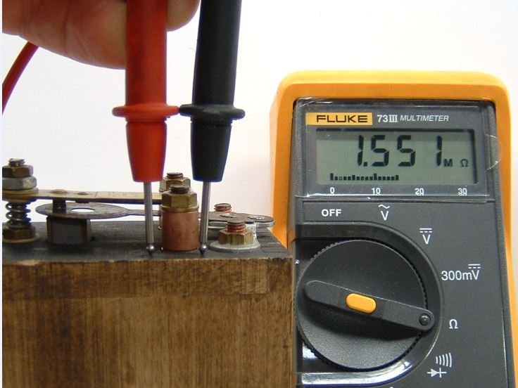

So all four of my "new" coils tested as having bad capacitors on two different ECCTs. That's what motivated me to start this thread. I got four new caps from a generous member of the forum. I opened the coils last weekend, and this is what I found. I unsoldered these capacitors and replaced them with the four I got in the mail, which are the high dV/dT kind. I need to schedule a time with one of our club members who owns an ECCT to readjust them, but I am planning on dropping them in the car this weekend (pending a possible snowstorm) to see how they do.

regarding your caps registering as bad...you did separate the points and block them with card-stock before you measured them, right?
I find it hard to believe that those new caps measured "bad".
that said, unfortunately those coils do not come with the best reputation. Once repaired, do yourself a favor and secure the caps somehow to keep them from vibrating. DON'T use silicone or any other similar material. I would think that some hot glue sufficient to mechanically nail them down would be fine. I'd normally say "use high-slope tar" but who wants to try to source that for less than a cup-full for the job?

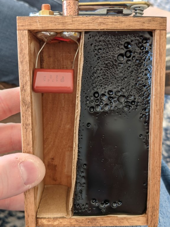

Those Capacitors in Jason's "new" coils are made by Michicon and are metalized Mylar type constructions with a dV/dT rating less than 75 volts/microsecond and are entirely unsuitable for use in a Model T For ignition coil for the reasons I described earlier in this thread.

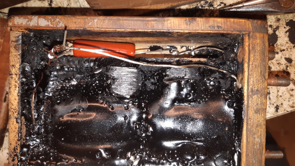

Why not use silicone?
- Posts: 6792
Your garden-variety silicone sealant will outgas, which is mildly corrosive within a confined space. Plus it creates a very difficult situation for the next guy to remove the gunk and then afterwards expect to get solder connections clean enough to flow solder.
- Posts: 8636
Expanding foam can be used to re-pot capacitors.

I concur with Scott, coils can develop leakage paths through the coil core and wire insulation that can appear to be capacitors with poor leakage when tested with the vibrator spring held open against the coil core. Placing a piece of card stock between the coil core and the vibrator spring insulates the vibrator spring from touching the coil core and the source of leakage.regarding your caps registering as bad...you did separate the points and block them with card-stock before you measured them, right?
Another issue I have come across with these type of coils is conductive black paint which resulted in failing the capacitor leakage test limit (5 Meg Ohms).
For these reasons, folks using the ECCT to test capacitors need to be aware of these issues and judge capacitors by capacitor VALUE NOT leakage resistance as per the previous link I posted: https://mtfca.com/phpBB3/viewtopic.php? ... 4&p=173985 Capacitors that measure within acceptable uF range (0.47uF +/- 20% or >0.33uF but <0.68uF) But test "POOR" for leakage are NOT bad and DO NOT need to be replaced.

I use a capacitor test meter. I have not seen any non rebuilt coil over 60 years old that had a good capacitor.
The dozen or so that I rebuilt 5 years ago using the slightly flattened style capacitor still tests good at this time.
New capacitor meters are available at a reasonable price on the internet. I highly recommendto all to get one. Mine was a Christmas present from my son.
