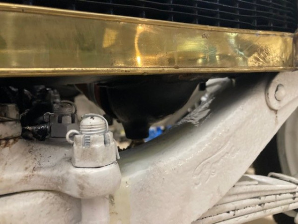

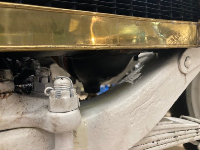

Hi I have a 1915 brass radiator, round tube. It is most definitely leaking somewhere on the right side. Steady drip, drip about a gallon in 3 hours. It might be leaking somewhere else on the left. It isn't the hoses. Will any radiator shop be able to fix this? If not is there a preferred one in Houston, Texas?

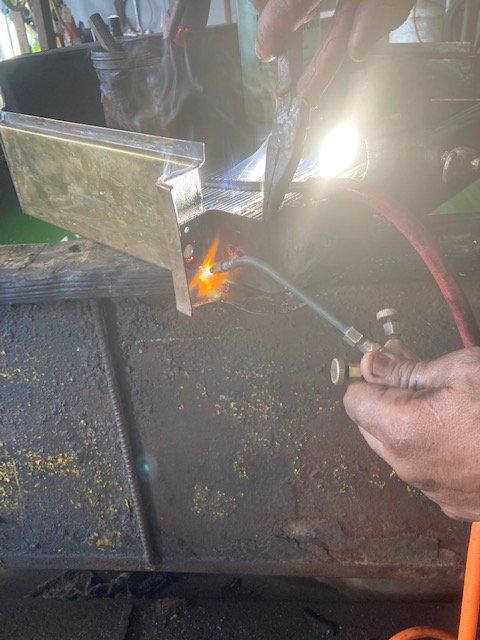

Fondren Radiator fixed it. It had 4 leaks. They had to cut the lower bracket in half to get to one of the leaks then reweld. So far so good.

Figuring out how to get the bracket off to access the leak.
