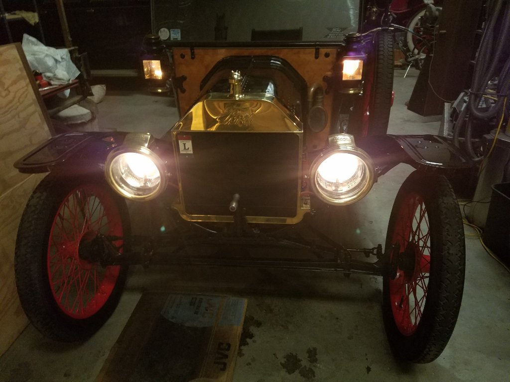

Prestolite yes. Coleman no. It is possible to stay with the carbide cleanly by lining the tank with a plastic bag for that messy residue. For those occasional night trips, I have seen stick on , self contained led lights. Remove when not needed. My self, I put in halogen bulbs, wired thru the rubber line on the original burner base.

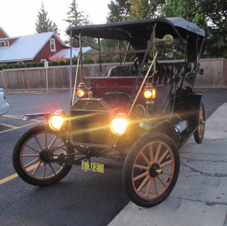

I love my Prest-O-Lite tank. No muss no fuss.

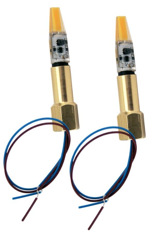

If I were to modernize them I would look into the LED (not halogen) bulbs that screw into place of the original burners.
Bob has them. Snyder's has them.

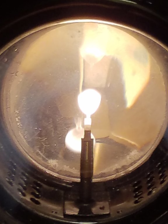

I put in the LED lights in my 1914 and they are OK, but not as bright as you would like them to be. But then again, I have heard the original acetylene lights are not that bright either. It might be nice if someone could measure the brightness difference between the LED lights and the original acetylene lights. What I like about them is they draw almost no power and can be turned on and off easily...and most people would not notice the LED bulb in place of the original burner even it they looked.

The down side of the halogen is a lot of amps needed. I converted to led for a minute. Way too dim. The halogen are blindingly bright.
I make em work. I make sure the battery is topped off & dont run in the dark that much. If I do, I can unplug 1 light.(Christmas light tour) Hate the power drain.

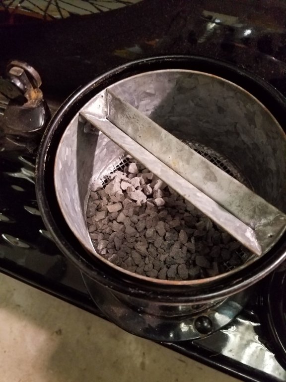

I use the original carbide generator system on my '14. It doesn't make that much of a mess.
