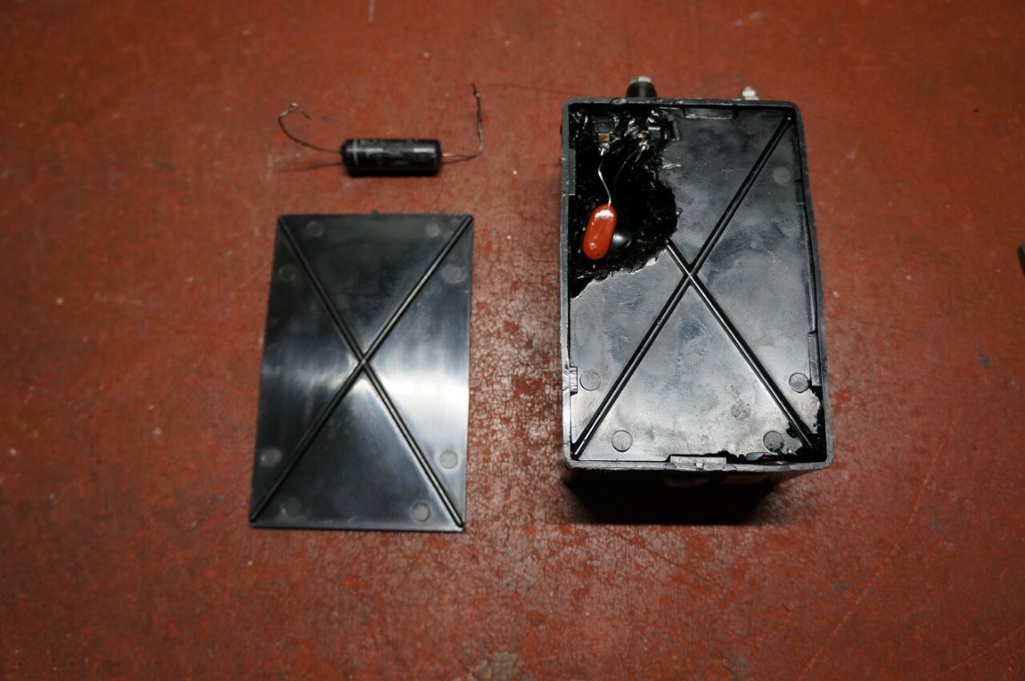

I've just repaired a couple of plastic cased coils - the first I've done. No idea when they were made, but I'm actually very impressed with them. It's a lot easier to change the capacitor since it's smaller and less tar digging is required. Also, the absence of wood breaking, warping, or coming apart makes things easier. The capacitor in the coils I repaired was only 0.1uF at 200V and was a tubular capacitor of "Black Cat" branding. Needless to say, one of them was completely open circuit.
They appear to be wound differently to the wooden coils - I noticed this when setting up for equal firing time; the current builds up at a different rate. Inductance of the primary winding is 2mH, whereas a wooden coil measured 2.6mH. No idea how well they work with a magneto, but certainly for battery operation I don't see any problem with them.

Michael, yes the plastic moulding appears to be identical. It would be interesting to know what kind of capacitors are in the current production.
