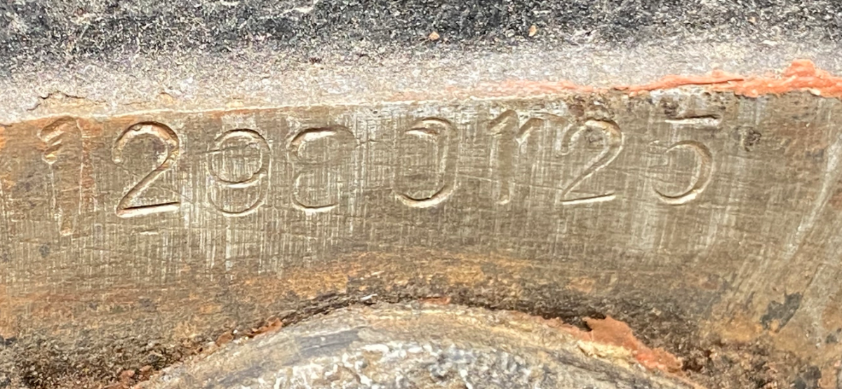

Anyone know how to find out what year my T motor is... 2980125 is the number stamped on the block... it does have a 1 in front of the numbers but to me it looks like it was stamped on later as it is barely imprinted into the block and I have heard that sometimes a mechanic would add a number when working on them back in the day... the T was sold to me as a 1915 with a 1919 motor but going through the T and reading a lot of posts here ( best place in the world for T info by the way.... thanks guys) I'm thinking that I have a 24 frame with a after market brass radiator... any help would be greatly appreciated... as far as I can find out this truck was put together by Lenard B Smith and Mike Fortunato of Townsend Massachusetts... unfortunately Mr. Smith has passed away (some on here may remember him) but I have talked with Mr. Fortunato and sent him some pictures of my T and he said it looks like one of theirs that they had built and sold ... I've also been in touch with Mr. Smith's son Kevin but no one has any records .... and the man that bought this T from them has passed on also with no real records... all paper work has the wrong numbers nothing's matching up and driving me nuts but I'm not gonna stop loving my T... just want to know all I can about it...thanks in advance guys

March 1919 number.

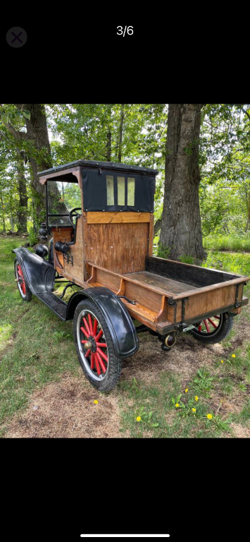

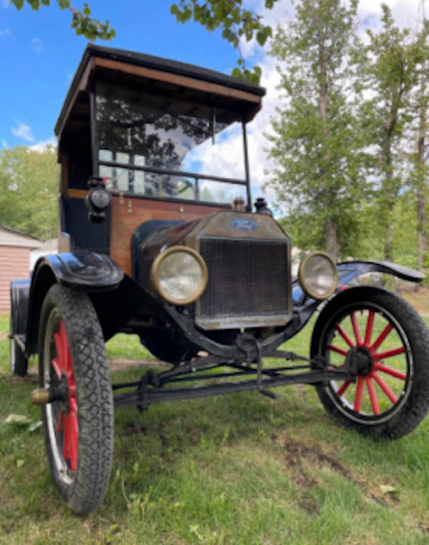

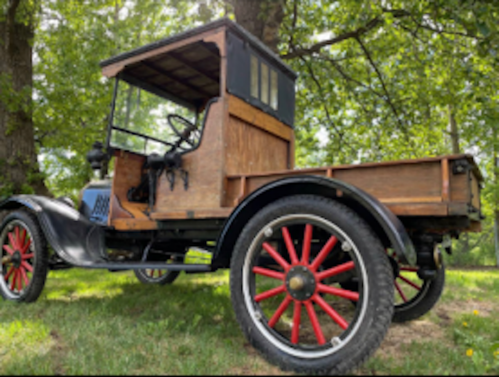

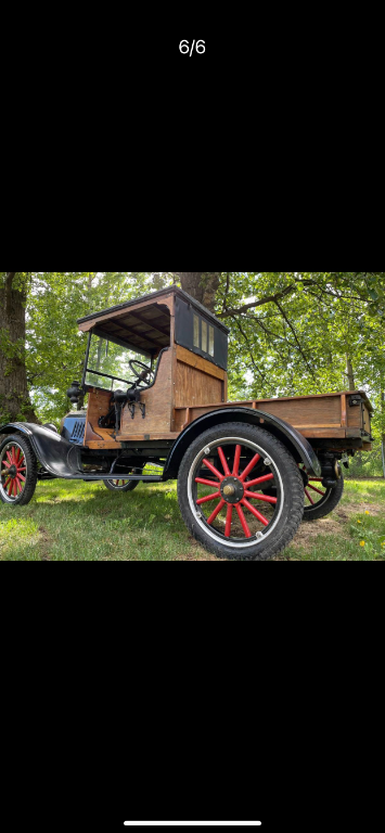

Post by Edy » Mon Oct 11, 2021 10:08 pm

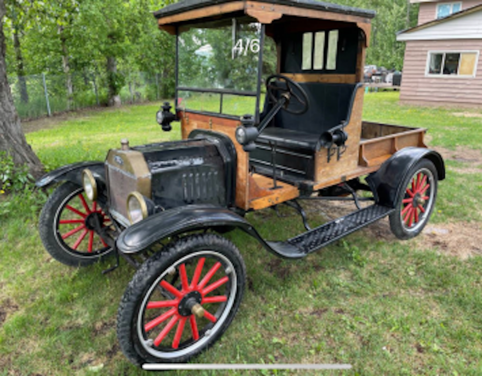

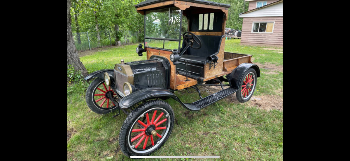

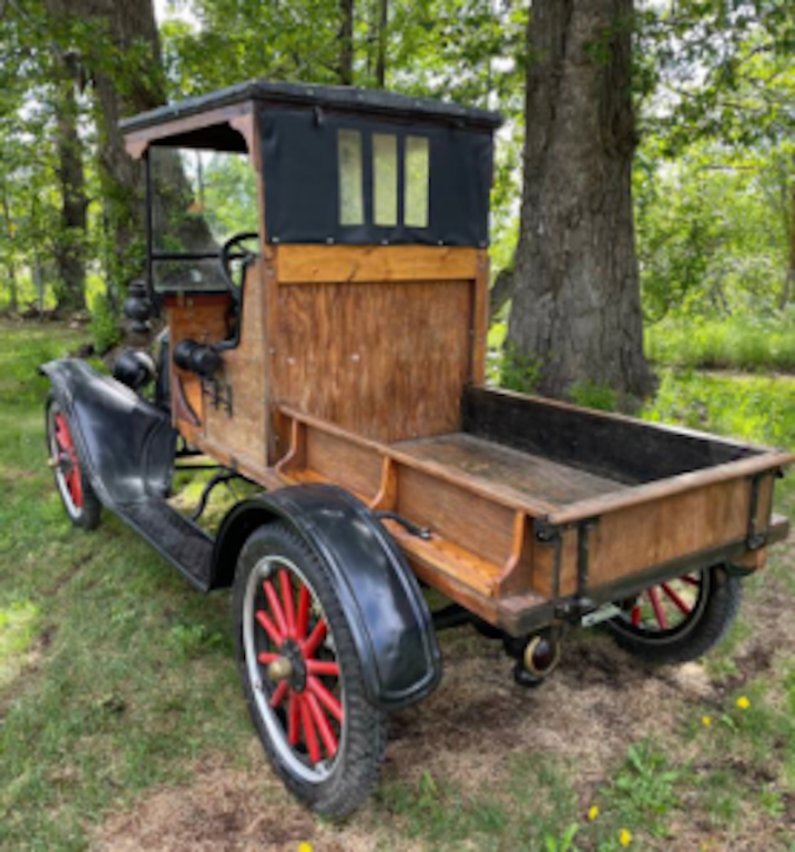

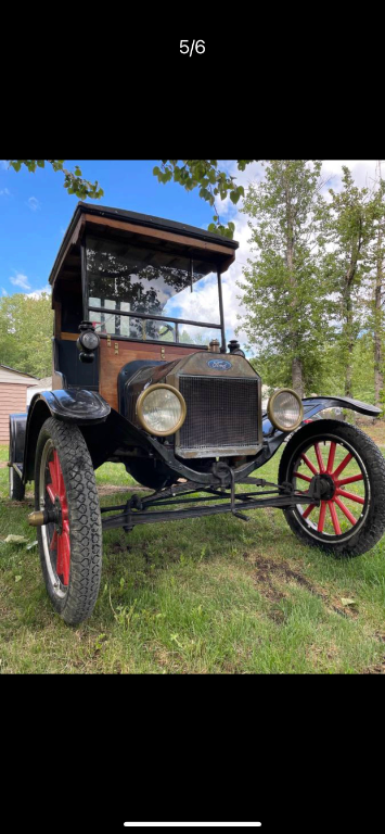

Dom here we go my first attempt to post pictures on this forum

Re: Engine identification help needed
Post by ThreePedalTapDancer » Mon Oct 11, 2021 10:09 pm
That looks like a fun T. I like the wood cab and bed.

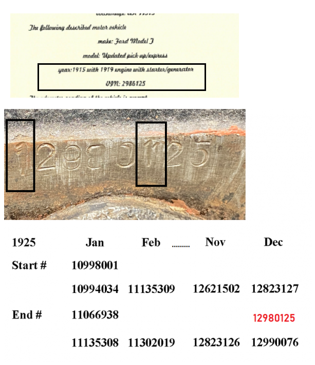

Post by Edy » Mon Oct 11, 2021 10:12 pm
Posts: 6581

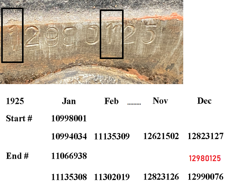

Post by TRDxB2 » Tue Oct 12, 2021 1:41 am

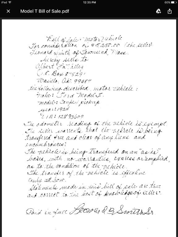

Looks like a dull #1 bouncing on a second strike. I'd say the number is 12980125 without question. A single cylinder valve cover is from 1921-27 and can also be used to confirm the date. The hand written Bill of Sale shows a different 1924 number 12893609
These indicate that the front axle is 1919+and the front spring clip is 1921-25

Post by Wayne Sheldon » Tue Oct 12, 2021 2:47 am
The truck is almost certainly a put-together mix of pieces. What is sometimes referred to as a "parts salad". Nothing wrong with that. Model T Fords lent themselves to widely different and changing needs over many decades.
The radiator, hood and hood former all appear to be 1915 or 1916. Fenders are 1917 or later. Most of the chassis could be anything in the 1919 to 1925 eras. The running board brackets are 1920 or later. The wooden body looks really good, however is not done quite how original era truck bodies were usually done.
Somebody that really knows model Ts should be able to look over the engine block and narrow it down to about two years time-frame. Look for a casting date behind the serial number embossment. Ford stopped using those on USA blocks about 1920 or '21. Generator mounting on the right side front or not? (That change was made in 1919.) Valve side cover a single long panel? Or two short panels? There was a crossover time when both were used around 1921 and 1922. Minor casting detail changes around 1923, followed by the long run of 1923 through 1925 model year blocks. Significant changes in the block for 1926 and in 1927.
Looks like a good model T to have a lot of fun with!
