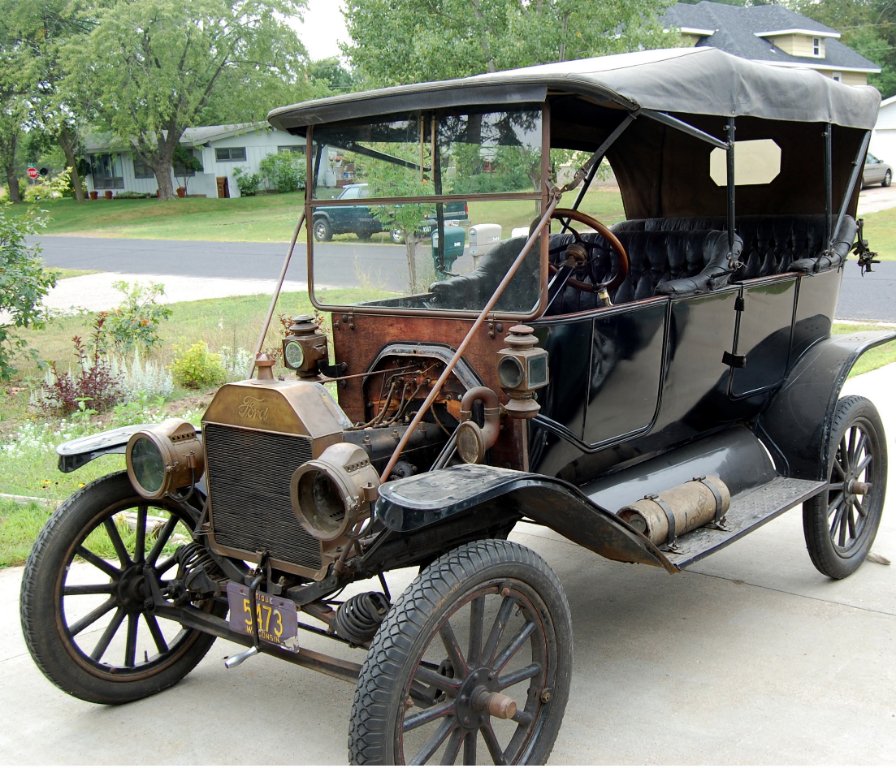

In the current issue of the Vintage Ford, there is a picture of a 1914 touring with matching numbers! Impossible. If that is true, then someone has stamped a reproduction plate, and placed it on the firewall. Any further information on this car would be welcome. This photo is on page 1.

Dear Original Smith,
I am the owner of this car. Please forgive me for my poor language when I said, "matching numbers." I just meant to state that the engine number and casting date are both 1914. That is all. Nothing more. Nothing less. In hindsight, I shouldn't have said anything in this regard. I just thought folks might enjoy the photo. In no way, shape, or form did I intend to mislead anybody with my poor choice of words. I hope you can find it in your heart to forgive me.
Sincerely,
Erik Larson
Sincerely,
Erik Larson

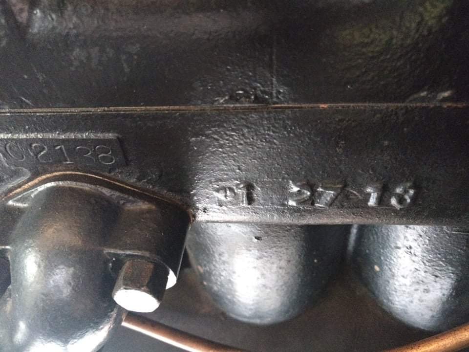

The car that was used to recently replicate data plates in my latest project is a Canadian 1914 that has an ORIGINAL data plate that MATCHES the motor. This car has been in the same family since NEW. The grandson of the original owner has all the documentation of the car including the original bill of sale. Note that it still has it's original WOOD coil box. Something that didn't occur in the USA. This car hasn't been messed with. It also has an accessory front bumper and that, is on the original bill of sale as a dealer added option at the request of the owner originally.
It seems that Canadian cars follow a different pattern than American cars.
This plate was supposedly only used on 1912 USA cars but was used for a longer period of time in Canada.
Here's the proof:
Here's the proof:
Last edited by Darren J Wallace on Mon Oct 25, 2021 12:36 pm, edited 1 time in total.

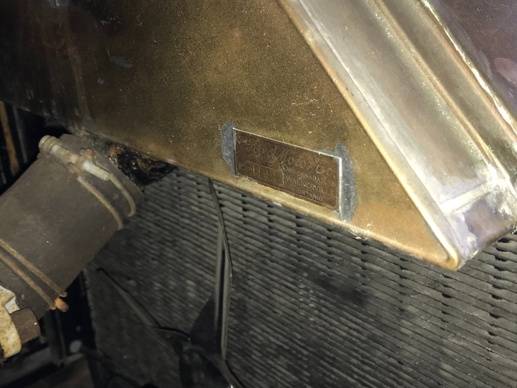

Darren J Wallace
- Posts: 367
- First Name: Darren
- Last Name: Wallace
Re: Matching Numbers?
Another issue possibly for another thread; Why bother issuing serial numbers on the radiators? Here's mine:
