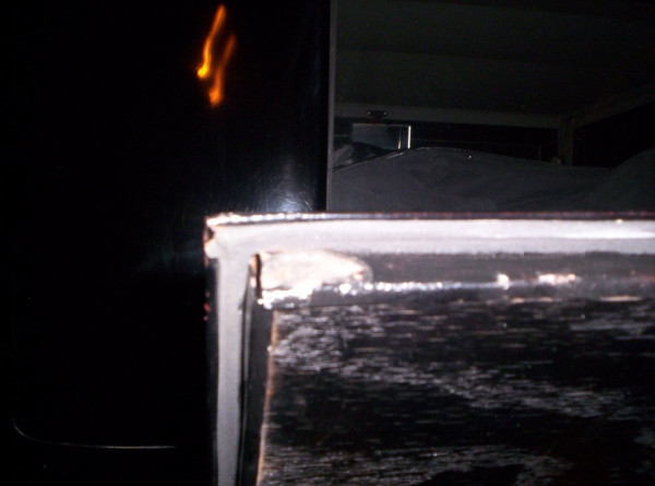

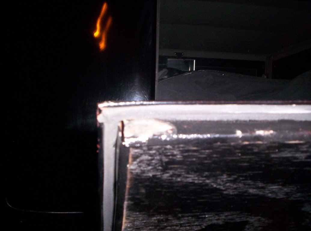

I can't remember what size weather strip I got other than I had to slice it in half to fit, took the lid off, ran it all around and hasn't leaked since.
