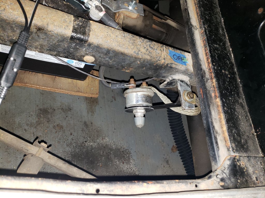

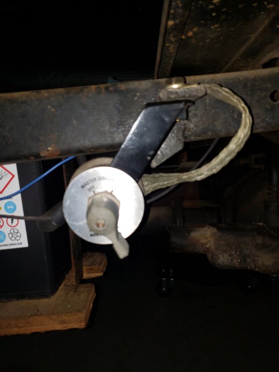

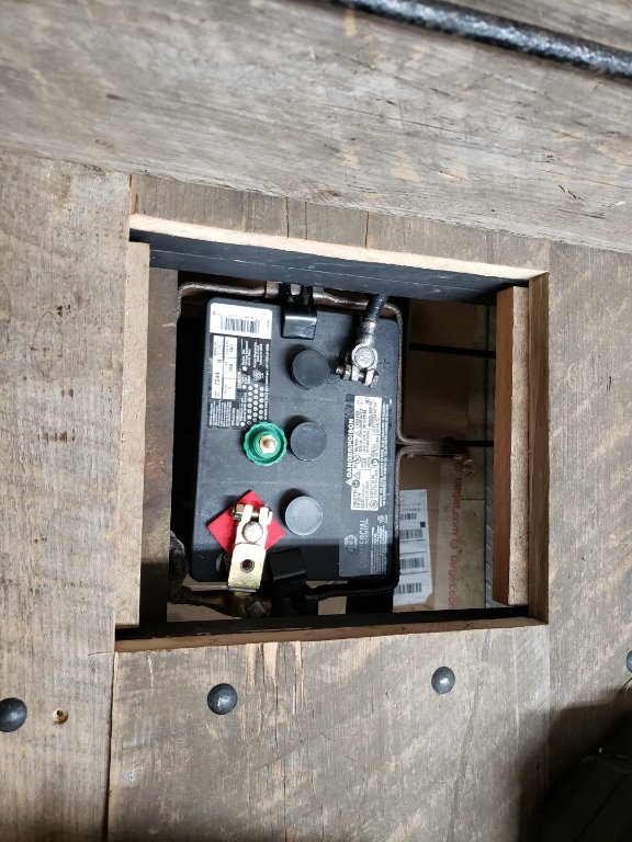

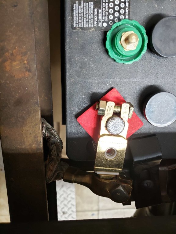

Just curious where folks locate their battery cuttoff. Was hoping to see some ideas to avoid crawling under the car to switch the battery feed off. Right now I have mine in the back corner of my turtle box, but I'm going to put on a wood truck bed. Thanks.

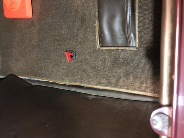

Location on my 26 Touring.
Mikey1968
Posts: 233
Joined: Fri Mar 01, 2019 9:08 am
First Name: Michael
Last Name: Jewell
Location: Northern Virginia
Re: Where to locate a battery cutoff
Post by Mikey1968 » Wed Nov 24, 2021 2:35 pm
I forgot to mention I can reach through the rear wheel well and easily switch it on and off. Switch the ground.....
