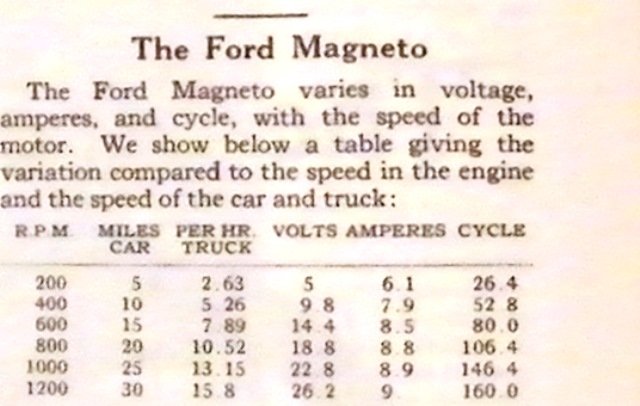

Post by TXGOAT2 » Mon Nov 15, 2021 9:31 am
I would disconnect the magneto and connect an AC voltmeter between the magneto post and engine ground. Place the voltmeter where you can observe it while driving the car on battery. Make sure your connections are secure. The magneto should provide from around 6 or 7 volts at very low engine speeds up to 25 to 30 volts at higher engine speeds. The meter should show voltage changes with engine speed changes, but voltage should not change at any steady engine speed, and it should never go to zero with the engine running. Use the 0 to 50 volt scale on the meter. A cheap parts store multimeter is fine for this job.

Since the car runs fine on BAT but not MAG, logically the problem is with the the MAGNETO portion of the circuit (see wiring diagram for magneto to switch). MAG & BAT use the same coils, plug wires etc. so everything from the switch to the motor potion of the circuit is the same for both. So one can assume the problem wouldn't be expected to be in that end of the circuit. Yes there is a contact difference in the switch that chooses the voltage source MAG or BAT so it is from there back to the source that the problem is expected to exist.
Again if it ran rough before the Long Beach T guys recharged it and then it ran perfectly afterwards they recharged your magneto and now after some time it runs rough again that would suggest the problem is with the magneto. So I would focus your efforts on the suggested Magneto checks above.
Here is a simple test for magneto voltage output.
MAGNETO_TEST-760271.pdf
(93.06 KiB) Downloaded 86 times
