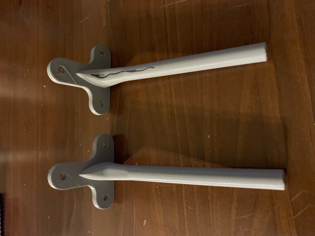

I've been researching and planning and making the necessary pieces for my delivery car. One item was the fender irons. I have drawn these unique fender irons up and 3D printed them to exact dimensions. I have now finally secured a foundry that will cast these for me. I was only going to have one set cast, but a forum member had contacted me and asked me about rear fender irons because he too is doing a delivery car, I told him where I was in the project. The foundry I'm working with is willing to do a small run. If anyone else would like a pair please contact me via email or call to discuss. The run is queued in December so I will need to know really soon if interested.

Yes that's true if you don't adjust for shrinkage. I 3D printed several molds to adjust for the right shrinkage for the castings as per the foundry.

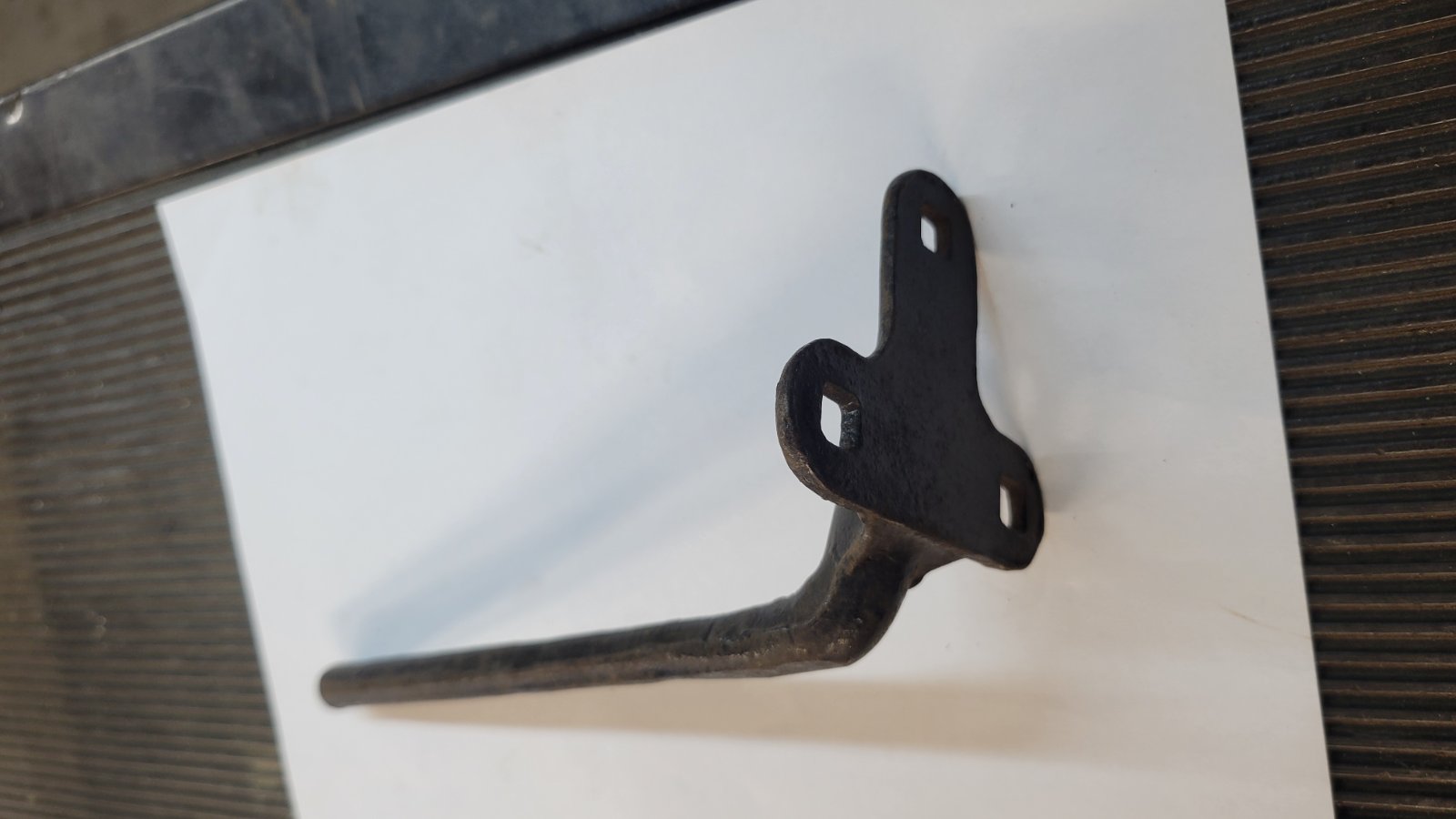

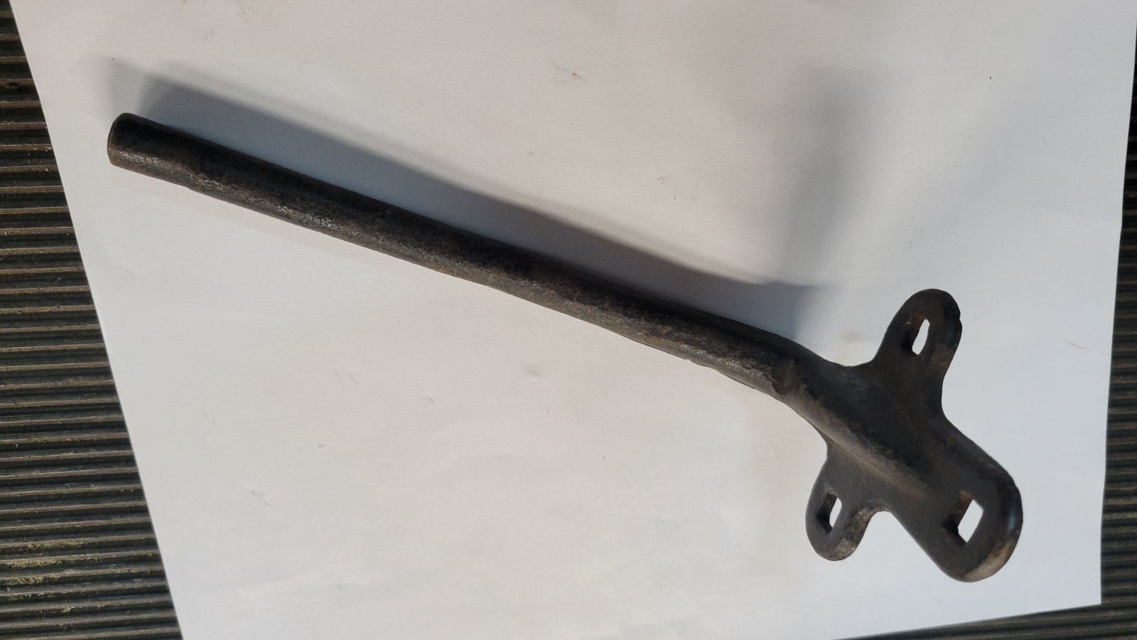

Post by KWTownsend » Wed Mar 27, 2024 4:36 pm
Mike,
Is this a delivery car rear fender bracket?
Keith

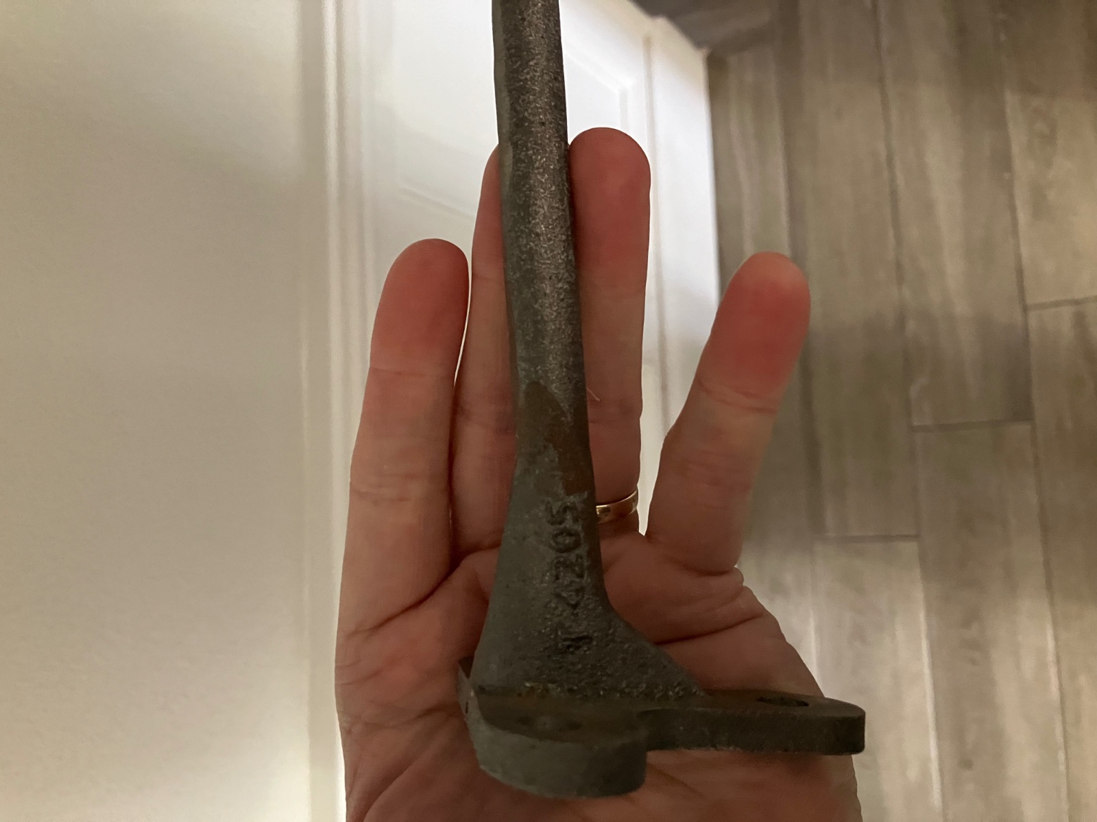

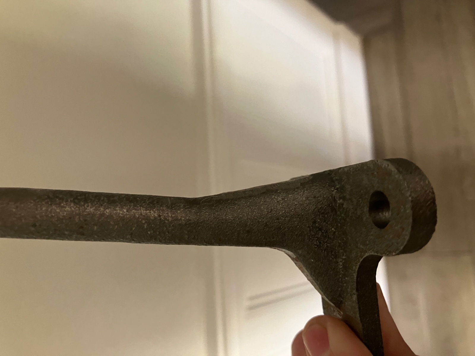

Tbird
Posts: 1265
Last Name: Bird
Location: Goshen IN
Re: Delivery Car Fender Irons
Post by Tbird » Wed Mar 27, 2024 5:32 pm
Keith, unfortunately it is not. Those are the standard 13 fender irons that someone has bent the mounting pad up. On the delivery car irons the iron towards the bottom of the pad. Before making my own I thought of modifying 13 irons, but just too much work.
Here are the ones I had casted.
