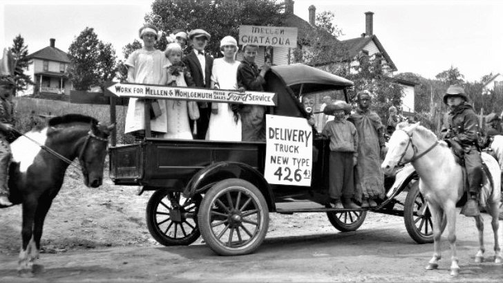

Here is a picture of my 25 roadster pick up that was taken at the July 4th 1925 parade in Melling WI.

Great photo! The horses look worried though...
“our day’s are numbered”

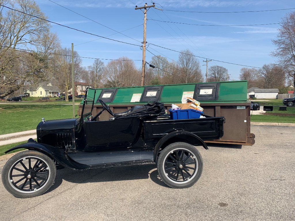

Scott: Why not post a photo of your '25 pickup as it appears now?

Here is a more recent picture, from back in the summer, hauling recycles to the bin.

Outstanding! Thanks for posting, very nice!

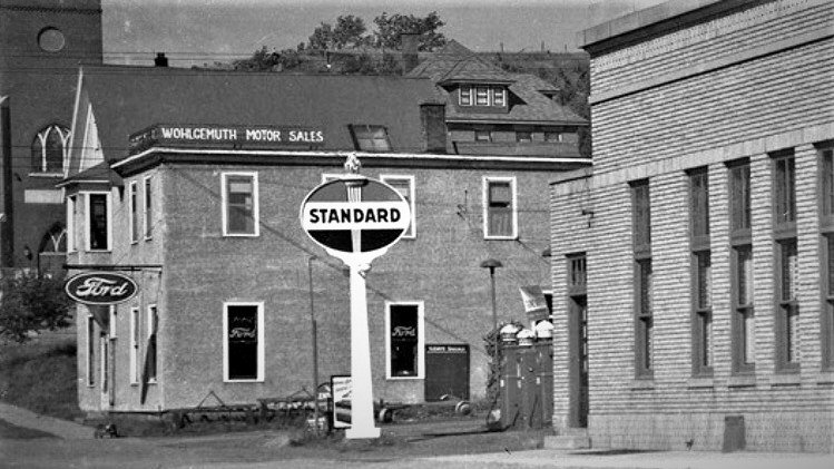

I also have a picture of the dealership where it was sold.
