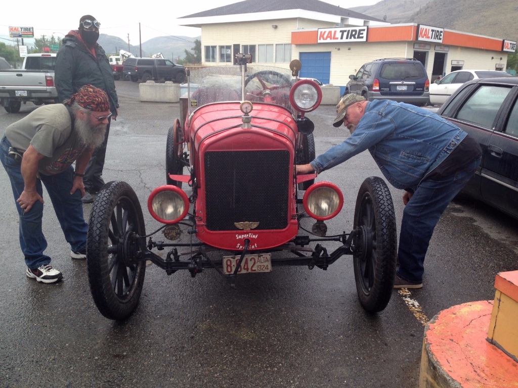

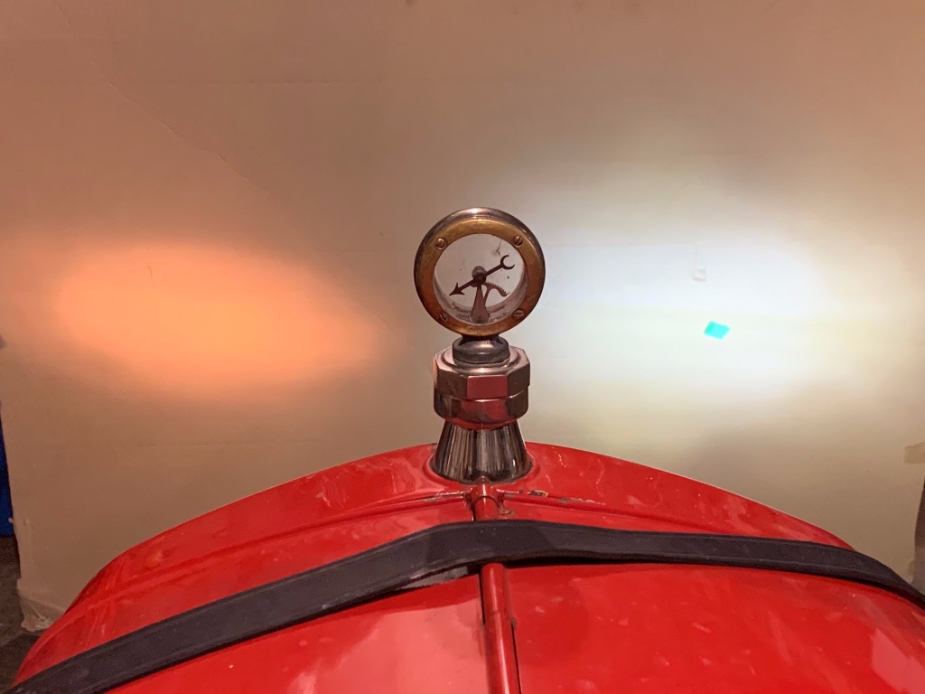

On the subject of LED bulbs, I run them on my '24 Speedster with mixed feelings... on the pro side, they are considerably brighter than the previous filament bulbs and of course draw less power. As this car is often driven after dark, occasionally on the highway and frequently at higher that typical T speeds, the pros win out. The two negatives are firstly the colour (too white for my liking and I don't recall any colour-temperature choices at the time), and the 'Dim' setting biases the beam to the right, rather than down. I assume this is a result of the base pins being indexed 90° off where they ought to be.
Photos below: Incandescent vs LED light bulbs shining on brown cardboard; Speedster lighting... the driving light is a 6-volt H6006 halogen sealed beam in a T headlamp bucket, with both filaments wired to come on when the T headlamp switch is on Bright. I've switched around the headlamp wires Bright vs Dim at the socket, therefore Dim on the switch is Bright on the bulb (with driving light off) and Bright on the switch is Dim on the bulb (thus biased to the right) plus High & Low on the driving light.

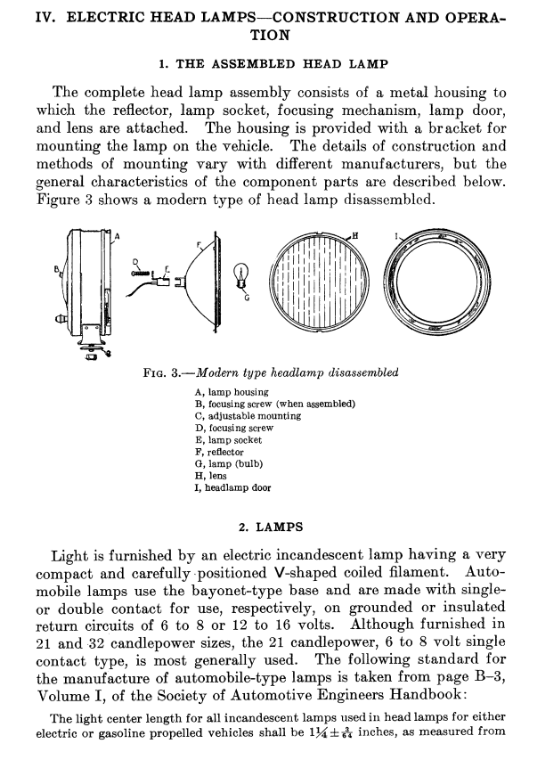

Just to further the history behind all this, to a very limited extent, it's perhaps of some interest that much of the work behind eventual legislation (at least in the U.S.) was carried out by members of the Illuminating Engineering Society (IES) and the Society of Automobile Engineers (now the Society of Automotive Engineers or SAE).
It is clear, in reading early journals of these two organisations, that much research and experimentation around vehicle lighting was carried out in the 1910's particularly, and to a lesser extent in the 1920's. They were not blessed with the accurate equipment we have today, nor did they have the more universal standards we have now and as such a fair bit of work went into developing means of measurement as well as actually on the [head]lamps themselves.
Colour/temperature of light was understood but was a developing field and (as I read it) reasonable proposals for standardisation were only coming up in the mid-1910's, and means of measuring intensity were many and varied - and not especially rigorous in some cases. Indeed the early determination of an individual lamp intensity (measured in candlepower) simply relied upon human perception of that lamp casting against a 'standard' lamp.
In addition to these hindrances it's apparent that different States handled the 'issue' of vehicle lighting quite differently and although my knowledge of U.S. history is fairly limited I understand that it's only when the Bureau of Standards delivered their 1925 circular that there was a common law or standard to follow. No doubt that came about through the extensive efforts of members of the IES and SAE in different States working together via their societal journals. In particular the IES 'Transactions' are, er, illuminating; the following is an example of 1918 from New York:
This page was a random choice out of many, it's an extremely condensed summary of that particular approach to vehicle lighting. For a more detailed example of the attempt to iterate towards a common standard you could read the 1919 Report of the 1916-1917 Committee on Automobile Headlamps here (downsampled to fit here and with thanks to the University of Toronto and the Internet Archive):
ies_1919_rpt_16-17_committee_headlamps75.pdf
(7.42 MiB) Downloaded 87 times

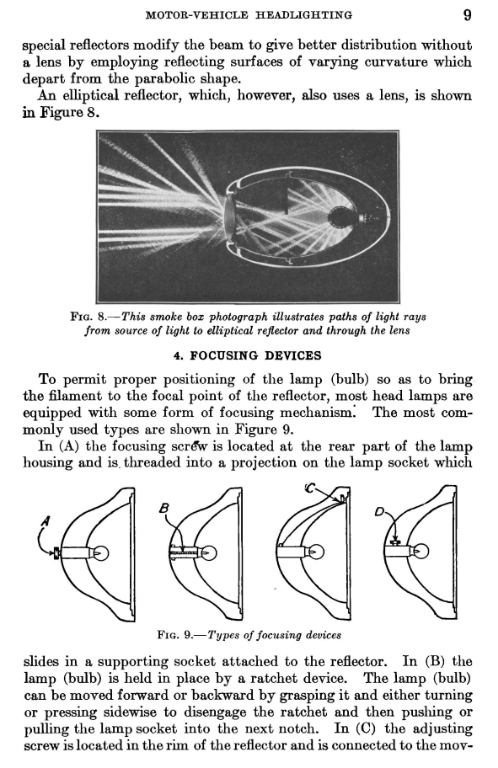

To provide some further information on focusing; from 1921 here's a useful IES paper from Mr Grondahl on headlamp adjustment with regard to glare:
Finally, while I don't know for sure how different jurisdictions handle the assessment of old vehicles, in this country at least such vehicles are (generally) measured against the standards of the day. Thus they cannot be expected to perform as well as a modern vehicle, and will not be failed as a result. To that end I believe it's useful to have a working knowledge of these early standards, particularly if faced with an official who is oblivious...
